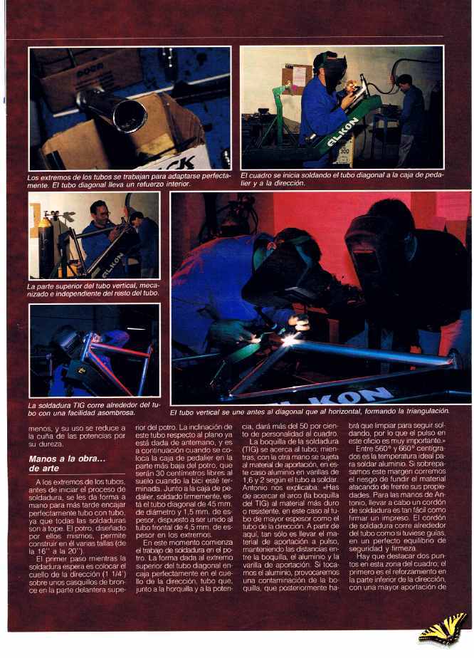

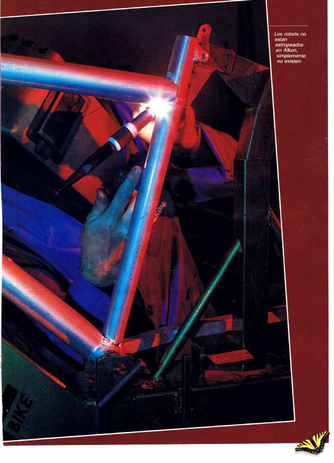

How were they made:

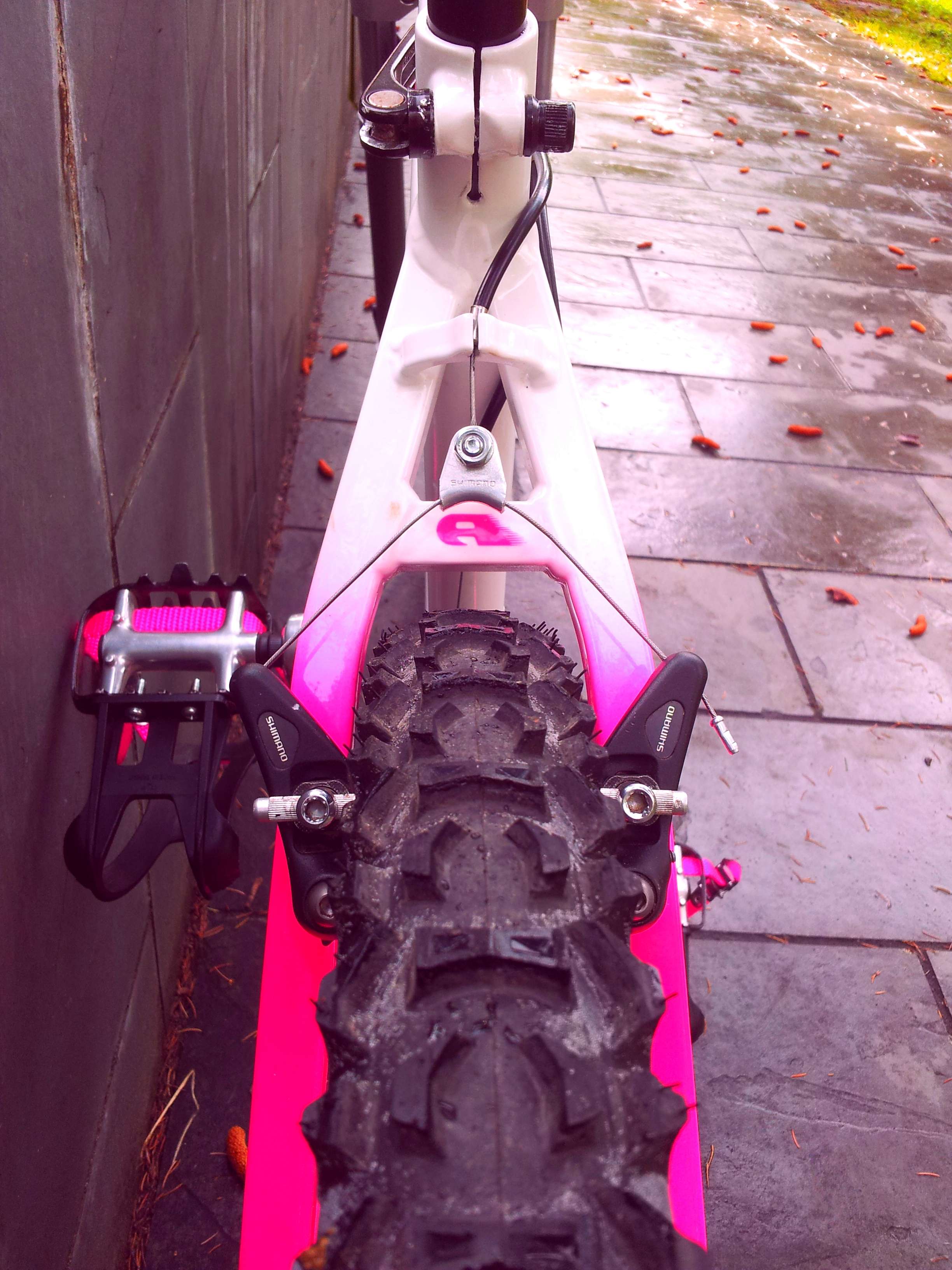

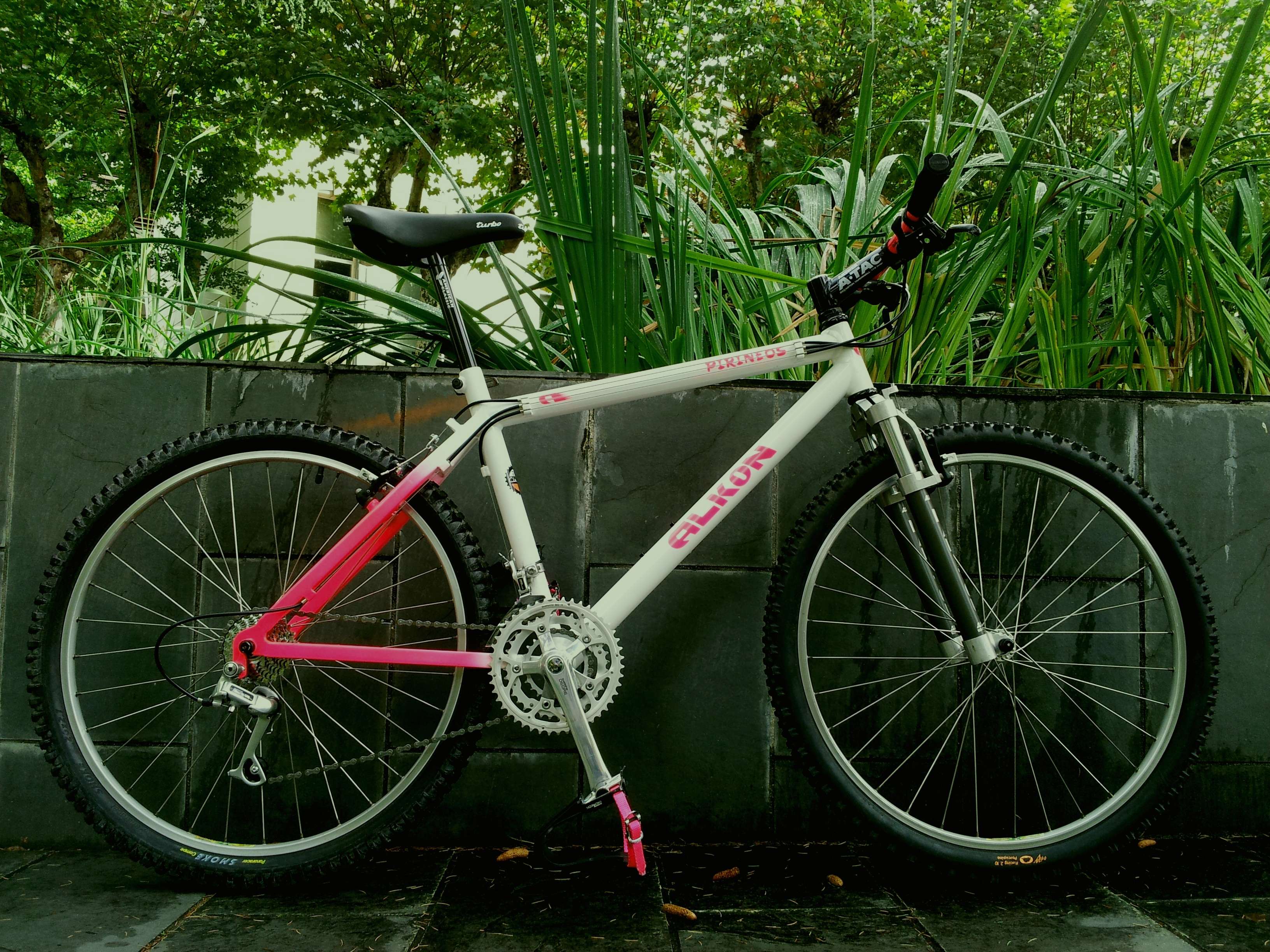

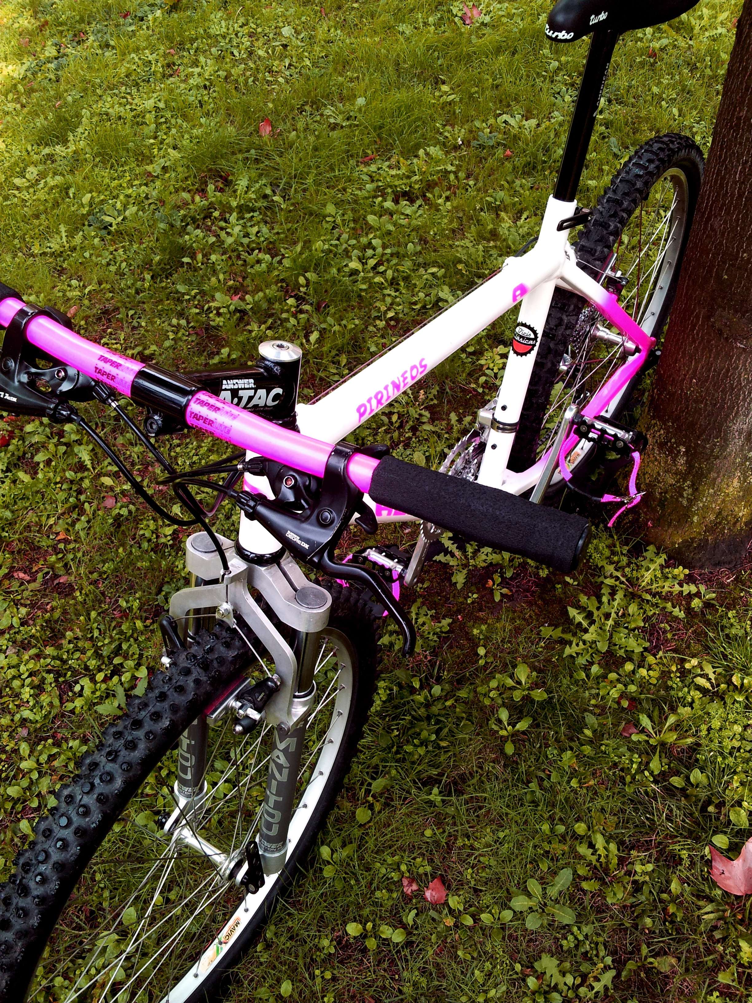

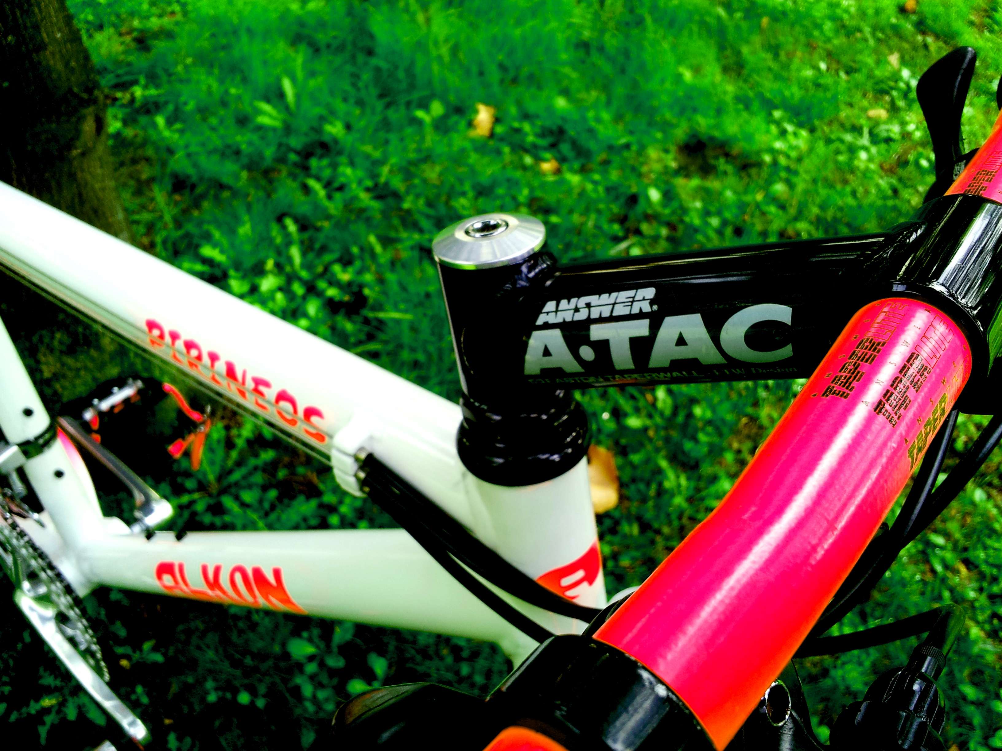

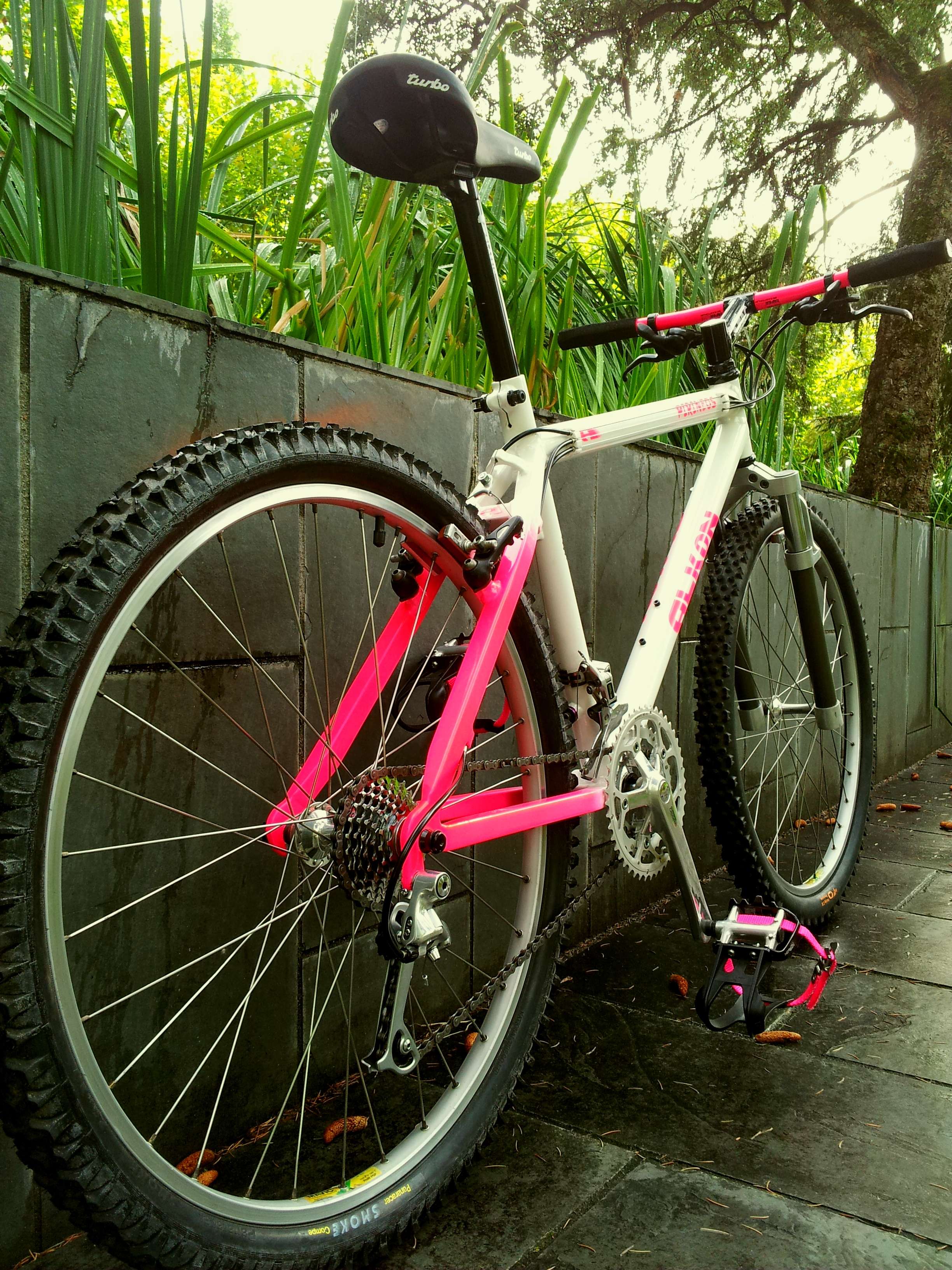

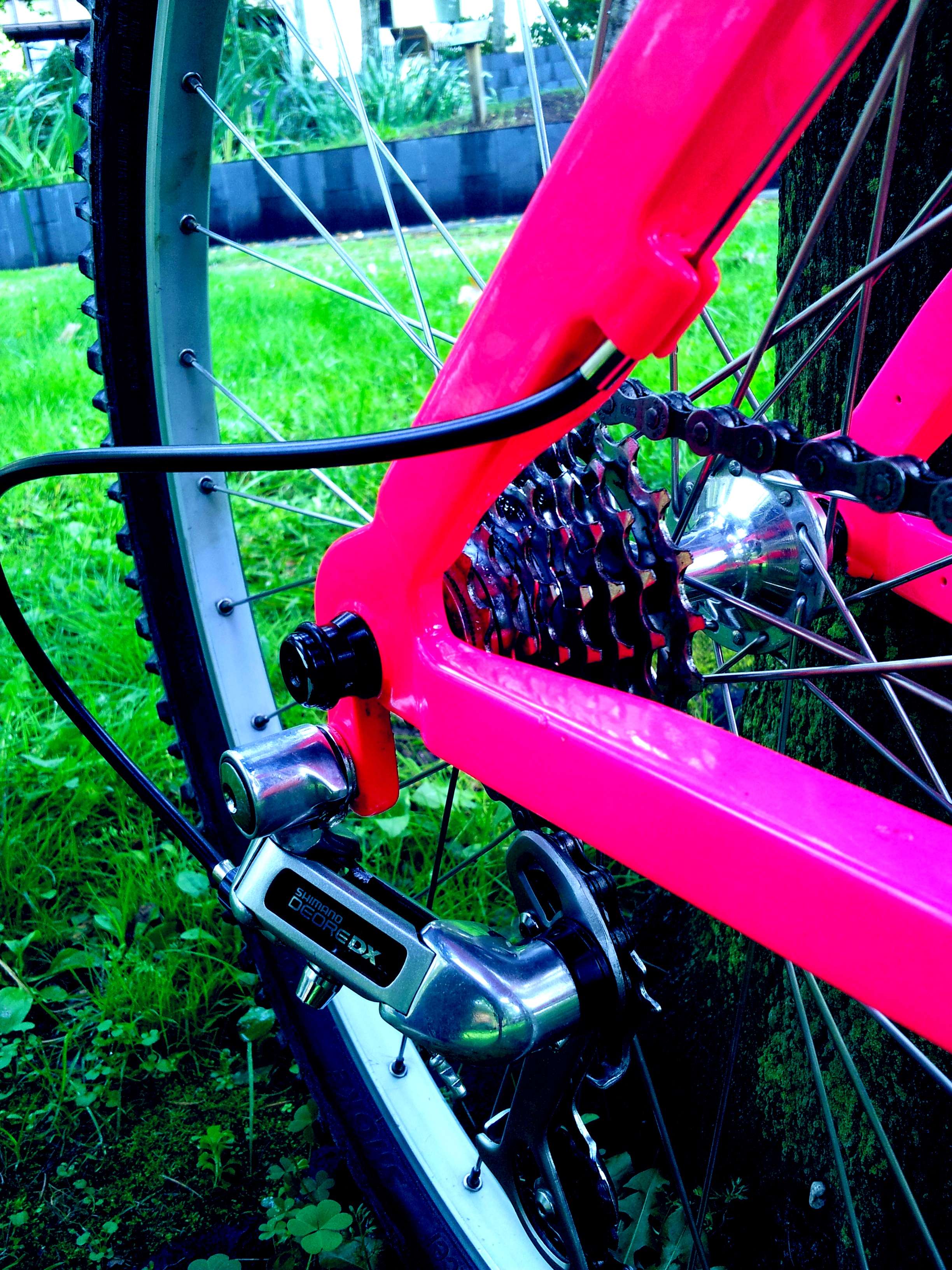

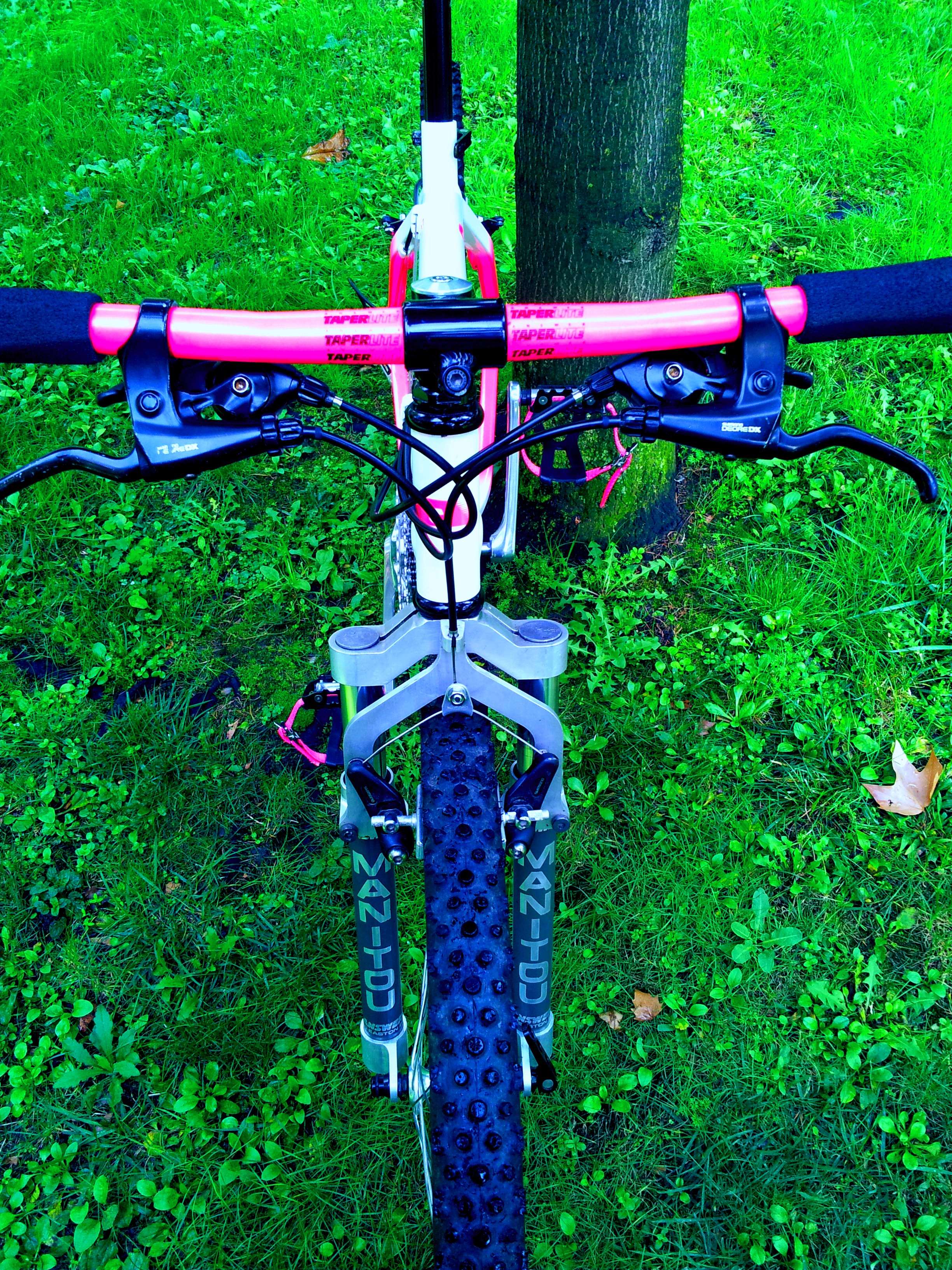

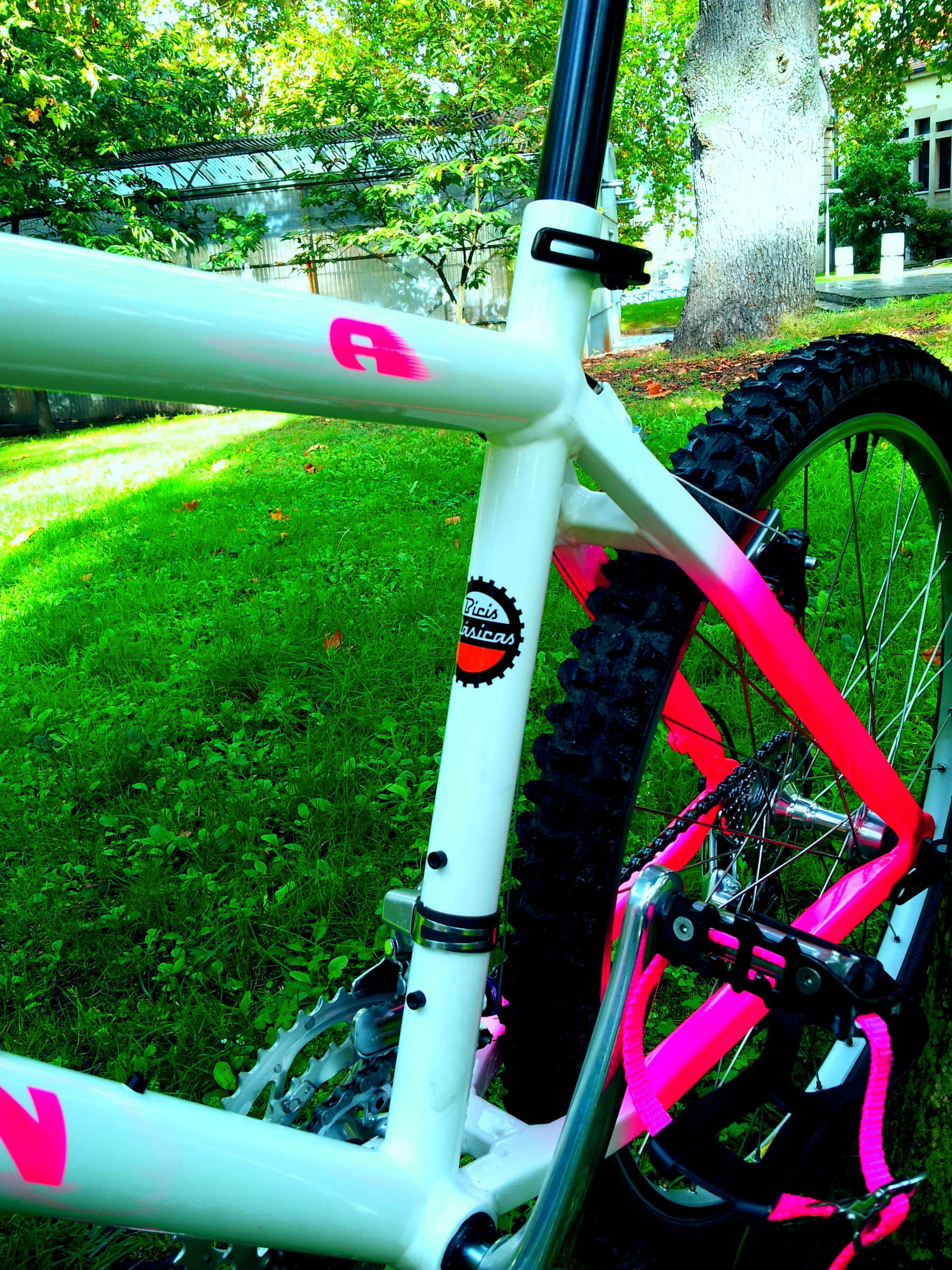

So, here´s mine:
Frame: Alkon Pirineos
Fork: Manitou I
Headset: Tioga Avenger
Stem: Answer A-Tac
Handlebar: Answer Taper Lite
Grips: Grab On
Brakes: Shimano Deore XT
Brake Pads: Scott Matthauser
Brake Cables: Jagwire
Cantilever cable hangers: Shimano
Brake Levers: Shimano Deore DX M075
Shifters: Shimano Deore DX M075
Front Derailleur: Shimano Deore DX M650
Rear Derailleur: Shimano Deore DX M650
Derailleur Cables: Jagwire
Cassette: Shimano HG-70
Chain: Shimano UG
Cranks: Shimano Deore DX MT-60
Crank Bolts: Deore DX MT-60
Chainrings: Deore DX MT-60
Chainring bolts: Deore DX MT-60
Bottom Bracket: Shimano UN-70
Pedals: Shimano Deore DX M650 / Tioga Power Clips / Specialized Straps
Hub Skewers: Ringlé holey
Rims: Mavic M-231
Hubs: Shimano Deore DX M650
Nipples: Brass
Spokes: DT
Tyres: Onza Porcupine F / Panaracer Smoke R
Tubes: Michelin
Saddle: Selle Italia Turbo
Seatpost: American Classic

That is stunning! Top job mate.

Wow! Does look a lot like a Klein from some angles, especially the one in the magazine with rigid forks :wink:

Superb. Is it all NOS!?
Well done its stunning. Great catalogue scans as well. They should go on the archive section.
