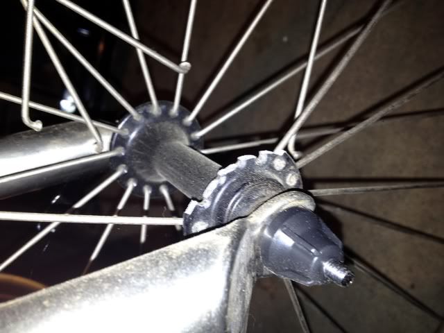

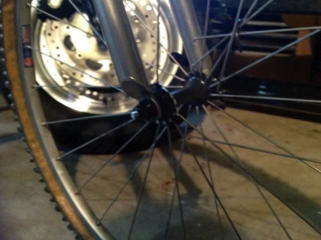

20 + years and more than that number of pounds later something had to give ...
Too many pounds and landed a bit too hard...
I'll be looking for a replacement. If the hub flange diameter is the same as that AC hub, I'll rebuild it with the same rim and Ti spokes using a Deore XT instead, otherwise I'll be looking for an American Classic again.[/img]

A textbook example of why radial lacing is dangerous on mtb's

Felt like I had taco'ed the wheel and broken some spokes. Luckily the walk back home was only a bit over 2 miles.

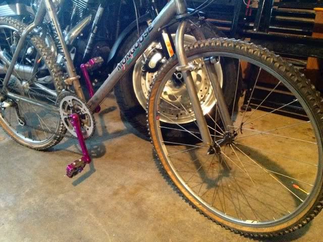

Suntour XCPro derailleurs and shifters, Grafton Speedstix and SpeedTraps, One-Off fork, titanium cogset (can't remember who made that), Ti bolts, bars, bar ends, spokes and anywhere else it could be put.
I think I've posted these in another thread but here are a few pics
