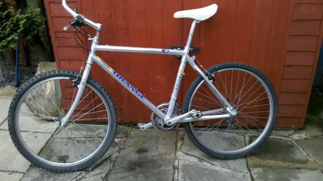

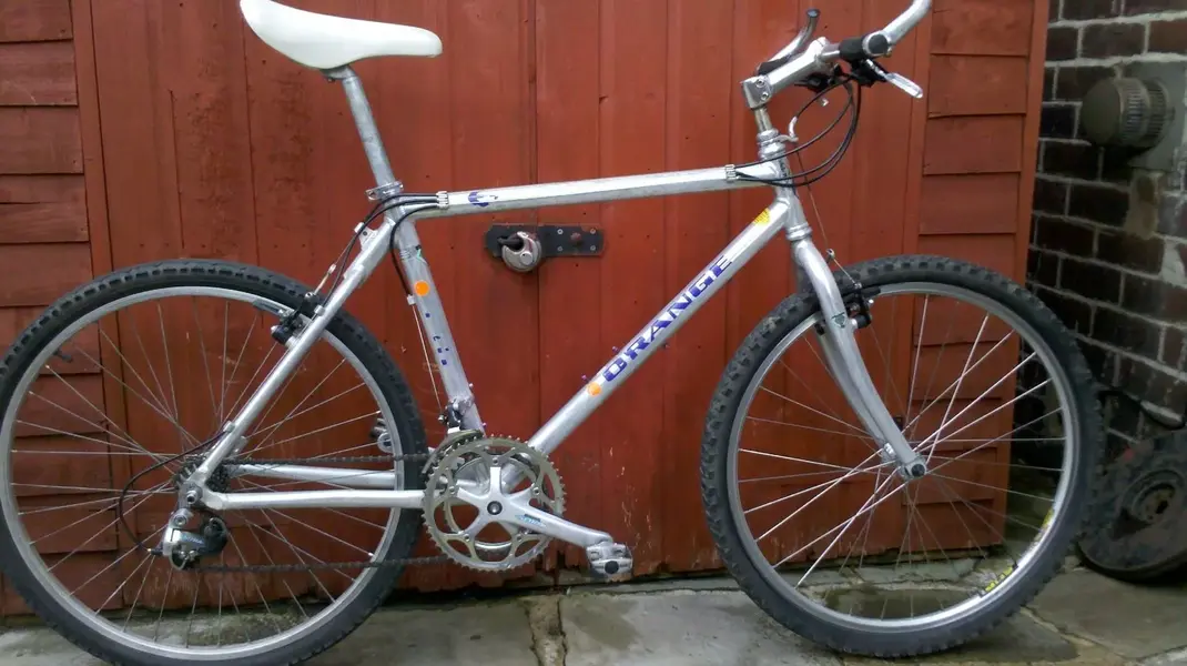

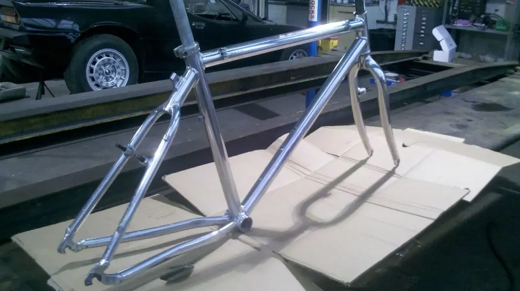

Got some pics.
PostPosted: Mon Apr 23, 2012 12:21 pm
retrobike rider
retrobike rider
Joined: Mon Jul 18, 2011 6:12 pm
Posts: 1355
Location: Leeds
More

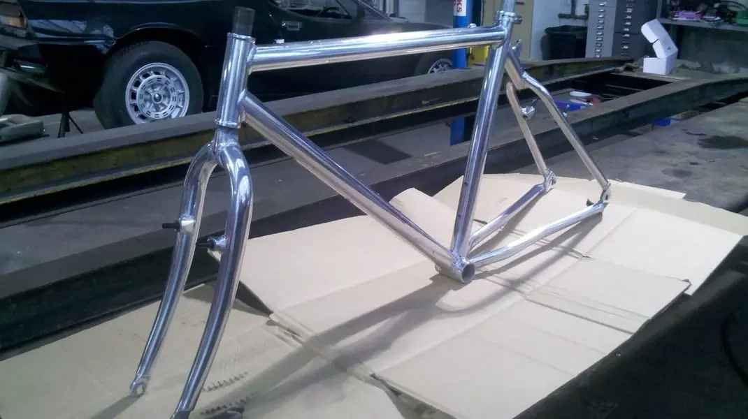

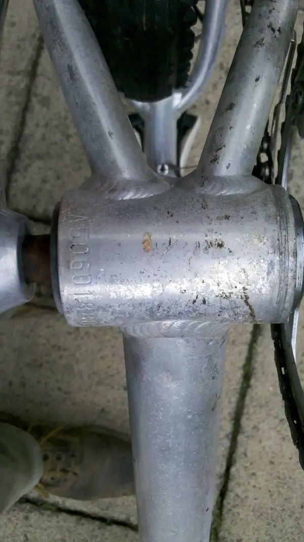

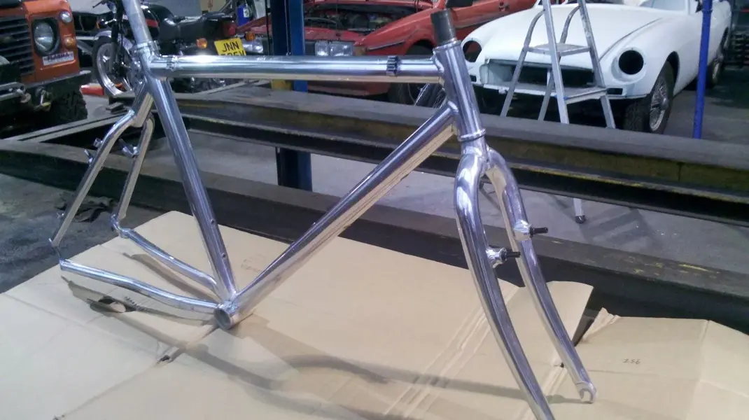

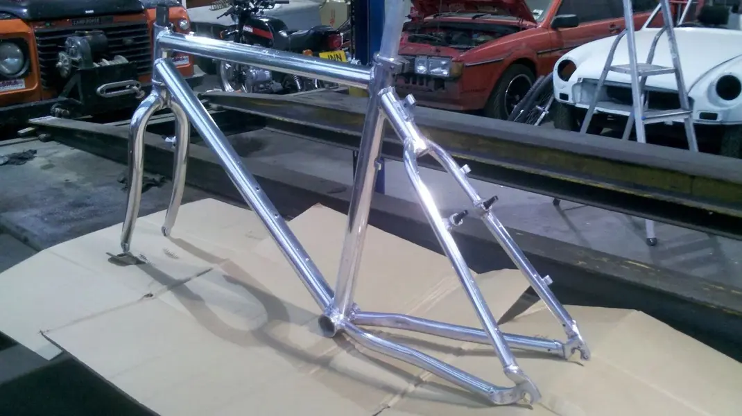

Well I've taken it apart and given it a bit of a scrub and found this :D

good start 8)
Are you going for new decals too?

Yes but that's low on the list at the moment, Need a headset 1st , would still like to use the RC36's as it's easier on my joints, got to decide whether to strip cranks n wheels off the MF or get another set, if I go down the RC36 route I may fit a BB7 front brake which means getting a disc front wheel/hub, (using a BB7 means I can keep the combined lever/shifter combination on it), need a 250/260 1" steerer and shim for the RC36's though, it seems like 1" aheadsets are still available so no worries there, would also need a 1" aheadset stem , I've got an 8 speed XT rear mech so no probs there and it came with a brand new boxed 8 speed cassette (11/30 though I would prefer an 11/34). All being well you'll see me riding a retro again later this year instead of hiding my Stumpy out of shot on the rides.
Matthew
