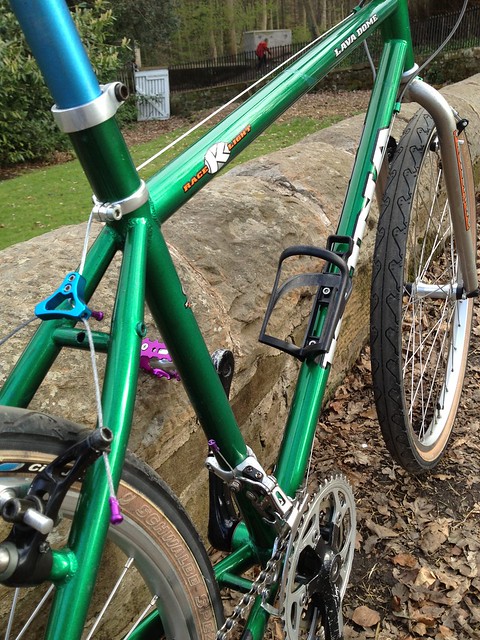

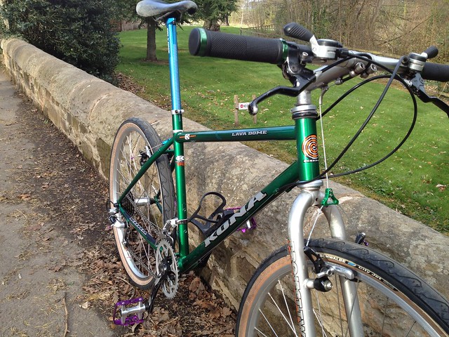

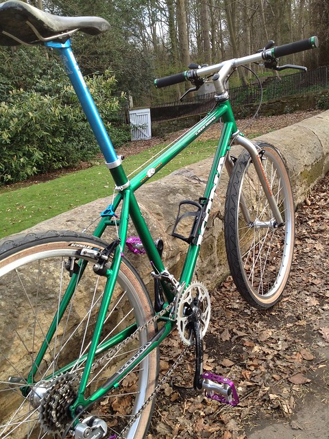

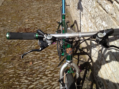

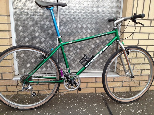

My 94 lava dome..
Bought off the bay in pretty bad shape but reckoned worth saving..
Drivetrain all cleaned up well(new chain/rear mech)
Brakes/tyres/post/old worn flite she's ready to roll !
I Know the blue post ain't to everyones taste but i had it lying about..
Reckon a silver o-beam would be sweet if they came in 400mm ? Anyone have one 27.2 ?
I'ts good to bring an old bike back into use :-)

I'm turning into a serial whinger about canti straddle hangers, but you need to sort them out - front and back - those hangers need to be lower and the angle of the dangle a lot less narrow.
This is not an aesthetic whinge, it's a whinge about setting your brakes up optimally.
PostPosted: Sat Apr 07, 2012 11:18 pm
Gold Trader / MacRetro rider
Joined: Wed Jan 18, 2012 10:48 pm
Posts: 1418
Location: Edinburgh
It's a 27.2 seatpost :) My 95 kula is a 27.0.. Yup Hangers were duly
Lowered after inaugural test ride due to brakes being rubbish :(
They slow me down now :)
