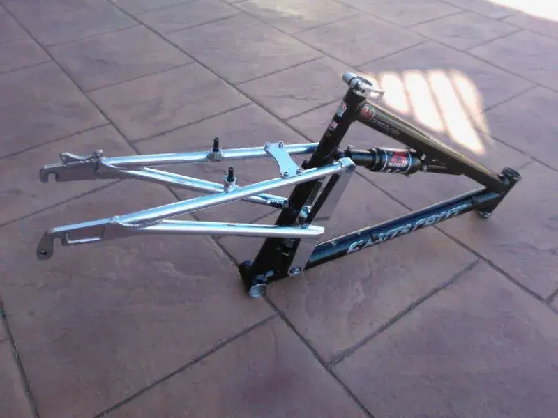

I bought a Santa Cruz Heckler frame, and I want to disassemble
it to lubricate, clean everything right.
The problem is I'm not sure how the rocker is removed.
Someone could explain the removal process?

You need to loosen the Allen key bolts on the swingarm And on the shock mounts
Then once you've done that grab two sockets the same size as the nuts and gently crack them
Once one nut is removed you gently drift the axle through and the swingarm will come loose
PostPosted: Wed Mar 07, 2012 10:27 pm
Old School Hero
Joined: Mon Nov 21, 2011 7:32 pm
Posts: 194
My doubt is that once a nut is removed, the axis with two threads are not easily removed.
You need to hit with a sledgehammer of nylon?
It is important to get the axis in a particular direction?
PostPosted: Fri Mar 09, 2012 8:18 pm
MacRetro rider
MacRetro rider
Joined: Thu Jul 31, 2008 1:45 pm
Posts: 2800
Location: Near a tree, by a river in a hole in the ground....
My Bullit uses the same system and it should push out by hand
Go gently with a rubber mallet and you'll be fine

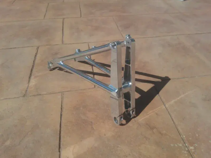

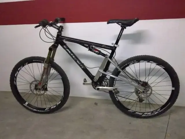

The frame is 96 and the swingarm 97.
I was able to disassemble the frame.
Now this nice and clean
Thanks
