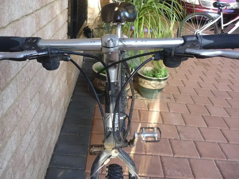

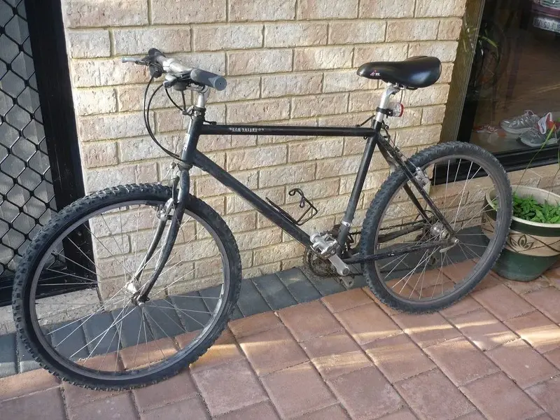

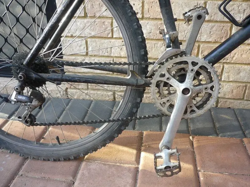

Hi all,
can anyone date my Bear Valley? My brother gave it to me late 90's, used it on and off since then, took it to Australia.
I changed the steering stem because I couldn't get comfortable with the original, also replaced the pedals.
This bike has just spent a Perth (WA) winter outside, sprayed the chain and sprockets and of it went...Again!! Everything works perfectly!
I don't know much about bikes but this one always felt so so light, even when I compare it to modern bikes, and if I am ever frewheeling downhill, this will overtake everything (I'm 80Kg).
So.. I'm thinking of restoring it...Is it worth it? I can't ever remember Marin decals on the down tubes, most pics show them. Are decals available?
Should I buy a Trek 3500??
Cheers - Mark

1992 Bear Valley SE is my punt.
http://www.retrobike.co.uk/gallery2/d/1 ... 4991c95b73
I would certainly give it a damn good clean up and maybe re-sticker it (gil_m on the forum is your man for decals)......but then I like Marins..... ;)

yes, 1992 it is, could even be a 'SE' or is that just two scratches?
anyway, a good clean up will see this bike in action again. the sort of project i like where, all parts are removed, cleaned and re-installed. a great way to get to know the bike and any underlying faults.
the middle ring on chainset looks past it but a few dollars on brake pads, odd cable, decals if you want and see how it runs. bottom bracket will be well-in but worth removing to see if bb shell isn't holding water/corroding.
mind you, you're in aus. we here judge all metal objects against p.o.m.e weather :wink:.
keep us updated.

I wasn't sure if those were scratches or the SE text.....but the front and rear derailleurs are 500LX which was std on the SE, along with the silver cranks.

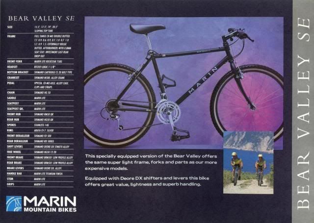

G'day mate.. Here's a picture of what it would've looked like new.
All parts to replace anything damaged can usually be found on eBay (certainly in the uk) so you should have it running well. New bb's aren't very expensive. Have a look in the for sale section :wink:
