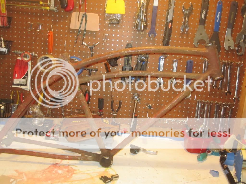

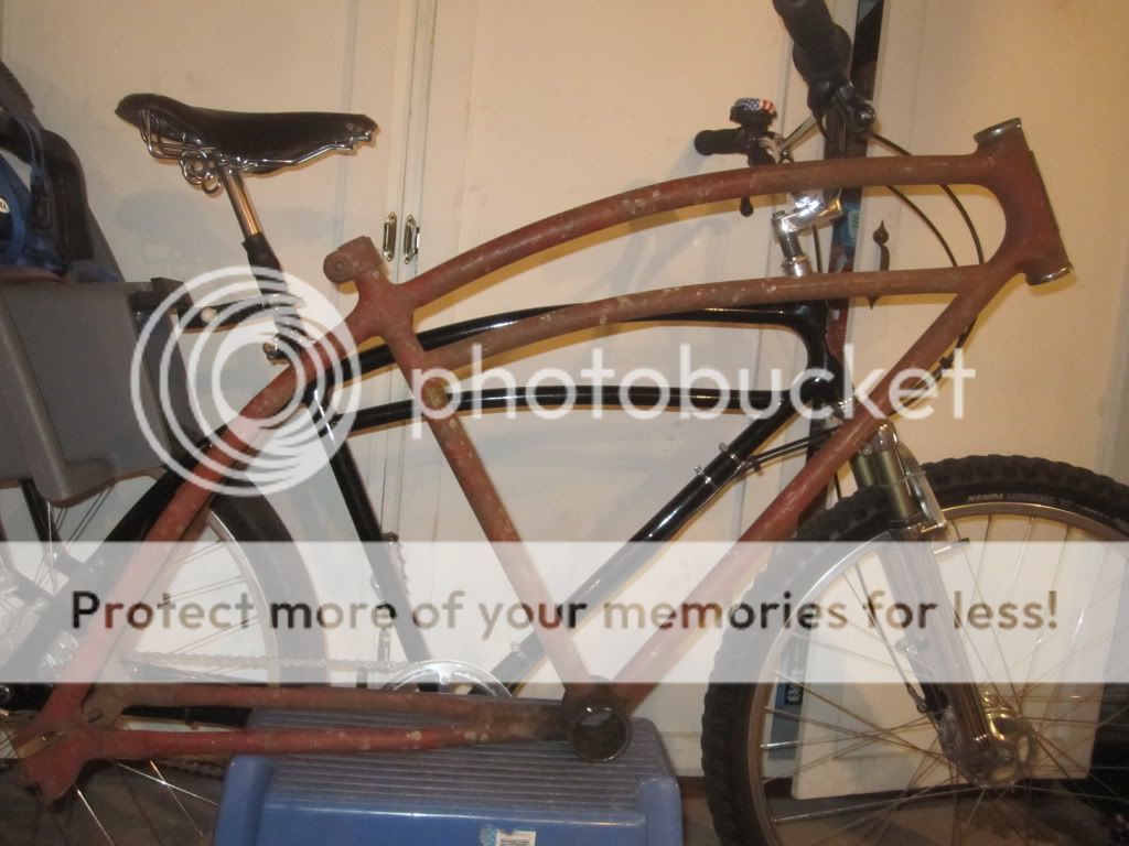

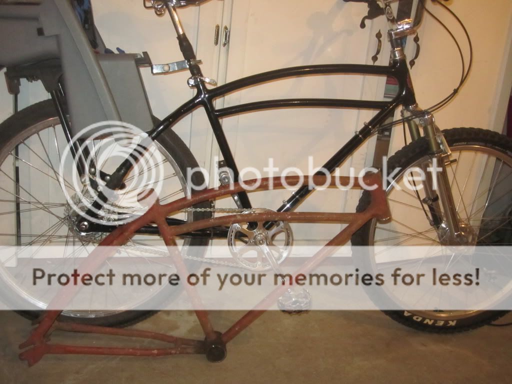

After a long search I finally found a frame similar to my Mercury although it is an Elgin. The geometry and measurements are the same and it has the same flowing lines. The only difference is the rear dropouts which are dropstand dropouts.
As you can see it is just like my Mercury:

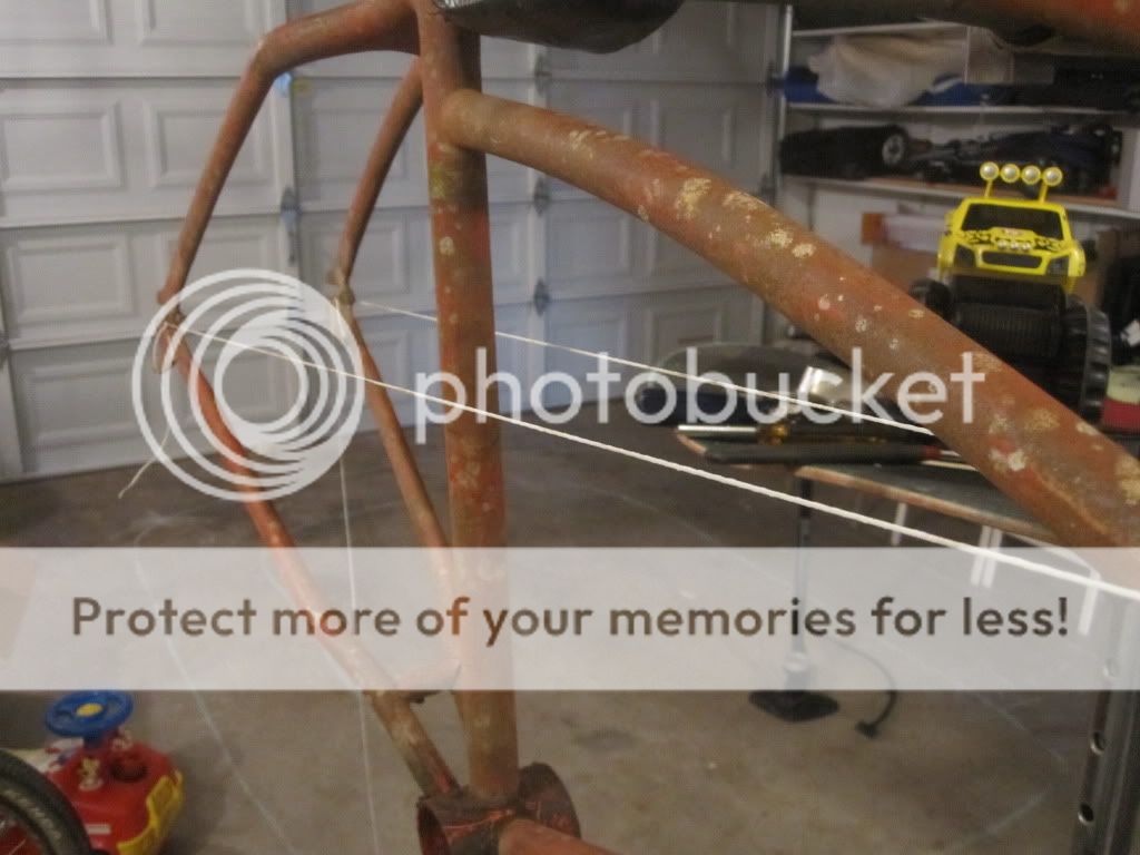

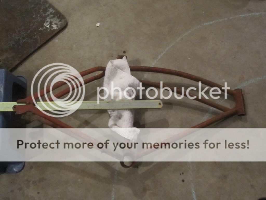

I went ahead and cold set the 110mm spacing to 135, I find that using a 2x4 sucks because they flex so much but this steel counter weight is perfect.
Re-aligning the dropouts was pretty easy using a milling vise. I got lucky and got the alignment perfect on the first try. The key is to be gentle and do it in small increments measuring often.

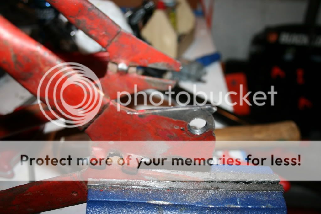

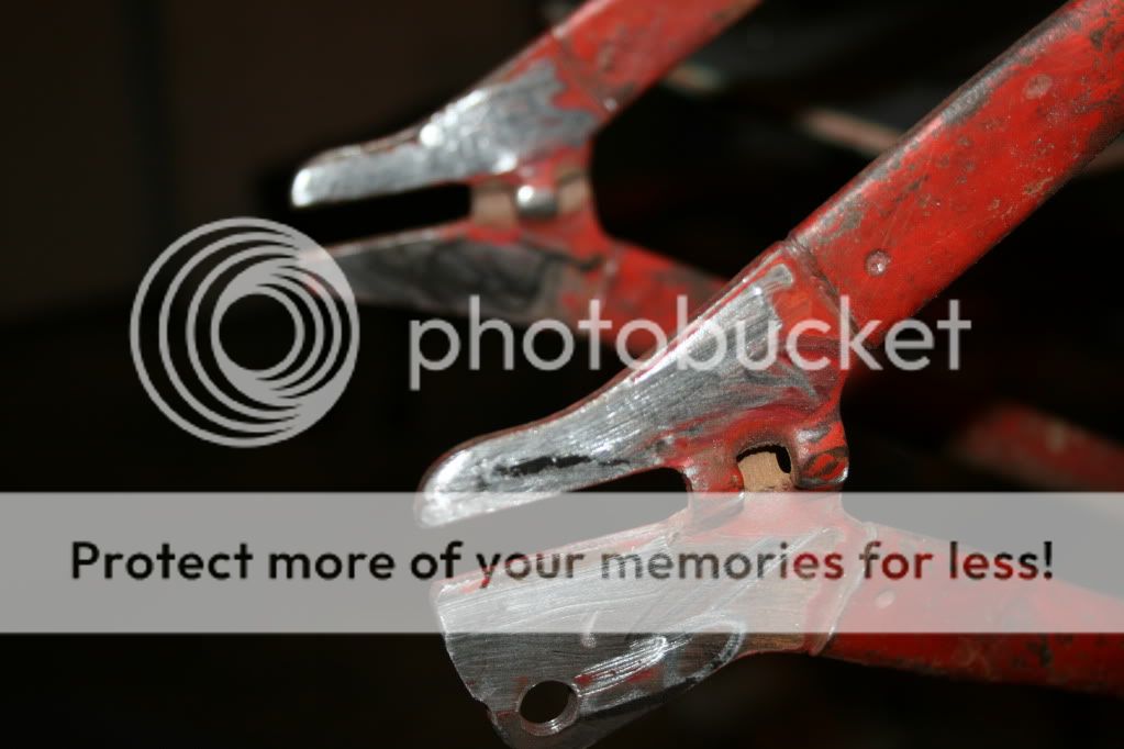

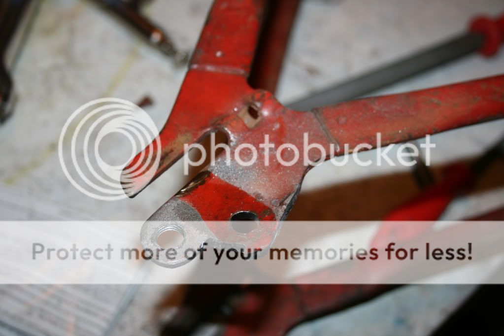

Trimming and tapping the dropouts for a derailler was not as hard as I expected:
Tapping:
Testing:
Trimming:
Final shape:

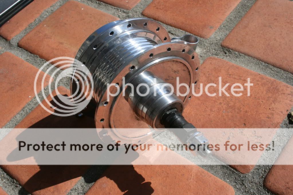

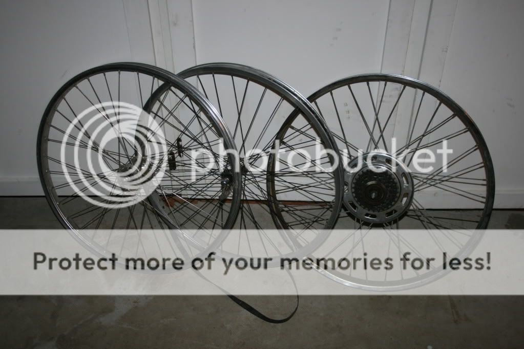

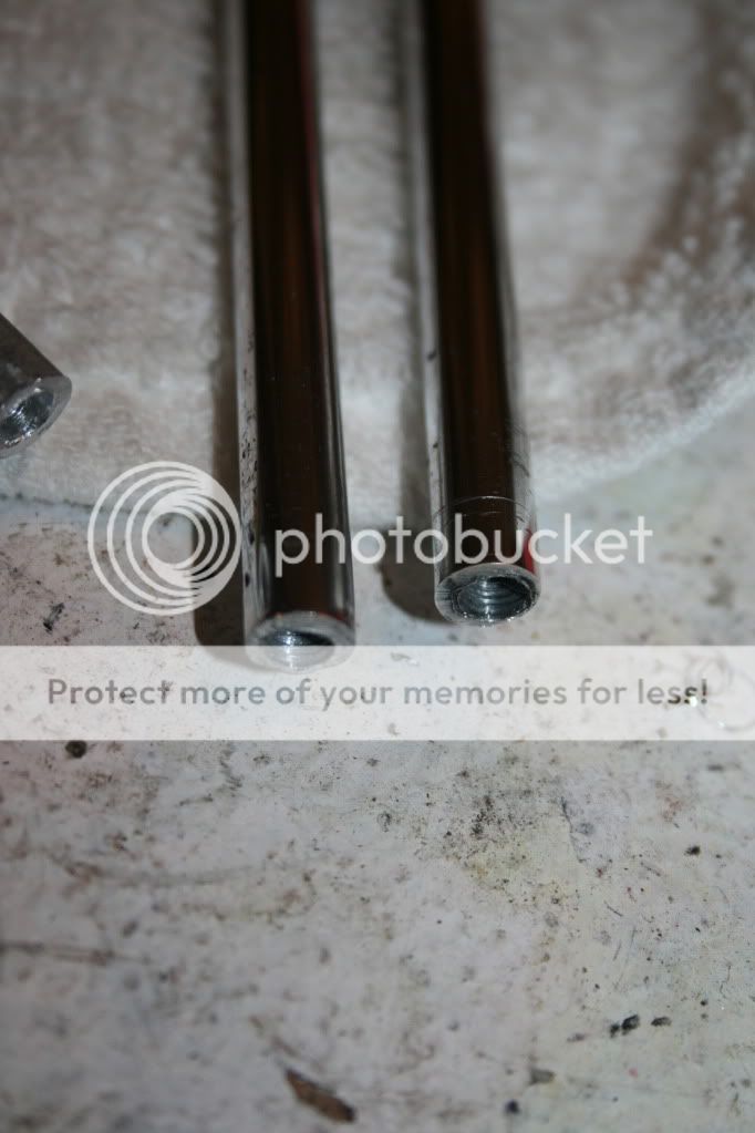

I have 2 really great bike shops that have used parts available and they are always very cheap. I found 2 straight Araya 7x front wheels and a tandem rear wheel with an Atom drum and a 5 speed cluster. The drum was filthy but the internals are in near perfect shape, no rust and the pads are not worn at all. I am also experimenting with making some truss rods out of some scrap aluminum rod I got from the surplus bin at the metal supply shop. Paid 3 bucks for it. I know the Deerhead parts are not exactly correct for a klunker but they work so well that I really want to use them.
