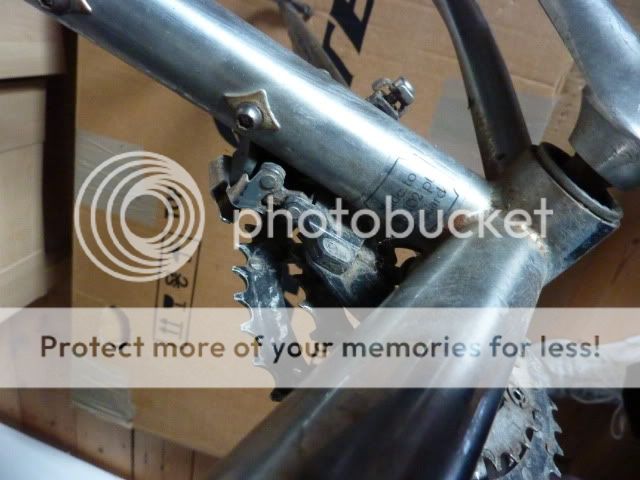

My third segment of Orange comes way of big burner's Nickel P7...
The one as seen in this thread:
viewtopic.php?p=1381270
[quote="Dossa"]Great looking frame - I'd love a nickel P7 as my 2012 project... 8)
^... and so my wish came true! :D

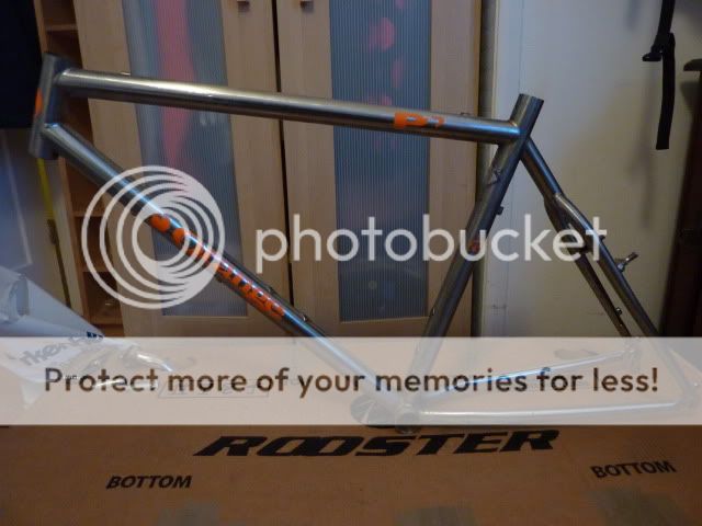

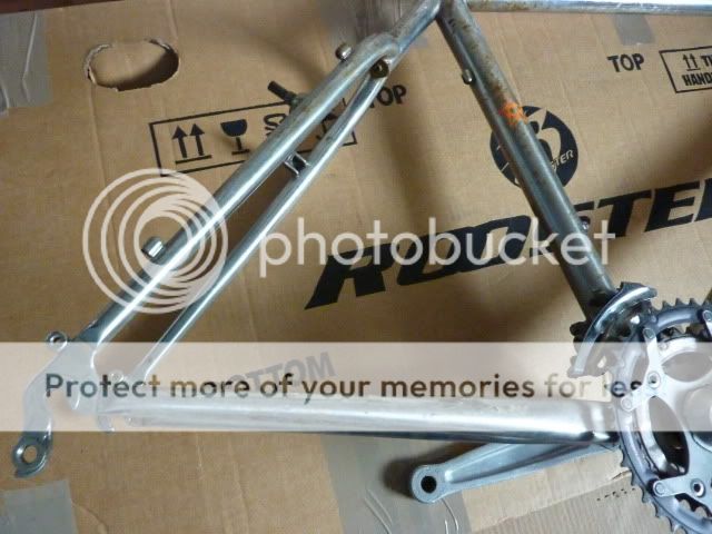

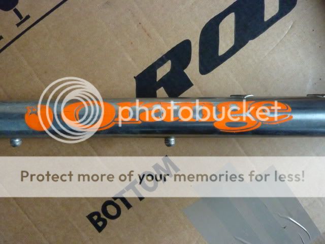

Hoping to turn it into a fast commuter and will base the spec around the M-739 groupset. There seems to a be few P7's floating around at the moment, both here and on eBay, and I was dying to get stuck into a new project so this fitted the bill perfectly. Plenty of nickel P7's on here as well so I've certainly got enough reference material at hand, too, but will still need to pick the brains of the Orange-ettes on here no doubt!
Frame number is A603 02318 which makes it a March '96 made frame, but all the info from Anthony in the original thread suggest a '97 model so I'll rest on the fence on refer to it as a 96/97 P7 from now on.
Frame was in very good condition overall, no dings, dents or scratches and is super shiny under the tatty lacquer. No forks, so will be on the look out for either: F7 forks, RC-30 or RC-35's - whichever comes my way first I suppose! :oops: :lol:
Frame as received-

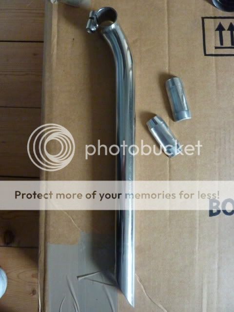

....couldn't help myself and started polishing up the tatty seatpost within 2 minutes of receiving the frame :oops: :lol:

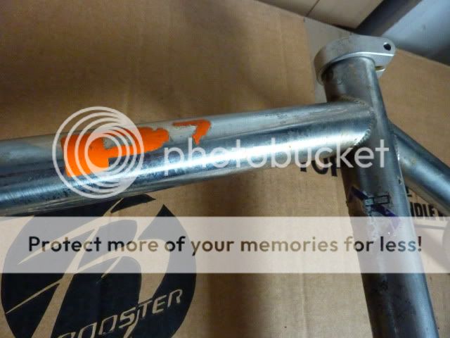

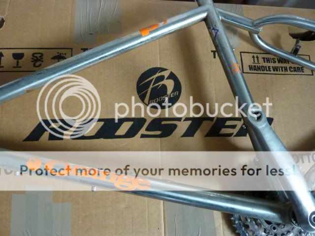

Stripped the bike yesterday as well, here she is in the buff :lol:
Started work on removing the lacquer on the seatstays, too.
:D

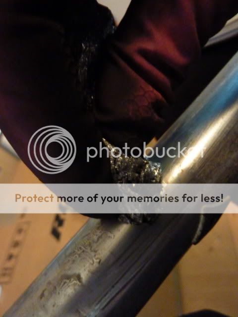

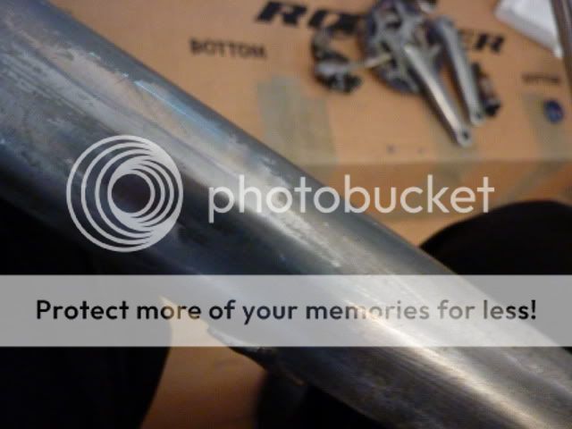

No fancy chemicals were used, just....er,,... some run-of-the-mill kitchen foil (an old wives tip!)
Quick demo on the seat tube:
Start scrubbing for a few seconds:
Hopefully, you can see it shine up already:
Takes a lot longer, obviously, to completely remove the lacquer but I'll be doing the whole frame this way (no laughing!) Nitromars will probably do the job a hundred times quicker but it's very theraputic (..ahem..) doing it with old-fashioned elbow grease!
A quick question--
Is re-lacquering essential to keep the nickel plating shiny, or just a regular polish and wax? Will be used for road use only so it's not like it'll take a hammering...

Great tip using the kitchen foil. Just water?

Yep, kitchen foil (use the shiny side) and a dab of warm water on it...and a fair bit of elbow grease. It won't scratch or harm the nickel plating at all.

As for the lacquer, you'll need to get it done as the nickle rusts up well.

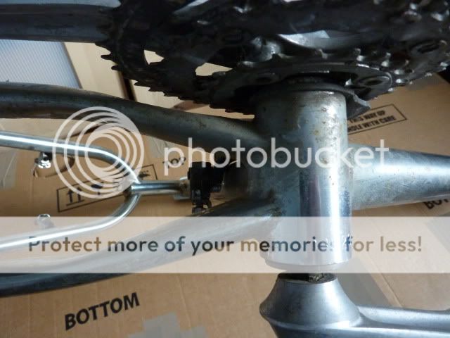

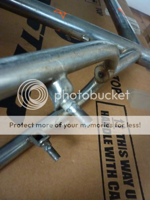

Looks to be a standard front mech clamp in the mag whereas mine requires an e-type mech. Also, as you say, no canti bridge on mine - meant for V's instead.
The head tube logos also seem to vary on the P7 - from an actual 'P7' type to an 'O' type.
Couple more questions:
Does requiring an E-type front mech restrict my options in choosing a mech? (in other words, are they as readily available?)
I'd prefer to run canti's given the choice - what are my options there? A canti bridge guide of some type?

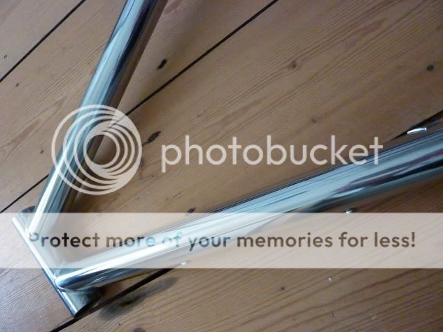

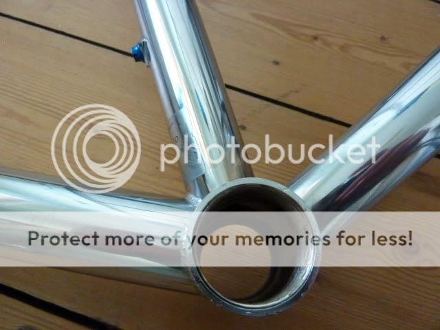

EDIT: lacquer off now and polished with Autosol and waxed with Turtle Wax

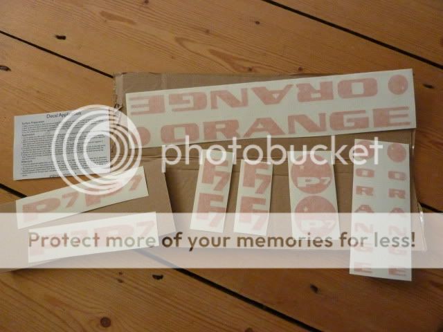

...and some very nice decals off Gil (quelle surprise...!)
Decided to go for the 1995 "Block caps" ones in the end over the original ones simply as I prefer the look of them. '95 was the last year of great Orange decals in my 'umble opinion! Have the odd pang of guilt in not keeping the bike 'decal-correct' but when you think of P7's you think of these decals (...well I do!).
