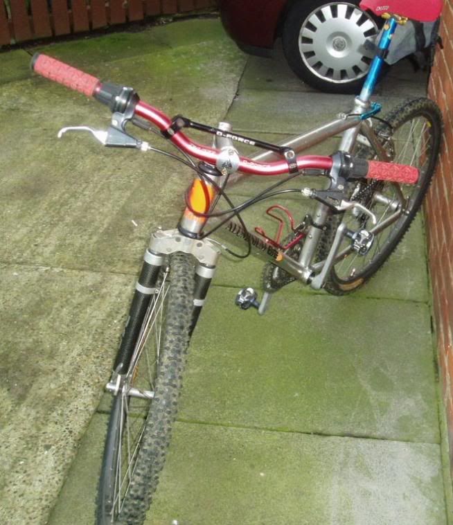

6. From the pics supplied can some tell me what year it is and what the original specification should be for it ?

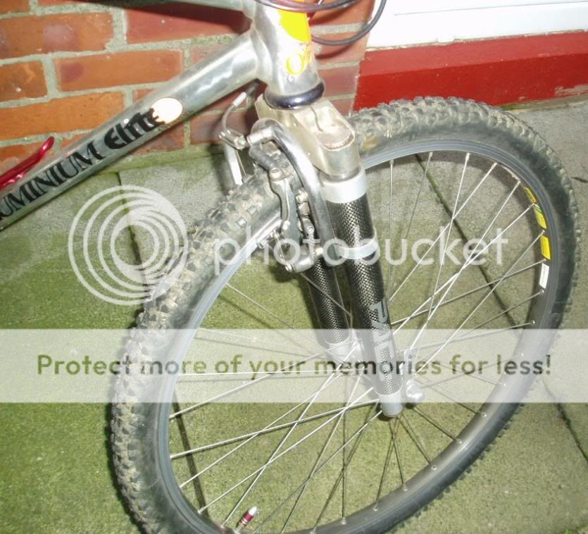

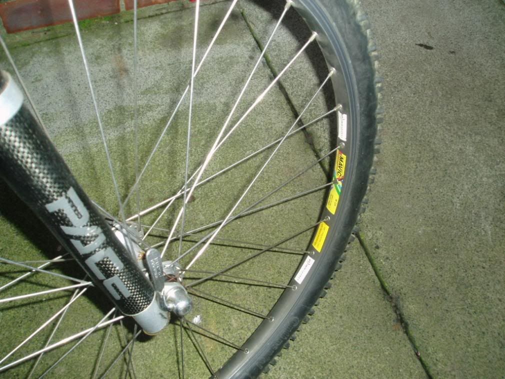

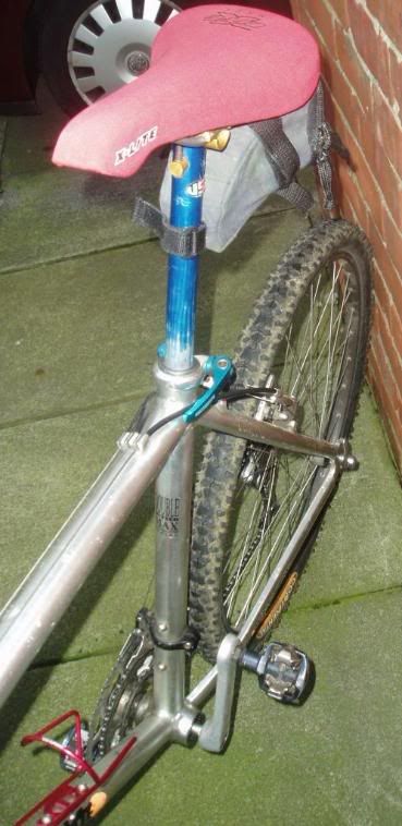

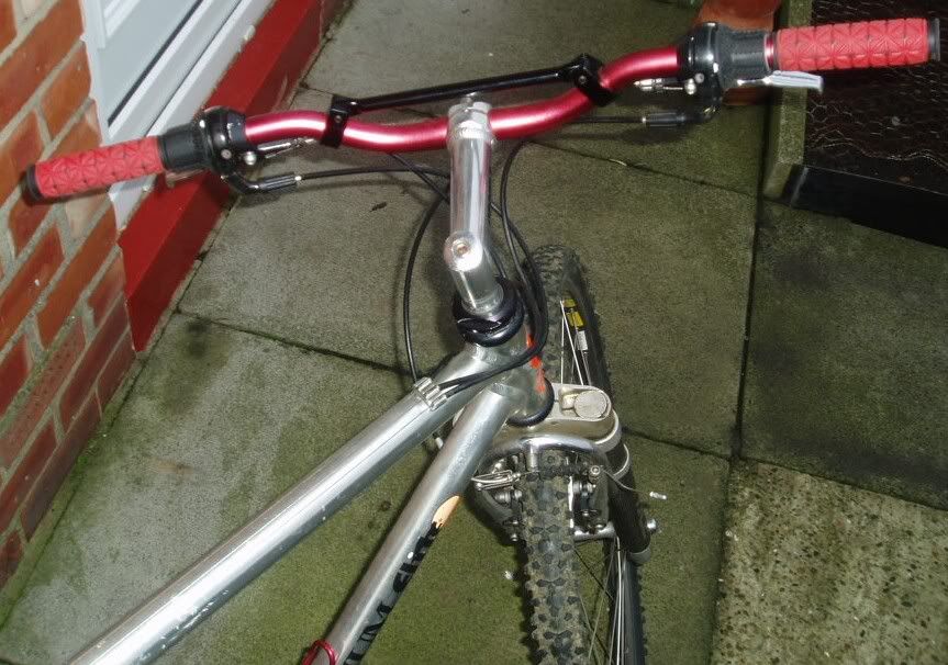

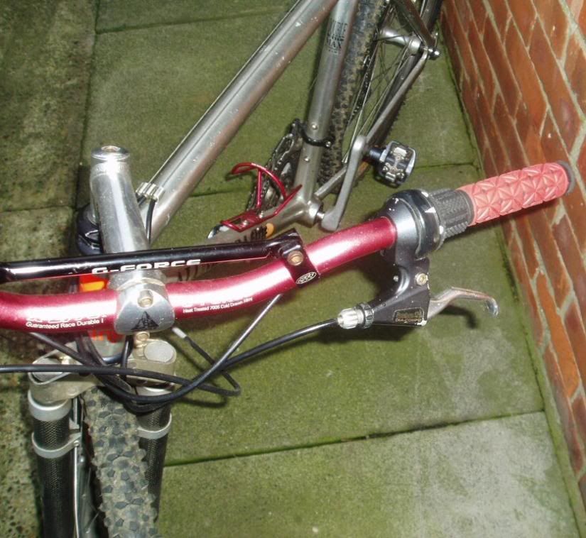

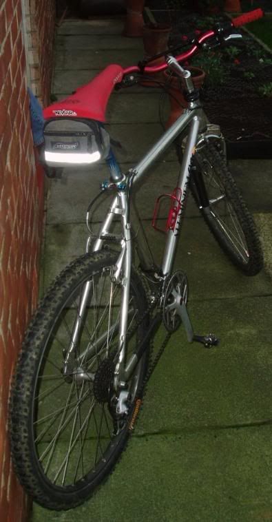

Image[/img]
SPEC
Frame: Orange 18"
Forks: Pace RC35s
Wheels: XT hubs DT swiss spokes MAVIC 231CD rims with continetal tyres
HandleBar: X Lite G Force 7005 anodised red DH bar
Shifters: X Ray gripshifts
Levers: DiaCompe
Brakes: Shinamo XT v brakes
Shifter F: Suntour
Shifter R: Deore XT
Seatpost: USE
Saddle: Xlite
Chainset: Pace full chainset
Chain: Shimano XT
Cluster: 7 speed
Pedals: Shimano XT SPDs
Pace chainset

dont think ive ever seen pace forks that collasped before,
id strip the bike, remove the decals, polish the whole thing to a nice finish, get some replacement decals made, see gil_m
then use the parts that are in good condition and source some nice trick replacement parts.
and have fun doing it.

You seriously need some new elastomers (rubber springs) in those Pace forks! :lol:
I'd also consider replacing the seatpost. Other than that, if everything is in working order then just ride it.
By the way, the chainset isn't Pace - just the chainrings. Cranks look like Suntour (it will be stamped on the backs of the arms) :wink:

First off, your Orange should build up into a very nice bike with not a lot of cash and is more then capable of holding it's own against modern bikes.
You could do a completely retro build or a modern one, or if it's to be in regular use maybe a bit of both.
With the kind of budget you're talking about you could easily resore the big O and still buy a new bike for every day (maybe a new big O to match :wink: ) If you wanted to.
Finally, for £2000 you could get hold of a good example of any of your dream bikes, maybe a couple of the 'cheaper' :shock: ones.
Oh, and if you did decide to sell up and start again. :cry: You'll make much more selling it as parts. :wink:

thanks for the advice on the pace forks - to tell the truth they have been like that since the winter of the bikes exile many years back - funny the forks ride like rigid forks now ! lol
i do have a bit of a soft spot for the orange and it still does ride well so may do the retro refit - if anyting it will be fun and the end product will be my work of art !

speak to pace and get those elastomers ASAP, seriously messed up angles with the forks that collapsed. (or speak to justbackdated on these forums- he can probably help)
