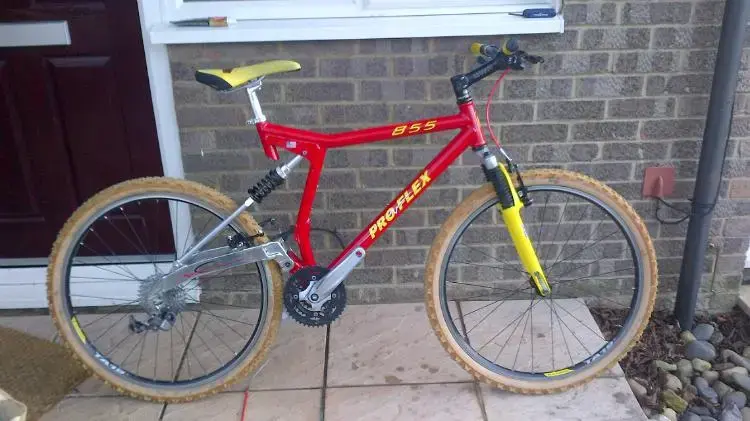

Getting close to finishing my 855 build.
Decals from gill applied last week and looking good.

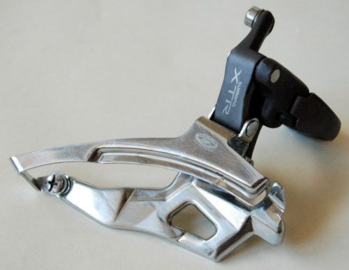

I'm having a bit of a nightmare trying to fit the front mech as if i fit it in the regular place it hits the swingarm.
Anyone know what the most suitable front mech to use is on the 855?
I have a top pull Xtr which isn't fitting
Thanks

Top-pull, would that actually work as they use a bottom pull mech (I don't know the bikes)
But bottom pull, traditional style (bottom-swing) is what I see in pictures on these.
Try the compact drive style as they have a slightly more compact cage.
Something like this one (FD-M737) and (FD-M953)

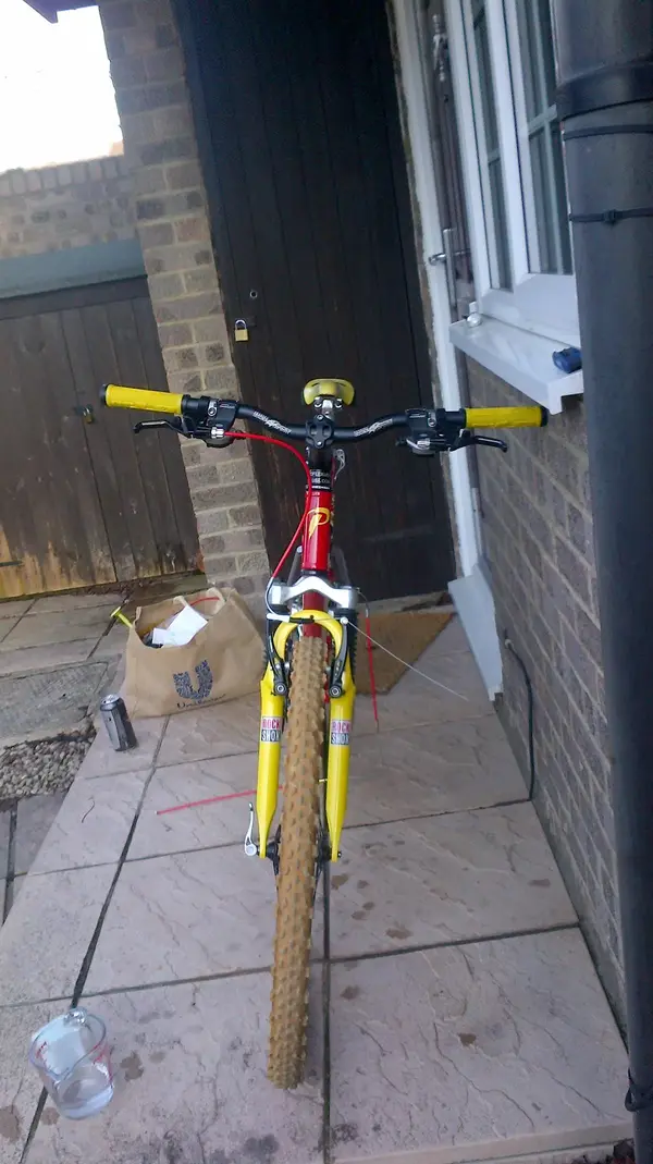

i am using hte 737 pictured there on my beast
looks very tidy but the seatpost is on back to front

ah yes thank you, wouldn't of noticed that until i rode..
Will take a look at the different mechs this week and see which works well.
Vbrakes on it at the mo are only temporary, looking out for some xtr v brakes now
