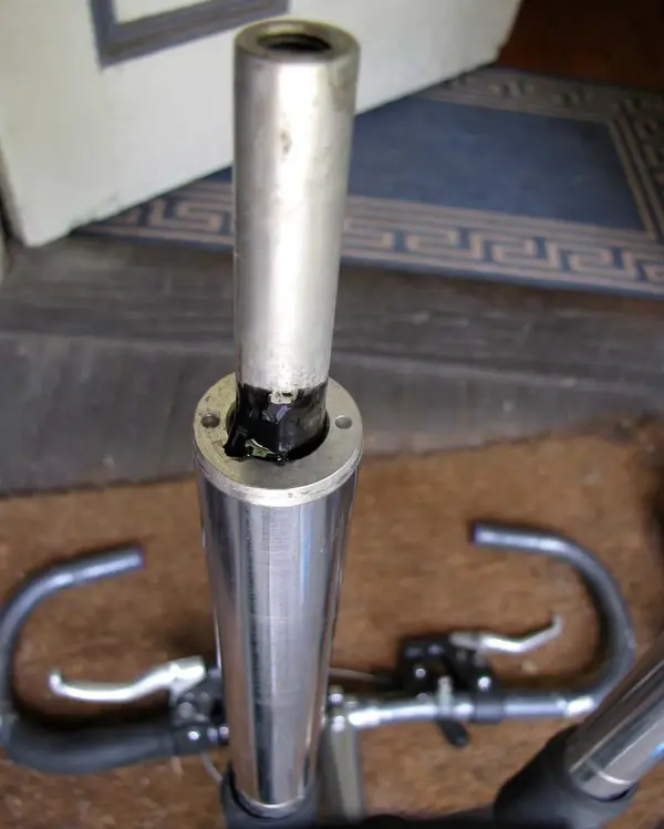

abot forks - IMO there's no elastomers inside, only coil spring in both sides
Those forks had bad seals, so if forks wasn't servicing regulary, You could have a problems with bring it back to live...
That's what I found inside mine (it was also rigid...)
But also the problem could be just old, thick grease - Scott was using some special thick grase as a damping system in spring forks
Didn't realise the gloo seeping from the bottom of the forks was just grease as didn't have all my tools to check it.

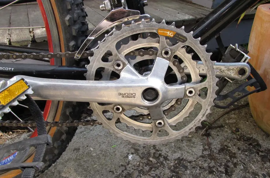

Didn't have high end XT or XTR gear but the DX 7 speed stuff was pretty decent and was amazed how good nick it was in considering the crappy conditions I rode it in long ago. Replaced the original headset with a new 1" Ritchey Logic one and found some old school 20 year old Ritchey Duro 2.0 tires for it but need to track down some cantilever brakes to finish it. Unfortunately will take at least a year to finish as the bike is in NZ and I live in OZ. Too many bikes already here so couldn't bring it over.
