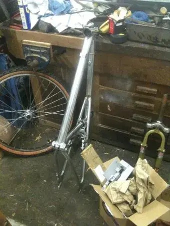

File comment: Made a start last night..

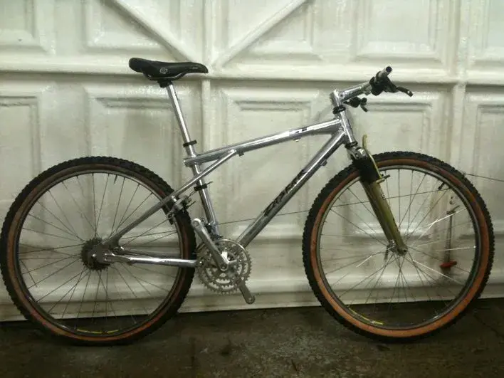

Another iphone pic of assembly so far. I reckon we'll have her fully rolling by 2012!

Hi nice GT just noticed the U-brake i've never seen one before mounted under the stay like on yours on any GT, was there any others like this
:roll:
I guess its done due to it been a small frame size?
Looks a nice bike.

From the profile it appears to be a late 92 production 93 model year frame. Because 1) it doesn't have a replaceable hanger and 2) because the u-brake is mounted under the chainstay. If you remember your Shimano history.... the number one reason GT used u-brakes was because all the early cantilever brakes had wide profiles when cabled up meaning that you heel would clip them when mounted as low as they would be on the lower seat stay of a triple triangle frame. In 1993 Shimano introduced their lower profile canti's that barely stuck out past the seat stays. It was still enough of an issue on small frames when GT switched to canti's on most sizes in 1993 so they continued making the 14.5" frames and some early production 16" frames with the u-brake because on the smaller size frame the stays are even lower with even more potential to clip the brake with your heel when riding. This would be an early production 1993 model year frame set. Have one of these 1993 model year 14.5" frames at my house, purple ano ridden by my youngest daughter. They were mounted under the chainstay for better/straighter cable pull on the smaller frame. (Note the cross over cable guide is mounted below the seat stays). The other reason it can't be a 91 model year frame is because they only offered 16, 18 and 20" that first year. If it's stamped XX91 it would be an early producution 1992 model year frame.

Thanks guys - yes it's coming on and looking good! Gotta love the old Zaskars - I still miss my last one!
GM - thanks for the top knowledge! This all makes a bit more sense now as when it arrived I remember spotting a "92" on the serial but not giving it much more thought. You clearly know your onions! By this then it's either a 92 or 93 like you said :)
Does that also mean I could change the decals? (if it does Im glad, as I prefer the look of the later ones).
Im liking your daughters bike - are they the correct decals then for that year?
