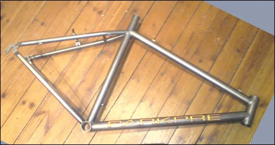

The victim was a poor advert for a "Parkpre Titanium Frame". One bad photo, and not much in the way of a description - usual iffing and arring and drinking Pernod I contacted the seller to get some specs, and cheekly to get the reserve amount. I bid exactly on the reserve amount, and got it. It was cheap, but not a bargain. A co-ordinated delivery to a hotel in Derbyshire while on a business trip to the UK meant I could put it on the aircraft hold as checked in luggage back to Stockholm to keep the costs down.

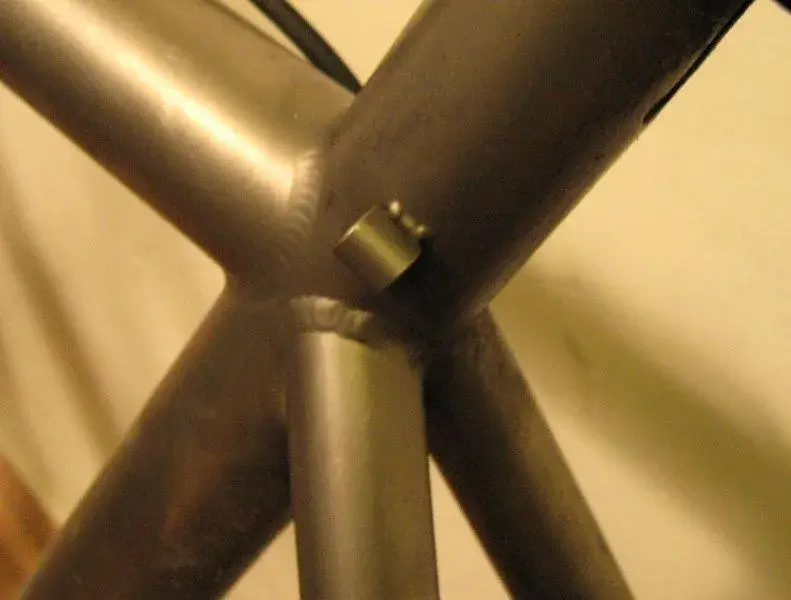

Perfect and top bannana I thought. Unwrapping it and seeing what I got was a bit mixed though..... it had a crushed top-tube cable guide, a repair or preventive weld to the bottom bracket and a stuck in allen bolt in a revolving bottle cage rivet. Feck. Whisky time. Another look with an objective clear mind said it wasn't bad, and most could be fixed and cleaned-up. On a positive side, it had no dents, dings or deep scratches - no signs of chain rub at all. I did find about five generations of spider birth and burial grounds down the seat-tube. As the seller said "it's been at the back of the shed for over 8 years".

The old girl got built up. In fact I didn't bother really cleaning it, just straightend out the crushed top-tube cable guide, stuck parts on it and rode it....and loved it. Fantastic ride quality, nice neutral handling but still responsive to correct lines on fast corners and super comfortable. I put some 150 Km epics on it (which incidently forced me to finally fix the bottle cage rivet issue). It quickly became my main steed. In fact nothing else from the fleet got ridden it was that good - even with shoddy odd bits and parts.

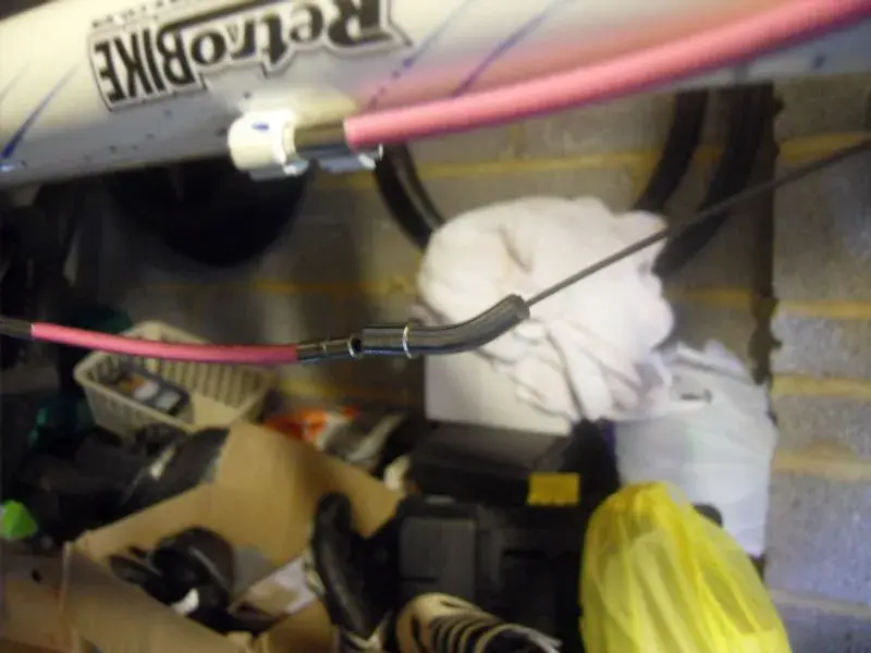

First things first, this is coming off. I never did find the special noodle canti-guide thingy anyway...besides it will come in handy later....

If you require a brake cable noodle I can put you in the right direction.

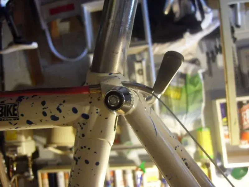

Brake noodles can be found here > http://www.venhill.co.uk/Cable_Kits_and ... AHA__.html
I have used them twice now. They fit fine on steel and alu frames but I found them a tight fit on my Ti frame. All you have to do is hacksaw off the threaded section.

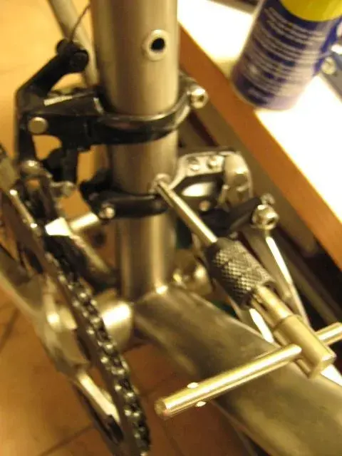

Bottle Cage Rivet Fix - how to
Thought I would make a post on how I fixed the stuck allen bolt in the revolving bottle cage rivet before I jump off to the dungeon and continue the build. Someone may find it usefull.
1) File the head of the allen bolt so it is flush with the diameter of the thread; you can be lucky and still use an allen key to hold it still, but chances are you will gradually file to the point the allen key is useless.
2) Cut a groove in the bolt on the small remaining head showing; thus making it a screw.
3) Get a front mech, and clamp it to the tube plus the little bit of exposed bottle cage rivet. There should be enough contact point and force to stop it turning.
4) Screw outwards if you can. It may be best to take the seat-post out, screw inwards and let the screw fall out.
5) With the front mech still attached, re-tap the thread to clean it up properly.
6) Then use this trick to tighten the rivet back up. It works a treat!
http://blog.pedalandwrench.com/2008/12/ ... tling.html
7) Job done, mount your bottle cage and make sure you use a good loose fitting new bolt to avoid the problem again. They don't need to be super tight.
