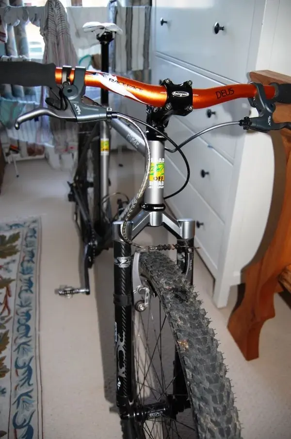

I think this is a pre-97 frame, but I'm quite happy to be moved on if I have offended the keepers of retro. It's a modern build however.
Following an appeal for a v-braked nippy XC frame I bought Nick's (suburbanreuben) Scapin off him.
It's a fairly modern build on the basis of what I had to hand. Bit of faffing to make the 70mm Italian Ultegra external road bb take the mountain chainset.
RC31 420mm a-c fork
DT 240 Hugi hubs on Mavic X517s
XTR m952 v-brakes
Saint m800 9 speed shift lever
XT shadow rear mech
SLX cranks with Goldtec 34t ring
12-36 deore cassette
Dura Ace chain
Thomson seatpost 26.8mm
Hope stem 110mm with 5 degree rise, 31.8mm clamp
Race Face Deus XC 31.8mm bars
Ritchey WCS ergo foam grips
Prologo Nag Pas ti rail saddle
FSA Orbit headset
Eggbeaters
Nokon and XTR cables
Michelin dry tyres run tubeless with Stans rim strips.
Not the lightest frame but the bike feels light and I reckon it's going to be springy as a lamb.
Rich

PostPosted: Tue Oct 18, 2011 7:00 pm
Joined: Sun Jun 27, 2010 9:37 am
Posts: 3976
ooh looks nice :D would aesthetically prefer a tripple than a double and bash but nit picking :D
PostPosted: Tue Oct 18, 2011 7:31 pm
Joined: Thu Nov 09, 2006 11:19 pm
Posts: 1939
Location: Gwlad Gwlad to be here
Thank you.
It's a single ring. The bash is there to keep the chain in place until I get a chain device of some sort.

PostPosted: Wed Oct 19, 2011 12:33 am
Joined: Fri May 01, 2009 7:11 pm
Posts: 8520
Location: Go ask Alice...
Looking good , Rich!
It's not the lightest frame of it's era , but it compares favourably with modern frames, and is a pound lighter than an Indy Fab I had for a short while.
Modern components suit it,, and the orange bars provide a necessary splash of colour,.
You could have taken your pants off the clothes drier though... :roll:

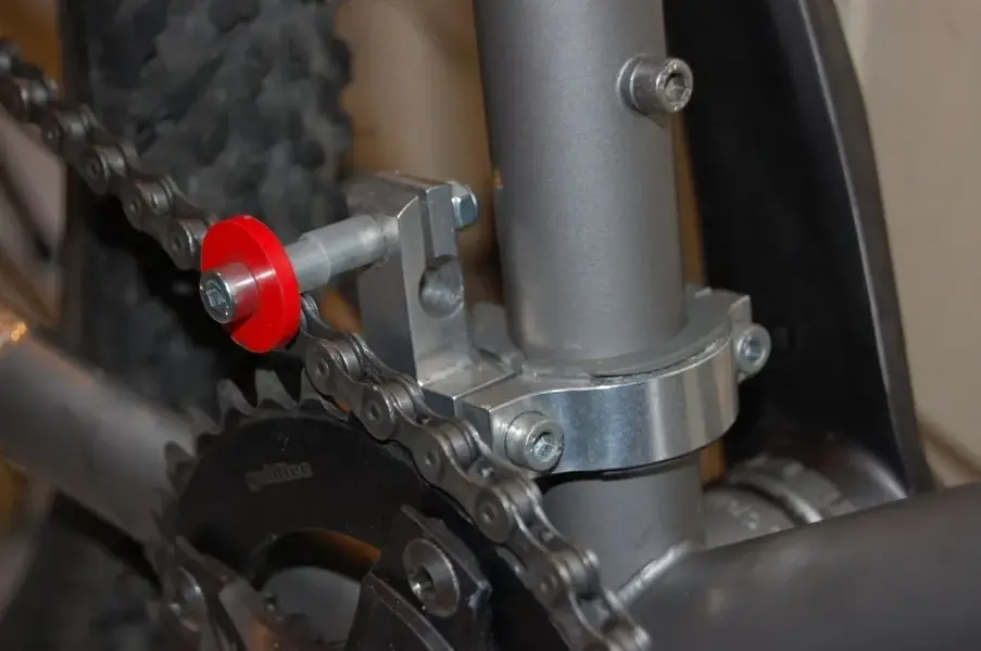

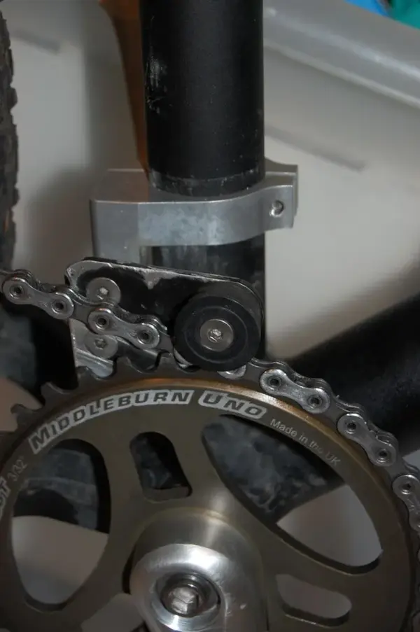

So stung was I by the criticism of my bash ring that I have fashioned a new chain keeper. It's the mongrel offspring of a Roox Chaindog.
Here are MKI and MKII. Both working well so far and less clogging than with the bash ring.

PostPosted: Thu Oct 27, 2011 7:05 pm
Gold Trader | rBoTM Winner
Joined: Thu Jan 03, 2008 3:10 pm
Posts: 1843
Location: Froggie
owner of another later scapin, I can only be supportive of the effort 8)
actually your frame looks more elegant than mine ( a rudolf)
what is the tubing ?
nevertheless, I always find these modern cranks to lack that sort of elegance :wink:
let's have the middleburns quick :lol:
PostPosted: Fri Oct 28, 2011 10:48 am
Posts: 1939
Yes, it's an elegant looking thing.
The tubing is I think Dedaccia Zero Uno.
The ride is very good. Very responsive when you push it but also very forgiving.
I went for the nasty slx cranks because it was easy to find an Italian threaded external bb. I might try a bit harder to find a long Italian square taper bb soon. Also the Burns look really good on the Nicolai...
