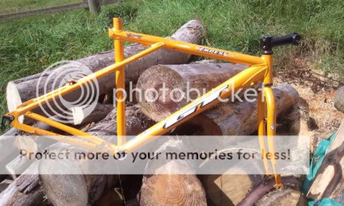

I have got a GT Tempest frame:
After removing the forks, I have been with a frame that needs stripping. After drooling over MIkee's photos of his frankly intimidating collection,I have decided that there is only one way to go - polish the frame.

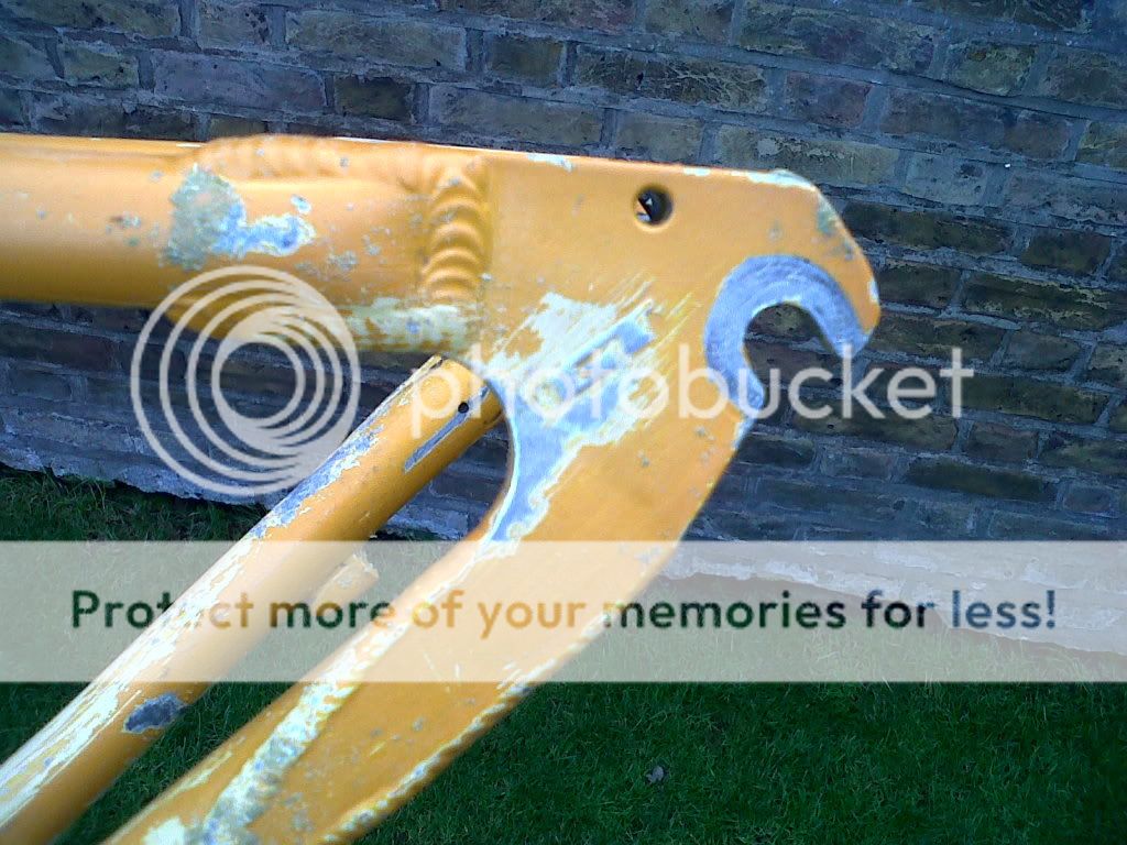

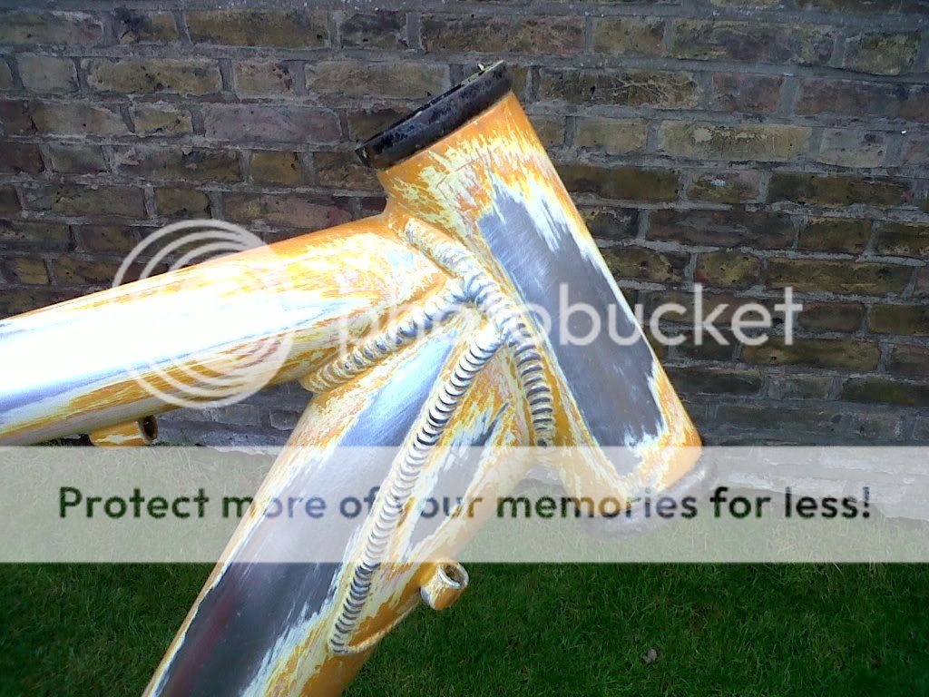

So I made a start with Nitro Mors and coarse wire wool:
I love the detail on this frame:
Only thing is the paint is being stubborn. I am hoping to make (very) gradual progress and will use this thread to detail how it's going.

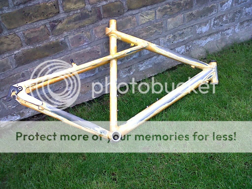

Ok, so the paint is nearly off:
It has taken 4 coats of nitromors so far, and lots of scraping. I have found the stanley knife useful, scrape off the top layer, and the paint underneath responds ok to wire wool. Tried a stiff wire brush but that was digging in to the metal so I had to give up on it.

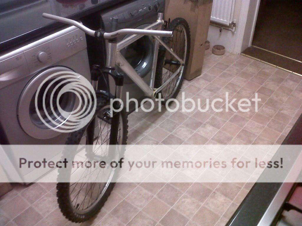

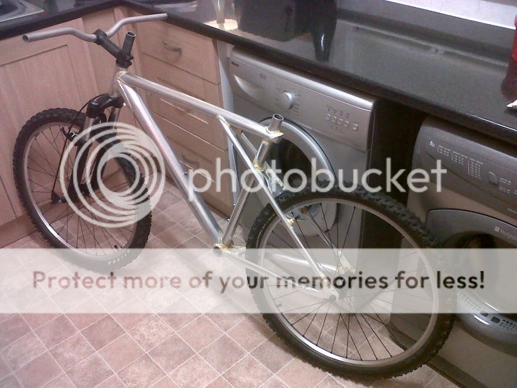

The build is progressing. Thanks to some great buys on here, I now have most of the bits I need.
First, a couple of obigatory kitchen photos:
As you can see most of the paint is off, don't look too closely at the welds! They will be finished soon, but when the wheels arrived I could not resist looking at the bones all together.
