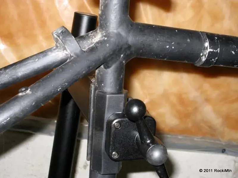

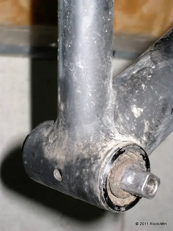

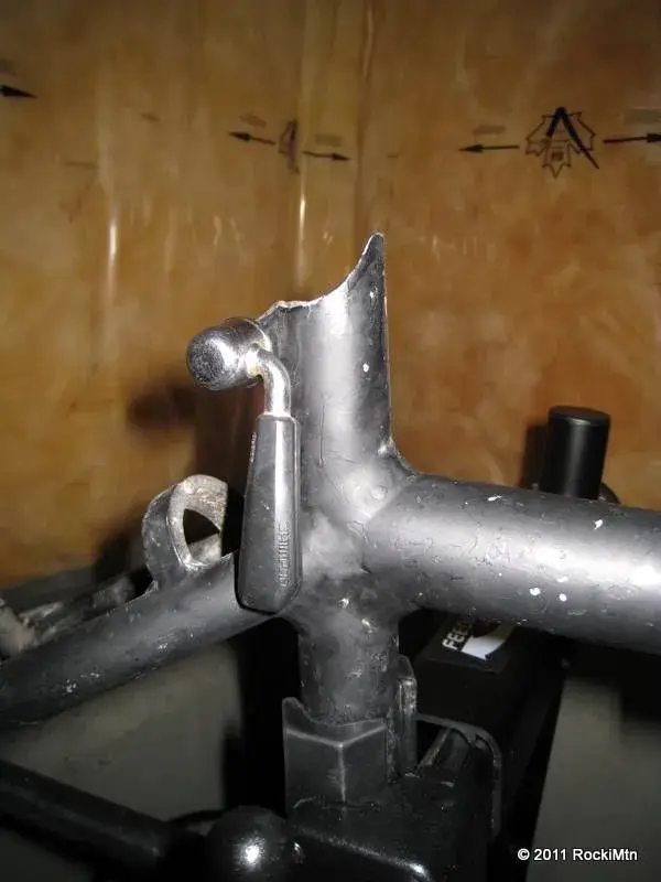

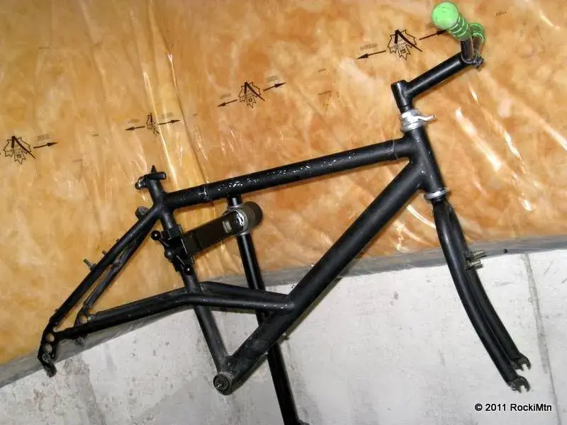

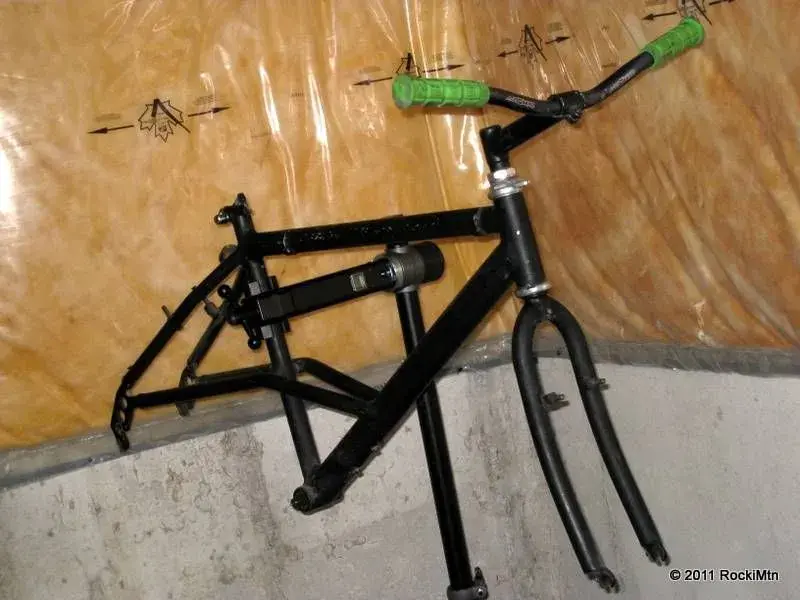

picked up this sad rattle-canned specimen. overall i think it's in structurally good condition with no dents or cracks i can find. however, i'll need to strip the paint off to really get a good look.

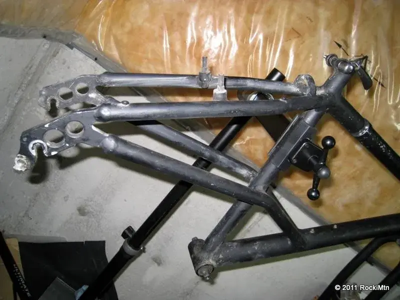

seems there are missing cable stops for both the front and rear derailleur. :( am i just missing a cable guide on the BB shell? prev owner said he had used it SS.

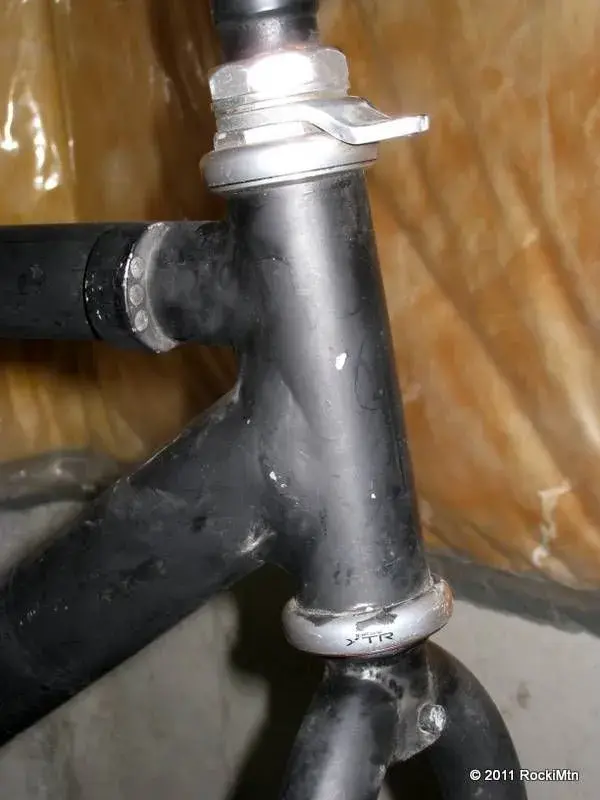

believe the post size is 26.8mm. haven't had a chance to pull out the BB, hopefully won't prove difficult. has a decent 1-1/4" XTR headset and CT stem. Some blue Azonic risers.
Anyone can identify what forks is on it?

At first I thought the fork was an old Fisher unit but I checked some photos of my '91 Montare e-stay & they look totally different. :?
I really like the look of a curved unicrown on Funk frames. They just seem to fit with the styling of the frame.

Nice ride Arran. Think this one will turn out quite similar in looks once the paint is removed and polished.
Believe what i have is similar to this 91, as it has what looks to be bolt on cable stops for the rear mech. However, i see no signs of holes for cable stop and pulley for the front mech. perhaps after the paint is stripped off i'll find signs that they got filled in??? :?

mine is an early 1, 1990. what you have there looks very similar. the front mech outer goes down to the mech & the inner in bolted to the bb shell. i'll try to get some pics for you.

Here is a shot of another one sold recently that appears to have no front cable stop (either screw in 91/92 or welded on 92-).

pretty sure that's a Tange big fork. Nice fork, but a bit heavy.

is what mine has, i do believe that was the spec early on
