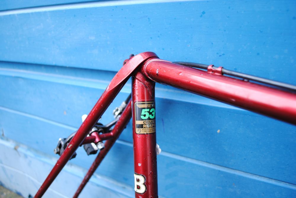

The frame is a 1989 Tom Bromwich (maybe a Cyclone, not too sure), at least I am 95% sure it is, it has the same details as a number of other Bromwich frames some of which are very specific to his builds such as the dropped TT/high seat stay junction, the short chainstays, the tall head tube (in relation to the frame) and the odd threaded bar with a canti stop on it. Obviously it has had a fair chunk of use, and probably a few years languishing in a shed somewhere after it ceased to be fashionable, there is rust worming and bad chainsuck marks on the DS stay, and a cable stop on the TT needs the remains removing and replacing. Worst and most annoying part is the welded in BB, I have got as far as getting the axle out, and now it should be as 'simple' as cutting the cups out - lets see!

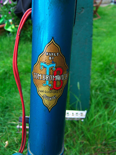

It's interesting to see the 'Far Gosford Street' head tube decal, -the shop later became John Atkins cycles, and is now Coventry Cycle Centre. My dad still refers to it as Bromwiches' :)

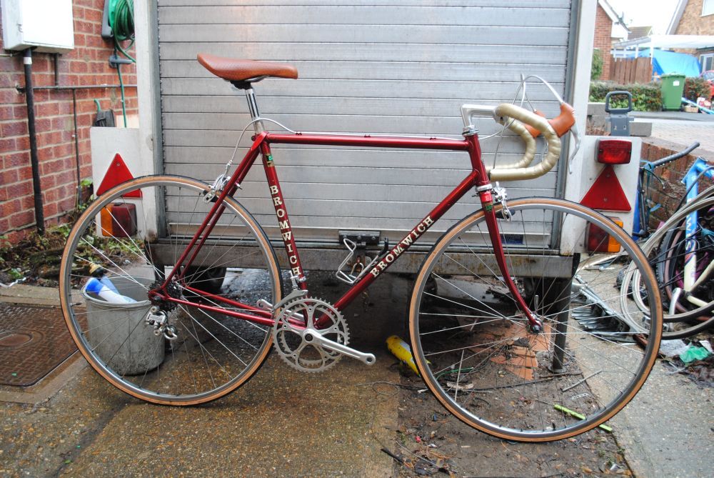

A Bromwich Cyclone frame was reviewed in Bicycle Action Magazine...the frame was made up as a testbed for the new Campag Euclid groupset. Replicating that would be a Retro challenge!
