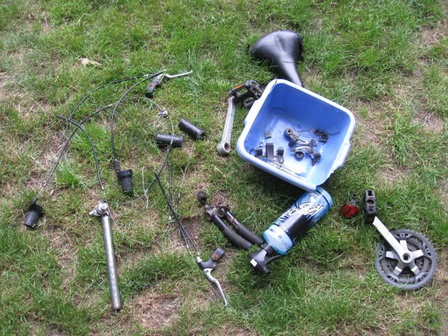

Dismantled & cleaned (most of it) on Sunday

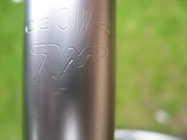

Can anyone identify the make (logo) on the bars.....

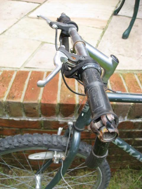

One final question were the quill stems branded Saracen or were they Kalin? Answers on a postcard please :D
I haven't seen that before. The bars on my 1993 Saracen were Ritchey.
The quill stem on mine wasn't branded at all, although I seem to remember that earlier Saracens used Ritchey stems... :?

Saracen generally sourced many of their parts from a variety of mostly Far Eastern manufacturers .
Seatposts, stems and bars varied from Kalloy, Kalin and Zoom. They also had saddles from Velo and Vetta amongst others.
The stem on yours looks very much like a Zoom and it's probably original.
Like many manufacturers Saracen also had components branded as their own, but they didn't actually manufacture them.
It's possible to get most of the finishing kit with Saracen branding, particularly during the earlier part of the 90's.
As mentioned some of the mid to higher range bikes had Ritchey branded kit too.
Anyway, your bike may already be powdercoated, (most Saracens were) so I'd hesitate about re-doing it as it still wears it's original decals too. Just clean up any exposed rusting metal and touch it up perhaps
