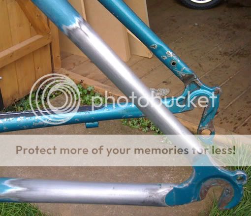

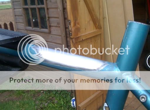

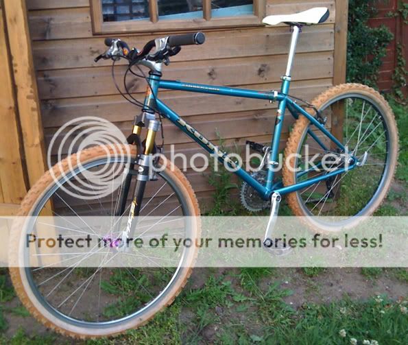

I have a couple of bikes I use but I wanted a modern hardtail so thought I'd try an On One. Built a 456 summer season and decided it was way too beefy for what I'd use it for, as I'd always take my stumpy fsr if I was going for a 'bigger' ride. So for more distance/xc riding I tried out my Cindercone and decided to modernise it. Some will say it's not cost effective but the frame owed me -£ and I was owed a favour from a friend that has a paint shop.
A little research found Lee Cooper was only a few miles away so he did the frame modification... http://customcycleframes.blogspot.com/ really nice guy, did a great job and wasn't really expensive!
Anyway, she's not built up yet and I think my Gilm decals are sat at the post office but here are some pics so far:

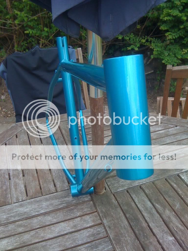

Previously:

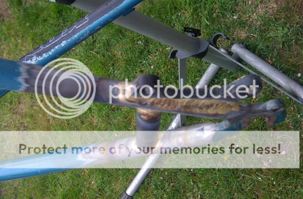

Frame prep pre mounts:

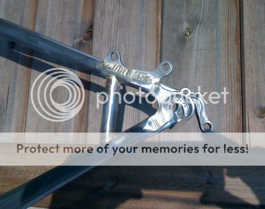

Back from Lee Cooper:

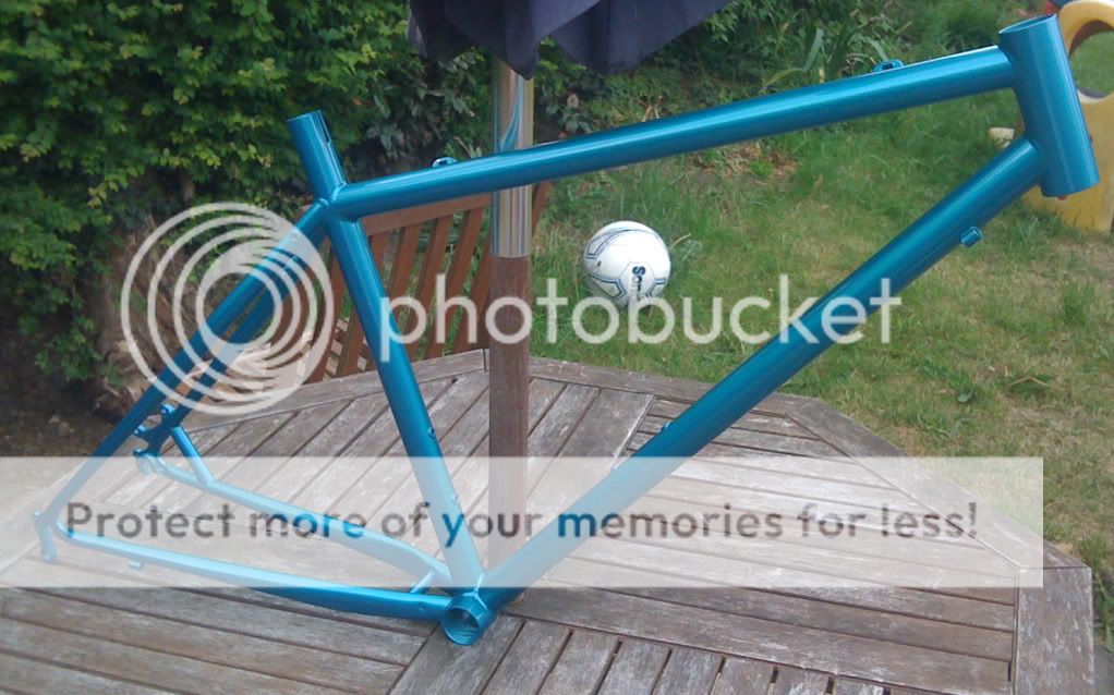

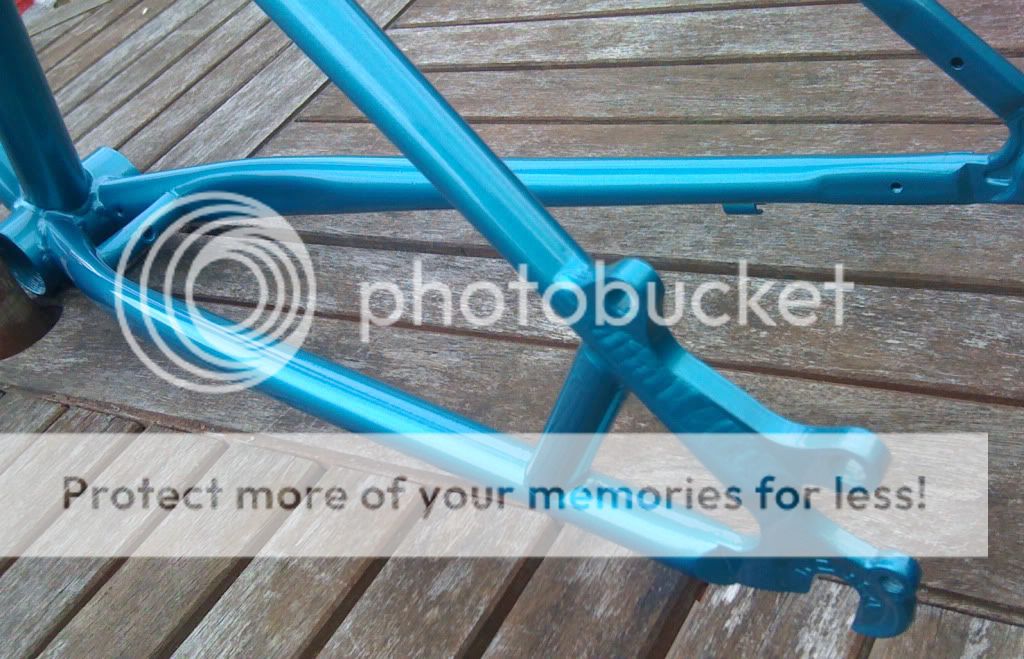

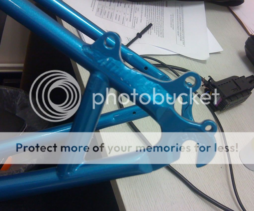

Back from the paint shop... they've done a great job but I don't know what it would cost to use them however Lee at http://www.brockhallcoachworks.co.uk/ did the work. I was so tempted to go down the white route but it's been done a lot so I've tried to get close to the turquoise colour but wanted it slightly more metallic.

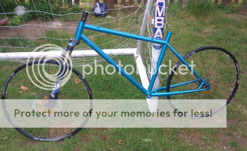

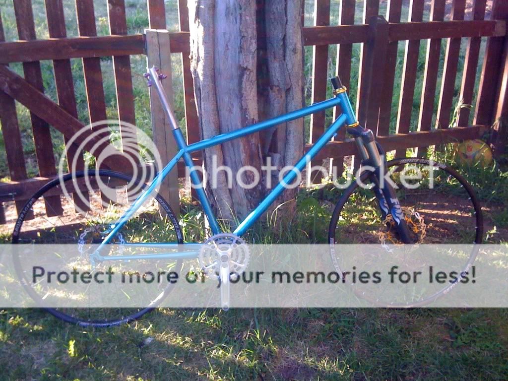

Not 100% sure on spec yet, but I've a fair few bits lined up. I was going for a set of SIDs however I picked up some Fox 32s with short travel spacers. If I like them they might be going white, although they look pretty bulky. We'll see.
I was going with my Hope mini monos which are black/gold, however I've never been happy with the rear and it turns out speaking to a lot of people in the industry that 'some' of that style mono calipers can have a lot of flex and very little bite. So I might fit my shimano white gold disks, again we'll see.
A closer shot of the disk mount:

The finish looks superb, much better choice than white in my opinion.
The brazing (?) for the disc looks surprisingly heavy, although on those skinny seatstays I imagine it wasnt easy. I'm not sounding critical I hope, as I am impressed with the work, but the photo makes it look as if the disc tab isnt in line with the seatstay as well?
Please dont think I am being critical, just curious. Nice to see you give it a new lease of life and well worth it over a On One like you say.

Thanks for the comments, it is a lovely finish. The disk tab isn't in line with the chainstay, but then they never are... it has to be in line with the dropout. I think on most of the modern frames you don't see it so much as the chainstays are so much beefier or they run in parallel to the dropout and kink after the disk mount!

As per Coombers comment the disc tab does look a little heavy handed :?
Be interested to hear how you get on with caliper alignment etc.

I do think the disc tab brazing looks a little heavy, it's pretty wide looking at it flat on but it's not actually thick at the edges and blends in to the contours quite well when you look at it in the flesh... if that makes sense. Regardless even though it is a nice colour and I've got a couple of bling bits it is always more about function over form for me, once it's built up I don't think the brazing on the tab will even be considered (unless it fails which it certainly shouldn't!) :)

I'm sure it'll do the job, but the brazing for the tab is obviously way over the top compared to what say Dave Yates would do. Also the brace, which perhaps looks a bit odd because it's at a slightly odd angle, is way fatter than it needs to be. It could have been slimmer than the stay and still ample - I'm not even sure it was strictly needed as the Cinder Cone's stays aren't the lightest. People do usually fit them, but I guess as much as anything to counteract the weakening of the seat stay consequent on being damaged by super-heating for the second time in its life.

This is what Argos did for my double butted stays:

Yeah, that's lovely! I didn't want to stretch to argos pricing though. This one's not cost much at all, two dent fills, three cable tabs, brace and mount were half what Argos charge. The frame was better than free and the paint shop owed me a favour so I think it's worked out pretty cheap. If it was a 'nicer' frame then I'd have spent a little more but it's just a cindercone being modernised to be ridden.
