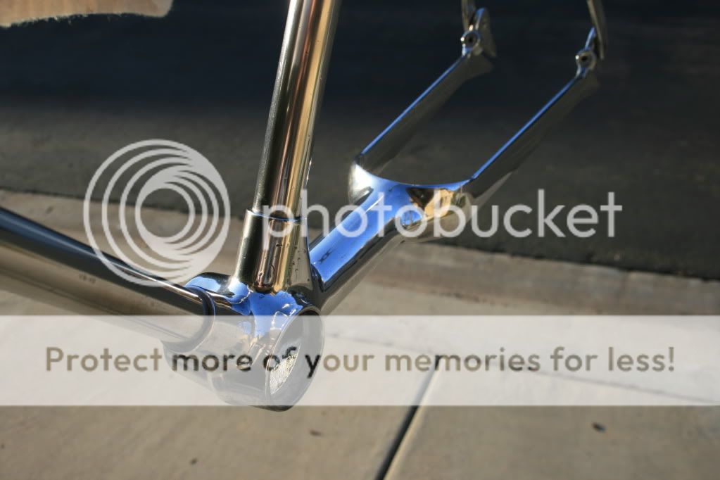

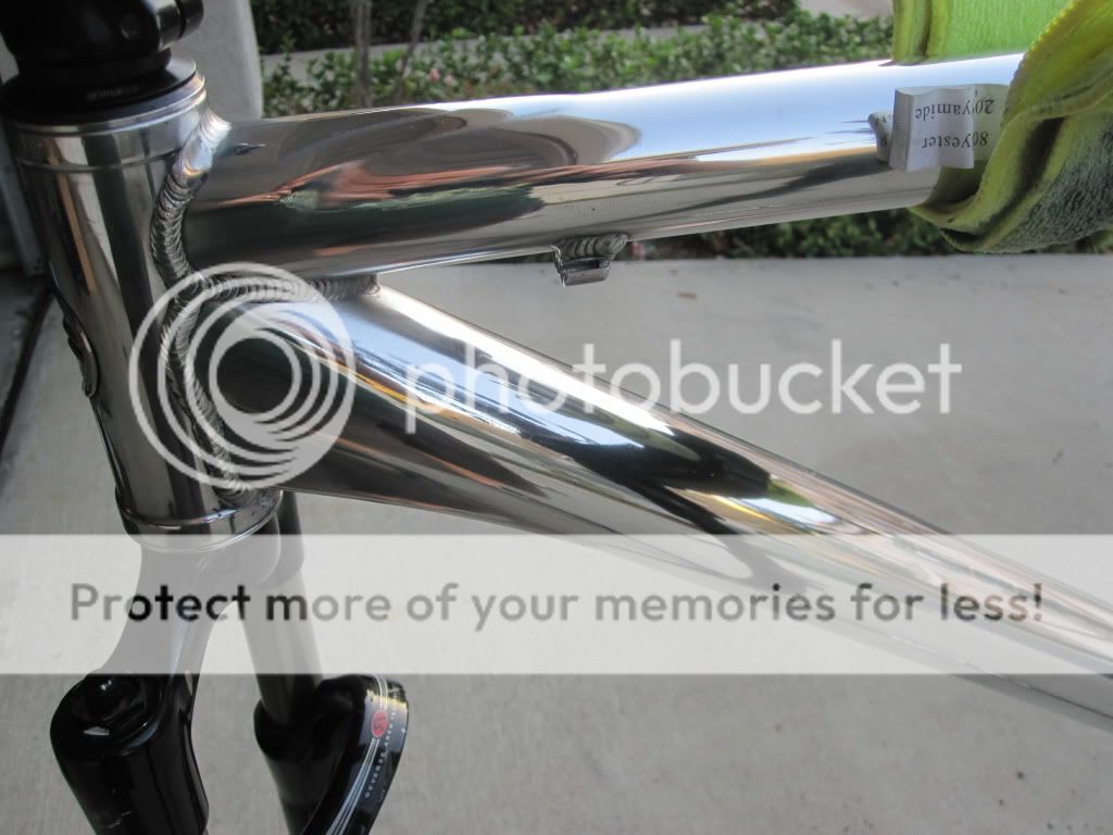

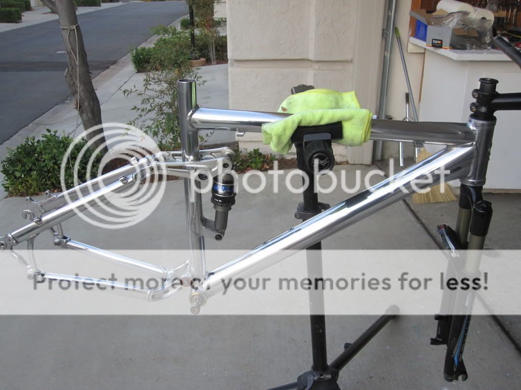

Zaskars frames are wonderful to polish because the alloy surface is nice and hard so it maintains a high mirror finish very well. Your frame looks great but you could easily take it to the next level if you are willing and have a polishing wheel.
I did my friends NRS as an experiment. The process starts with wet sanding from 600 to 800 to 1000 to 1500 to 2000 grit. Your bike looks pretty smooth so you could probably start at 1000 grit. After that I used a bench grinder with buffing wheels and buffed with fine compound and then red rouge super fine compound. At that point the mirror finish was there. I then just used mothers aluminum polish to stop oxidation and protect. After I used a product called liquid glass which is an automotive polish/sealer. It has not oxidized since.
