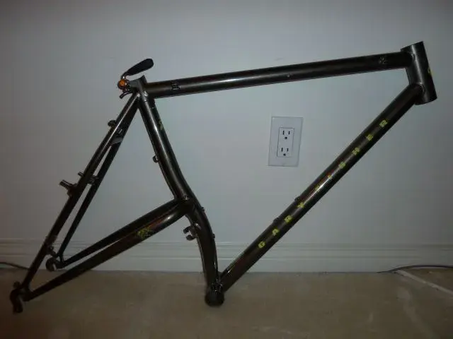

hi all
this ebay purchase off fellow retrobike member `incorrigible' arrived today. looks great. even better in the flesh. i now have the task of deciding what to hang on it. i will post pictures as i aquire parts and the build progresses. but to get me started i have some questions for people in the know out there. first thing i noticed is bottom bracket has no threads in it. what kind of bottom bracket do i need? and can anyone out there with a similar bike please tell me what length of spindle is required. better yet does anyone have one? next, what style of front deraileur do i need to mount on that bracket off the seat tube? anyone got one? should i go with some sort of cantilever brakes or upgrade to v brakes?
i understand this frame also requires a 1 1/4" steer tube fork. should i stick with that? or opt for one of the headset reducers available and go with a more standard 1 1/8" fork? well that should do it for now. sure hope people can help with knowledge and close up picture of the areas in question.
thanks
roy

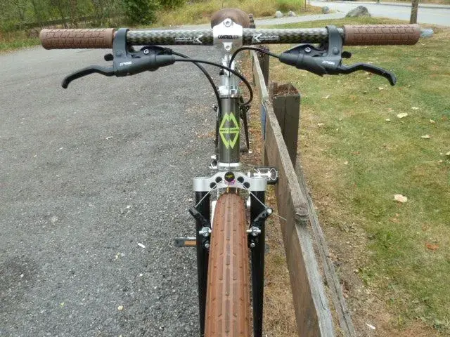

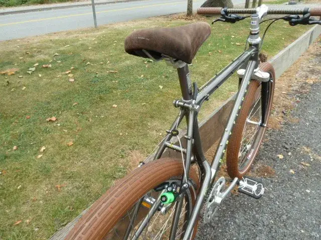

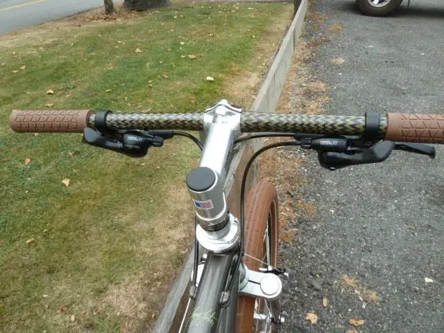

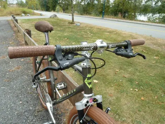

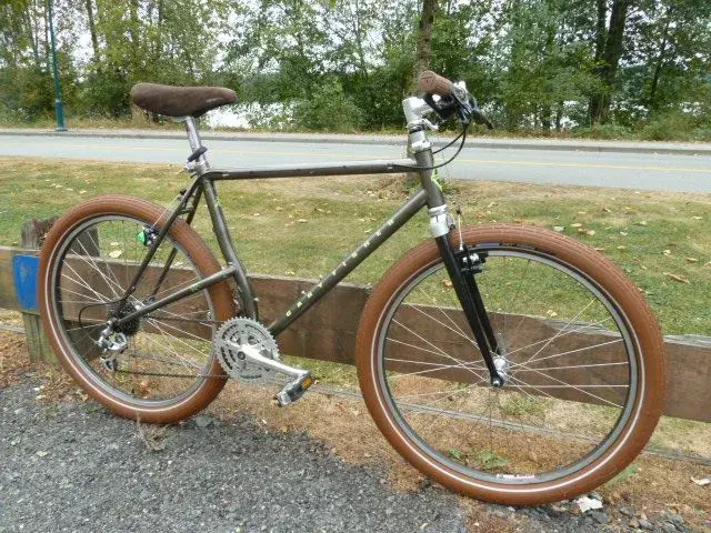

been a long time coming but here's my montare probably as
finished as it will ever be. unless i eventually fine one of
the elusive front derailleurs required for this bike. was
out on it for it's first ride today. it is an extremely
comfortably ride.
roy

hi
i purchased a headset reducer off ebay to use the 1 1/8" steer tube in the 1 1/4" head tube.
the seat post is annodized brownish/grey.
the rings have no identifying marks on them. rings and sugino gt crank arms
came off a very old nishiki bushwacker i parted out. i think they look pretty nice also.
thanks
roy
