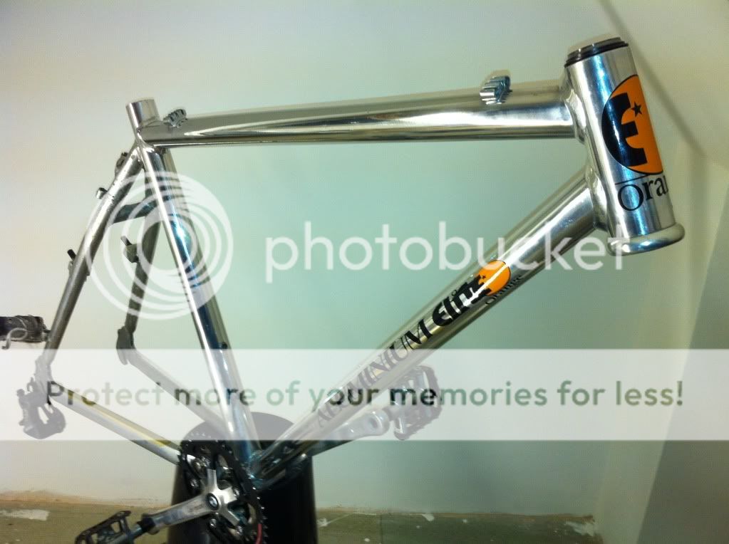

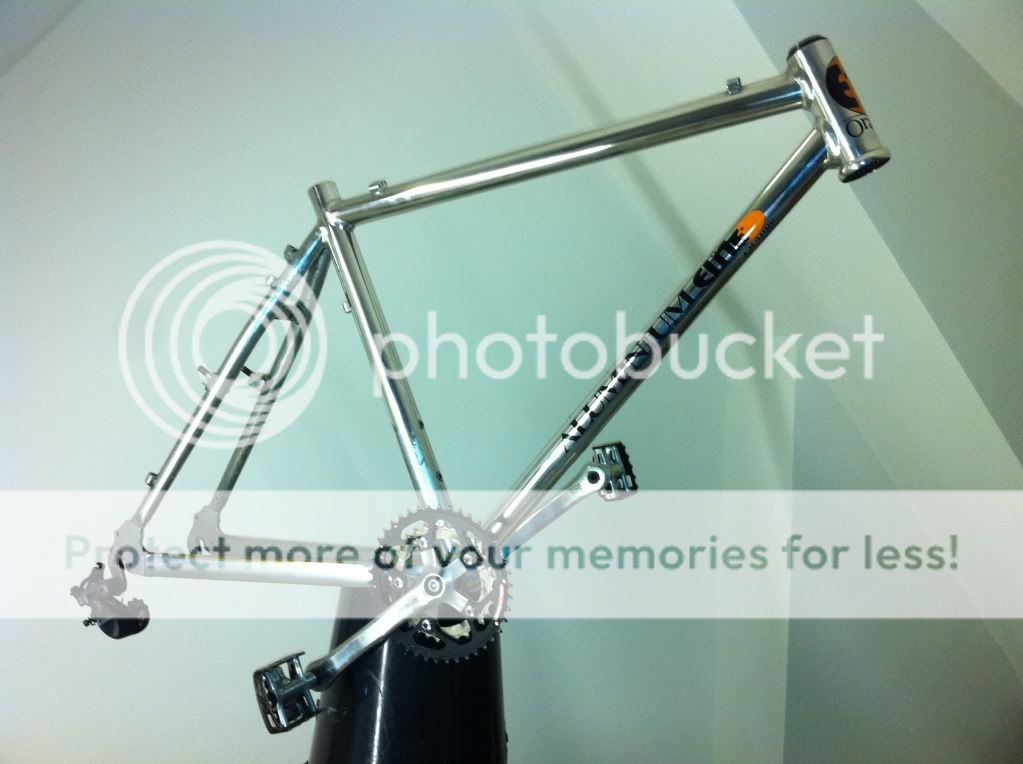

having acquired some lovely decals via the site (thanks Edd / brocklanders023) i've set to breaking the elite back down and polishing her up 8)
Here's a couple of shots after 2 days solid stripping and shining....(excuse the iphone pictures - SLR is flat!)
The finish is generally straight and with a true shine - it shows how little the bike was actually used in anger - much better than the photo's suggest. When i can find me camera charger i'll do some proper piccies.
and another for those not bored to tears by shiny bikes....
i've used a variation on boy-o-boys polishing technique (http://www.retrobike.co.uk/forum/viewto ... e&start=15)
I used paint stripper to soften the lacquer - it's generally two coats - wiped / plastic scraperred (?) the worst off and then an autosol dipped very fine (00-0 grade) wire wool to remove the rest.
This doesn't take away too much metal nor does it leave too much burring.
The occasional scrape and scratch were dremelled using a soft polishing buff. The technique I found best with the dremel was to wipe a thin smear of autosol on the area and then polish it black with the dremel. wipe and repeat as necessary.
I used polishing cloths - flannels and hand towels from the value Asda range - £1.49 for 2 cotton hand towels and 99p a pair of flannels. Hot wash (on their own :roll: ) and use again.
I've just got the rear stays to finish and we're rollin...

i'm a bit worried that after 4 days polishing i'm actually enjoying myself :shock:
I'm sooo glad I took the plungs and started shining. Althought the bike looked ok at first glance the yellowing of the lacquer really killed the finish.
Without being overly Ruskinian there's a lot to be said for honest patination just not when it makes your bike look naff! :oops:
A slight change of "build" too it's now going XC Pro from '92 and a new collection has started...
Proper pitcures soon.
