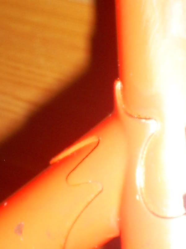

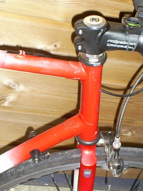

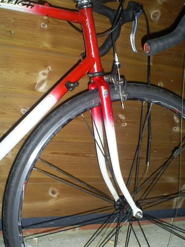

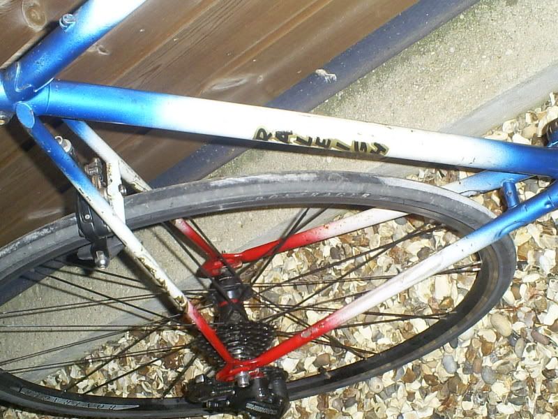

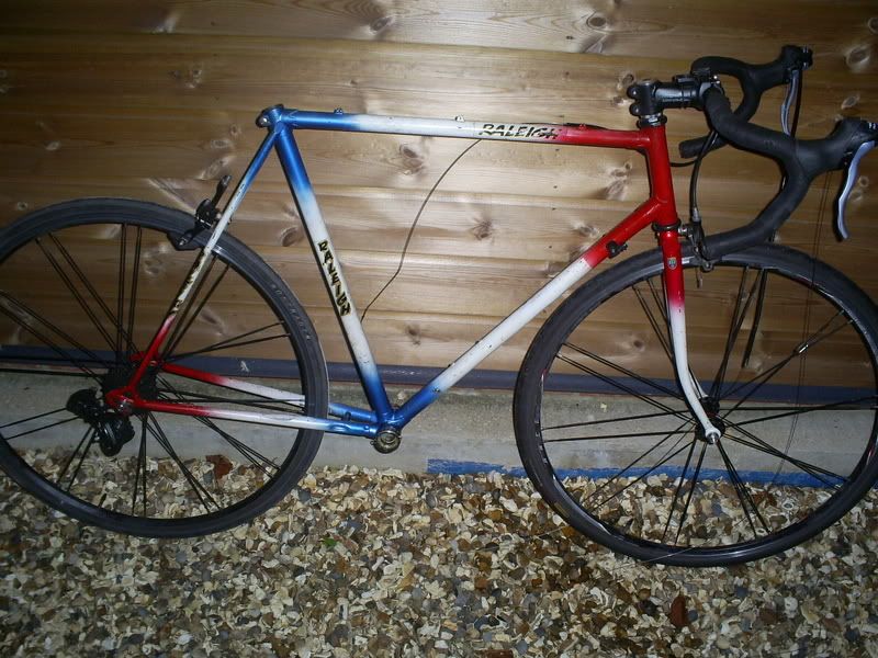

heres some more pictures of you, hopefully this will help!
excuse the really horrible build kit, its getting new ultegra/cx-rays/dt swiss rr1.1 ultegra+105 mechs and eventually a nice nitto bar, thomson stem combo hopefully!

Are you sure it's a Raleigh? The paint job does look a bit like a Quadra which was a model sold 1987-1989ish but it's not one of those.
The lugs don't look right and Raleigh lightweights from the 80's had "Raleigh" embossed in the top of the seatstays. If it's older than mid 80's then it can't be 653 - the early 80's "better than 531" frameset from Reynolds was 531 Professional. No Raleigh's used that tubing but a few Peugeots did.
I don't think the fork crown looks like a Raleigh either - they tended to have real or pseudo lugs with a triangular point.
Has it got a headbadge or the two small holes where one would be mounted?
finally, it may not have been a specific model. Raleigh sold separate framesets that had different paint jobs to the built up bikes.

it is a raleigh because picture 2, is a seperate picture i found on the internet randomly so there are 2 sepearte frames in existance with this decal/pain configuration, both made from reynolds 653. im not sure on the lugging or age.
Ive seen alot of lugged frames and yes i do agree that raleigh as far as i know never used 653 but then again i wasnt alive before 88.
The lugs to me look 70s but the forks 80s, and ive seen 531c, it looks very similar in frame/forks but still the lugs arent as fancy and the build kit upon that bike was 600 with shimano hubs/weinman rims.
It could as you said be a frame only kit which is a possible answer. i dont believe it could be a quadra if thats the release dates due to the bottom bracket cable routing. but i could be wrong.
