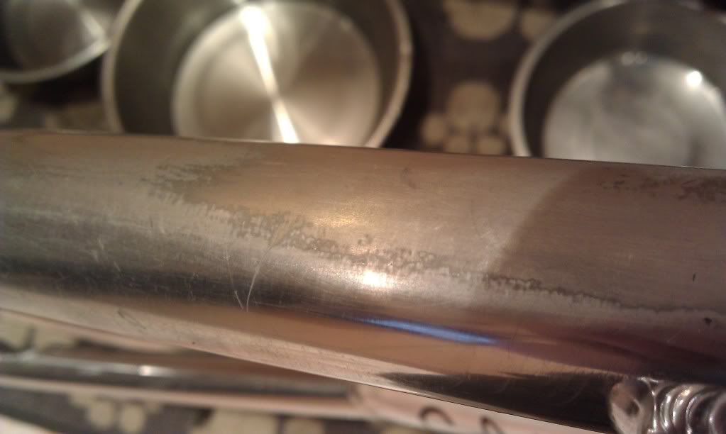

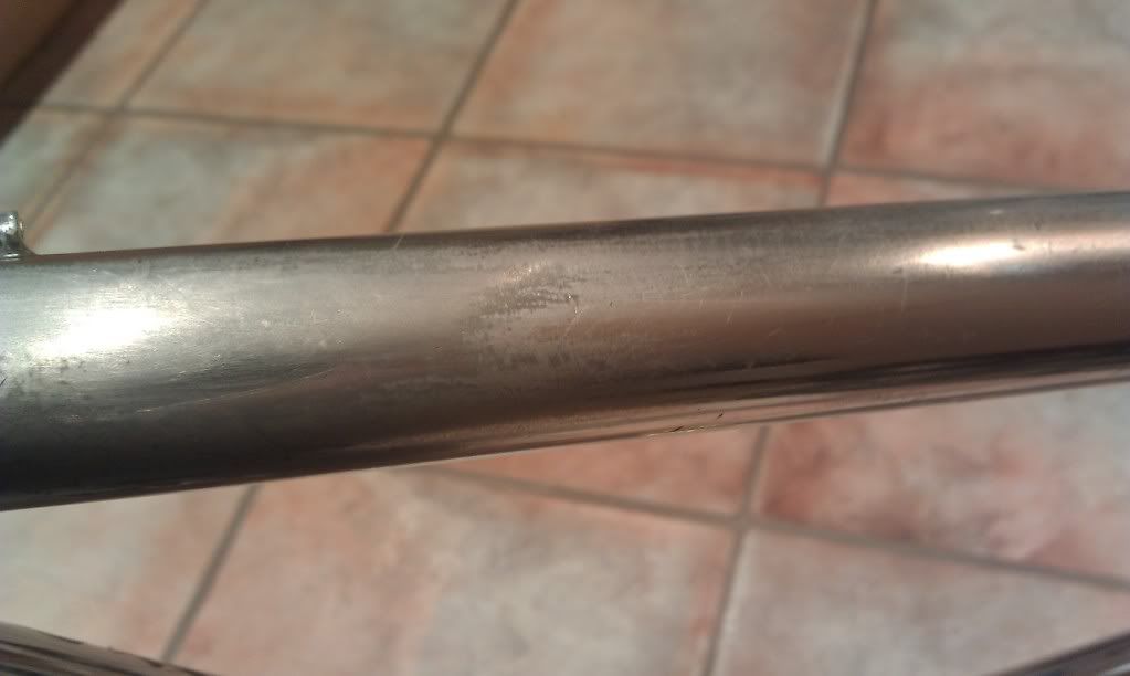

its time to start the smokestone ,microfiles and 1000's wet n dry , i filed all the little nudges down whilst checking for cracks every thing going to plan then :shock: seems my smokestones has a layer of something on her. it doesnt look like paint nor any thing like an electro type plating ,could this be the effects of ballburnishing ? any help would greatly be apprecaited,

Clear coat probably - try a small amount of paint stripper (nitromorse or something similar) on a small out of the way area for a short while and see if it comes off OK.

^ yeah that was my first thoughts but i leaves the wet n dry papers and excess water and my autosol ragg black, clear coat is usualy light its like its been dipped in alloy ?

looks very similar to what happened when i started cleaning up my nickel plated P7, that was lacquer over the plating, i'd imagine that yours was ballburnished then lacquered and that is what is coming off.

it could be chemical brightening

whats this mikee i havent heard of that before, its proving very difficult to work with im considering paint :?

its a sorta chromate conversion coating but not quite
it will polish off ,but best bead blasted loads of stuff is done with this
it looks great till it gets polished off ,usually cable rub or similar
try your local metal finishers they might advise best procedure

cheers for the info lads , yes mikee its rubbed through in the usual places i will look into getting it re done im also tempted to have it painted/powdercoated ive seen a black one in the archives and i think it looks pretty swell imo,

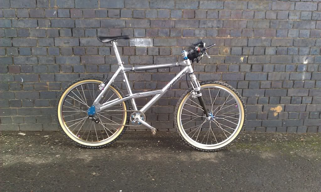

That's one hell of a lovely looking e-stay you got there. looks very 'race-orientated' in that top pic... yum. 8) 8)
