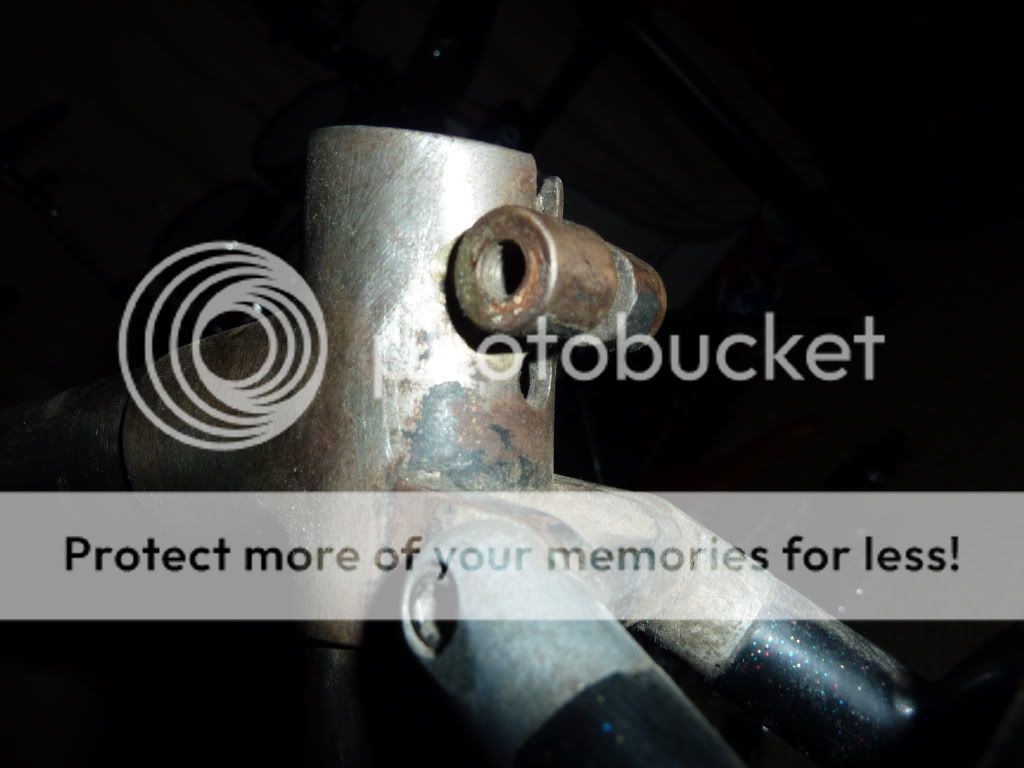

a couple of points to take note of is that i read that allot of dynatech owners say all there lugs are alloy strangely on mine only the head tube and the bb shell is alloy the seat lug is steel ,
rusty steel lug

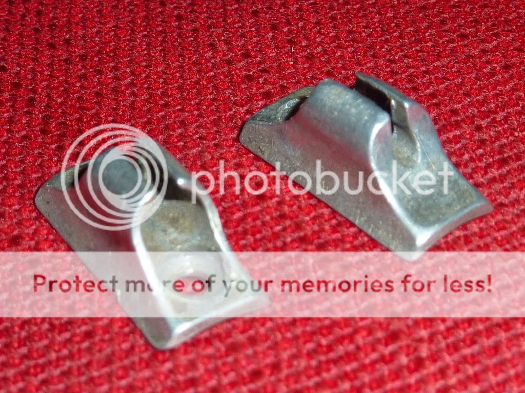

the second point is that there are riveted bosses for the top tube routed brakes ,i have not seen it mentioned when iv been browsing so here are some pictures to explain what i mean ,this may give away its year
the holes for pot rivets ! :shock: :lol:
and the brake bosses :shock: :lol:
it dosnt sound too great does it having pot riveted brakes !
this hapened when i was stripping the paint ,i must have broke the seal of the glue , the rivets held but they where always loose and could snap any moment but they never did thankfully , so this leads me too my next question .

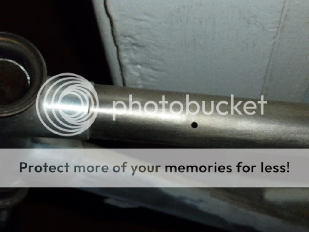

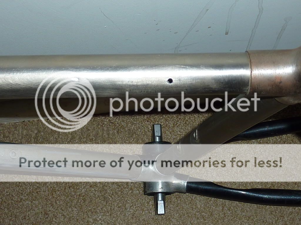

ideally i wanted to polish the entire frame/forks and laquer it but last night i found a hole in the seat stay (4mm x 2mm) that must of happened in one of the crashes i had (it looks like there is a crack coming from the hole ,this is just camera trickery thank bejesus)
its not gonna look good when that has been filled so i may have to paint the back triangle , any ideas how to repair a hole like that ? i thought of back filling it with a bit of expanding foam and then body repair resin but any other suggestions more than welcome

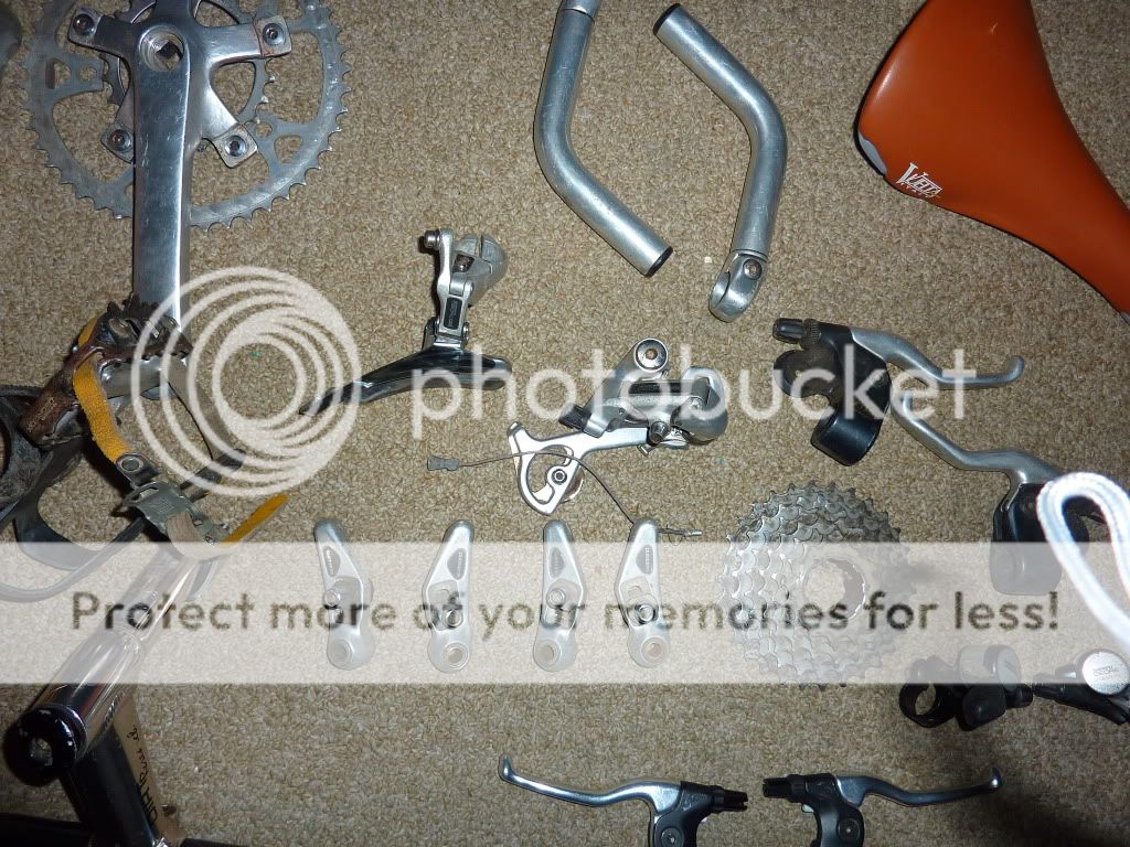

for the components i am going to use xtr m970 throughout , i scrimped and saved to buy the bike as a teenager so the second coming is gonna be pimped up somewhat

Regarding the hole, I would say that a piece needs brazing in, that hole is quite a percentage of the circumference of the tube.

brake cable bosses, loctite 414 and countersunk pop rivets will do the job.

That's exactly where my MT3 developed a hole. And there's no way that's being repaired to ride again.

I'd be pretty confident that the cable guides for the rear brake can just be riveted back on. A dab of Araldite or Loctite 414 in addition could hurt I suppose.
But as dbmtb says, that hole in the rear stay is a major problem. If they were Cro-Mo stays like on the MT-3 then a frame builder could probably repair it with a brazed on patch or sleeve fairly readily. It'd be ugly though.
The MT-4 has a Ti rear triangle though hasn't it? You'd need to find a Ti frame builder to see what they think, but either way just filling a hole like that is asking for trouble further down the line.

the seat stays are magnesium molybdenum so they are steel
do you think the back end will fold up on me ?
i see what you mean about it being ugly with a chunk of steel stuck over the top of it , maybe i can fix it with some steel strength putty they manufacture
il look into it
i dont wanna see this baby die ,2 days ago i ordered a full xtr m970 group with hubs to go on it , because the back end is black all this time i hadnt noticed the hole, dang
