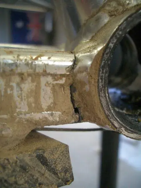

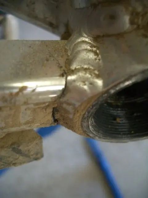

More as a 'public service notice' - this is where to look when buying a RC200 / RC300 frame - I've now got two broken ones :(
Here are pictures of both, both broken in the same place- on the join between rh chainstay and BB - my afair with the square tubes is over :(
I'm 72kg and try to ride 'light'... keep an eye out folks.

All Ally rigid frames will do this in time/miles this was the thinking behind Raleighs MT frames, utilising steel lugs, as this is where the breaks occur at the welds, while still retaining the weight benefits of Alloy/MM/Ti. 853 still has to remain the prefered choice for mtbs, as it is stronger at the weld and no heavier than alloy .

Steel is an alloy. When you say Alloy you mean Aluminium.
Titanium and Steel have very long fatigue lifes and can normally only be killed by rot or one heck of a bash. Aluminium has a finite life. The M-Trax and Dynatech frames were steel or Titanium with one or two exotic exceptions so steel lugs wouldn't offer any additional life for these materials.
The reason for bonding these frames was that some materials become weakened by the heating involved in brazing and so have to be stronger near the joins. If there's no brazing there's no weakening and so a thinner gauge can be used nearer the ends of the tubes.
In terms of these Pace frames - they look fixable. It'll be ugly, but it can be repaired.

You can't write off all aluminium frames on the basis of a couple of manufacturers who didn't get it right. There are plenty of broken steel frames aswell but people don't put up pics of these and say "I'm afraid it's pictures like these that reinforce my decision to only buy aluminium/titanium/carbon (delete as applicable) retro frames".
There are lots of great aluminium frames out there, why deny yourself the pleasure of owning one? :)
