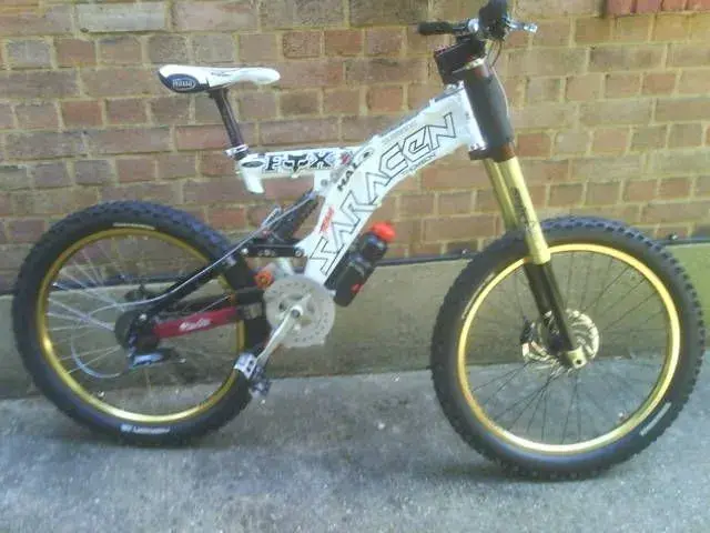

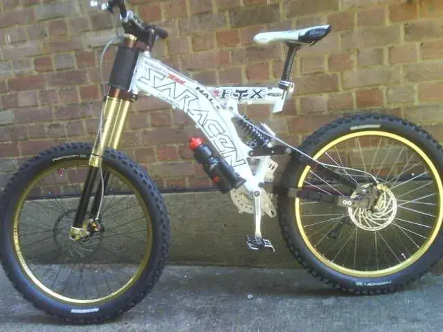

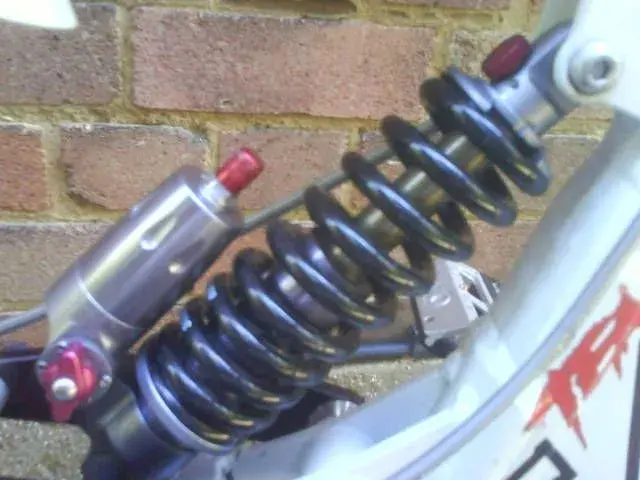

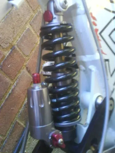

Hi Guys and Gals OK i need a bit of help please if you can,now i know this rig is not old school but it's what i use to be a weekend warrior but something is driving me crazy............The rear suspension unit creaks like a b****rd and i can't work out what to do.It is a STRATOS HELIX X DH PRO LOCKOUT suspension unit sitting on a RISSE RACING swingarm and the bike cost me a few thousand so its annoying to hear it creak.Any ideas would be fantastic because this ones got me stumped ??.

Is it definitely the rear suspension unit and not bottom bracket or cranks?
Are the bushes worn on the swingarm? Do they need lubricating?
Are the bushes on the shock worn/need lubricating?
Is the spring rubbing somewhere? Spray it with WD40 perhaps at the top and bottom to eliminate this.
Has to be one of the above really unless there's an internal squeak to the shock. Is it still under warrantee?

pull the shock off, remove the spring, clean all contact areas with the preload dial & base, add a little grease & re-fit.
it looks pretty clean, so this may not do the job, but a dirty spring & preload dial is what normaly makes em' creak.
