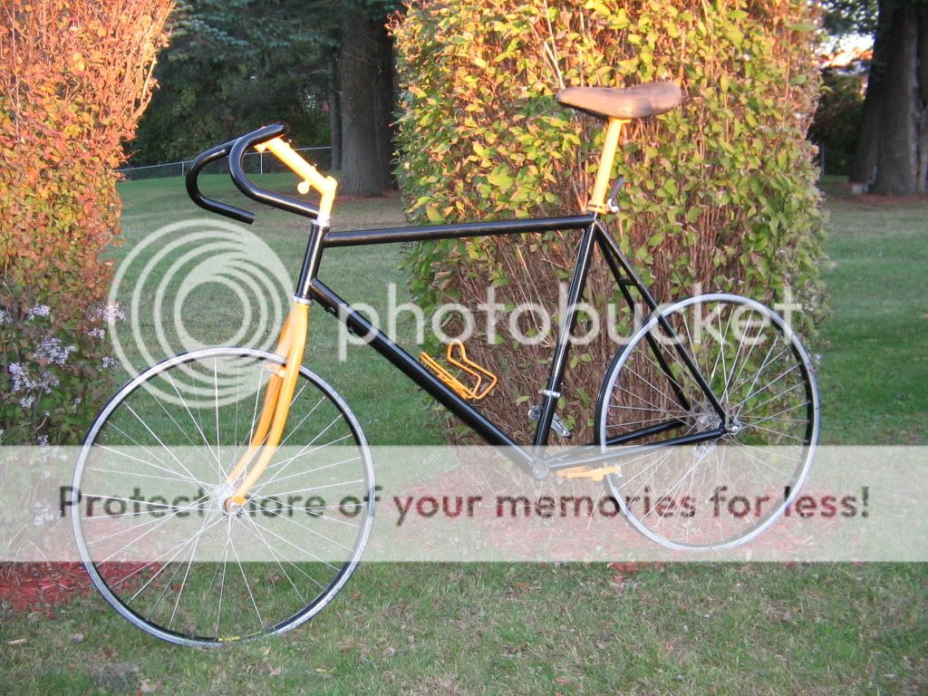

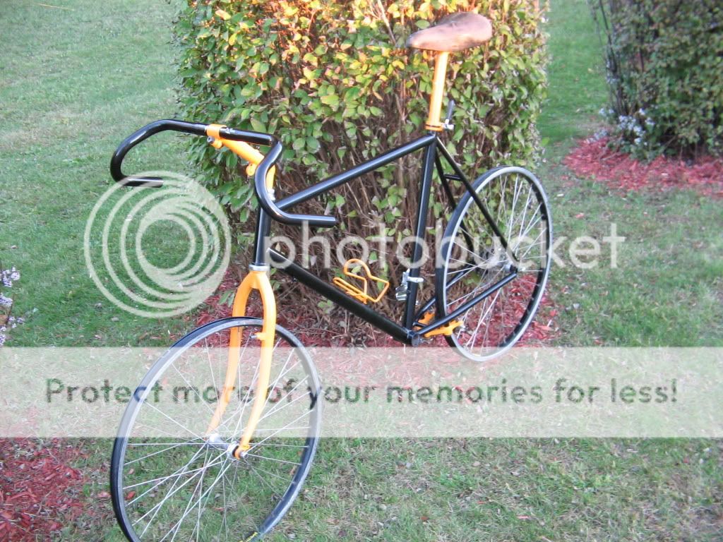

So I powdercoated my old Fat a couple months ago, and after staring at the stem for awhile, I decided to grab a set of Origin 8 'Gary Bars' from ebay, and see what it would look like with a dirt drop setup-I bolted on a few other parts, so it at least looks like a bike. I like it, but can't decide if the stem has just a bit too much reach for drop bars.
Anyone care to share an opinion? I'm not married to the dirt drop setup, just wondering if it looks right.

Is that your normal saddle height, or is the post just stuck in for the pic? I love riding drop bar mountain bikes and I always set the drop to be almost level with the saddle to keep me in the drops comfortably without being hunched-over. Being bent over is great for aero on road bikes, but just doesnt work off road..at least thats what I have found. In the end its really all about you and your size and how you fit that set-up. That looks like a pretty big frame and the extension on that stem puts it out there quite a bit. If you are a big person that has a long torso thats probably good, otherwise maybe too much reach? Those must be the newer version of Gary bars. I have a set of the older ones and they have a much shallower drop. If you lowered that seat a bit the bar to saddle orientation would work better in my opinion.
One rule of thumb I stole from someone a while back is to measure between the middle of my saddle and my grips on a bike I know fits me well and is comfortable. You can take the same measurement from the middle of the saddle to the drops and see how close you are. They should be comparable.

These pics are just for reference, and what works for me is not necessarily what works for anyone else so take my info with a grain of salt. Do keep in mind though that these bikes got ridden on every singletrack trail I ride a conventional mountain bike on, and I never had trouble keeping pace through the rough stuff with my buddies on hardtails and FS bikes. The key for me is having the drops of the bars high enough so I am not leaning my upper body weight fully into the drops. The drops become a command center where you spend most of your time. Sorry for the long reply.
Awesome info, and thanks for the input and the pics. Your tips about saddle height in relation to the bars are a big help. My arms and torso are reasonably long, so the reach on the stem isn't too much an issue. The seat post is just stuck for clamping purposes on my workstand, I forgot to lower the saddle a bit before I took the pics.
I think the saddle ends up somewhere just above the height of the bars, so I might be able to make it work. What you said about the drop portion not being too low makes a lot of sense-especially with that stem, I don't want all my weight over the nose of the bike. Crank arms/pedals would be a big help in getting the setup correct-I need a fresh press-in BB spindle, so that's on hold for now.
Interesting about the bars-they look shallower in the ebay listing, but I think they sent the correct ones. I'd prefer less drop, and the curve is a bit tight. I can see from your pics that my stem isn't unreasonably far forward, that was my primary concern-the Bridgestone pictured is about what I had in my head for a proper looking setup.

Hmmmm, the stem does look a bit long, but I'm just starting a drop bar build, so can't speak from experience. Abit shorter with a bit more rise seems like it would fit better.
