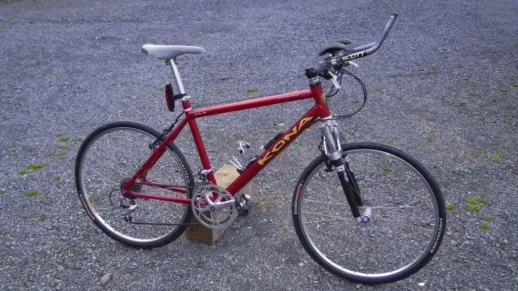

A lovely pair there, the AA looks especially tidy. I'm doing something similar with a Cinder Cone at the moment; can I ask you, did you face any problems mounting the road cranks (e.g. chainstay clearance of the big ring)? What length BB spindle have you used?
I used the existing BB (shimano) with the new Campag Chorus crank. The previous crank was also Campag but MTB specific.
With both cranks there's a bigish gap (index finger fits easily) from the shell to the crank arm/spider.
Italian cranks (square) have a smaller taper than Shimano and therefore do not slide fully home on the BB shaft. Ie Italian to Shimano is not as good as IT to IT or Shim to Shim.
The upside of all of this is that the greater off set appears to work better with the MTB frame as the clearance of the crank arm to chainstay is neither excessive nor too close.
I'm cautious of pedal float and ofset, as my knees are loose and if out of line can give some pain. No real problem to report with this setup.

Nice rides... But I'm slightly partial for the explosif, with the tiny cromo tubes and the green color... And I think it's better fitted with an flat bar instead with the riser one...
Interesting you say, because I swapped the original flat bars from the explosif to the AA!
