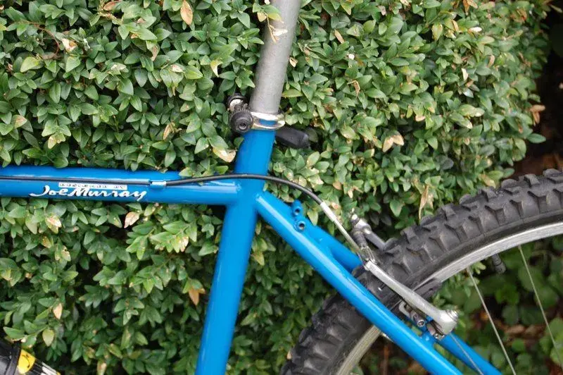

Thought '91 models had Canti's with the dog bone seat post stop collar? yours has a V brake stop, was this added later? :? Also they had captive seat clamp bolts not collars. more like a little later version? Nice whatever though.

Not thinking of changing kit at all really as still purring! Think I'll wait until I break something although wouldn't mind finding an original Kona 165 handlebar and get the old X-lite bar ends back on :)
Right on all counts on the technical although was an earlier plastic (useless in my opinion!) version of dog bone collar. Back in the 90's I tried to keep it up to date as best I could so got it changed over to V brakes which meant getting a cable guide welded on (see photo) and at the same time I had the fixed seat clamp cut off as often caught leg on rather over sized quick release. Never found a simple bolted collar that fitted though until recently - saw Salsa has a good range of sizes so thinking of getting one if I can find stock (black or silver I think). Need 30mm dia taking measurement roughly unless anyone knows differently.

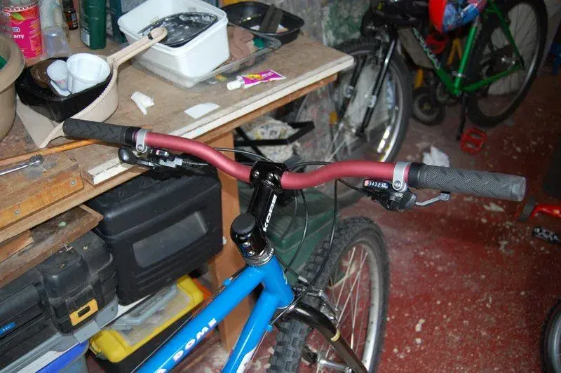

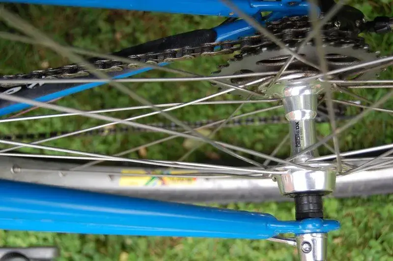

....and continuing on the list of changes made to the bike (mainly due to the destructive nature of millstone grit mixed with rain found wherever I rode in the Peak District during happy uni days!):
- wheels upgraded after squaring originals with Mavic 231's on DX hubs

- whole 'flight deck'! STX headset after the Impact headset became too notched, Kore stem with quill adapter, Azonic bar, 'V' levers and STX (I think) 7 speed shifters as 500LX started playing up in first couple of weeks. Ran DX thumbies until they started dying. And finally some free-with-a-mag grips!
