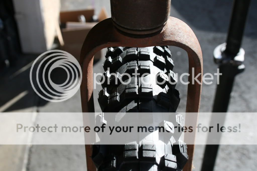

Like many others I started riding off road on the trails of North Carolina on a 26 inch cruiser so I have always loved cruiser style bikes. I always wanted to do an homage to the Marin county Repack pioneers, I just needed a clean canvas to start with. I found it on Craigslist for practically nothing. Heres what I started with:

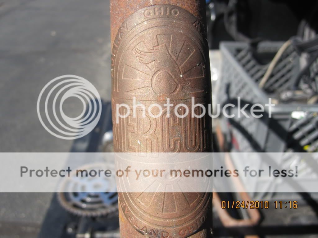

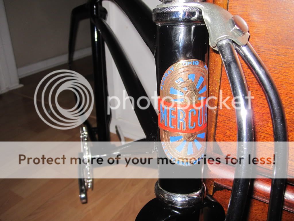

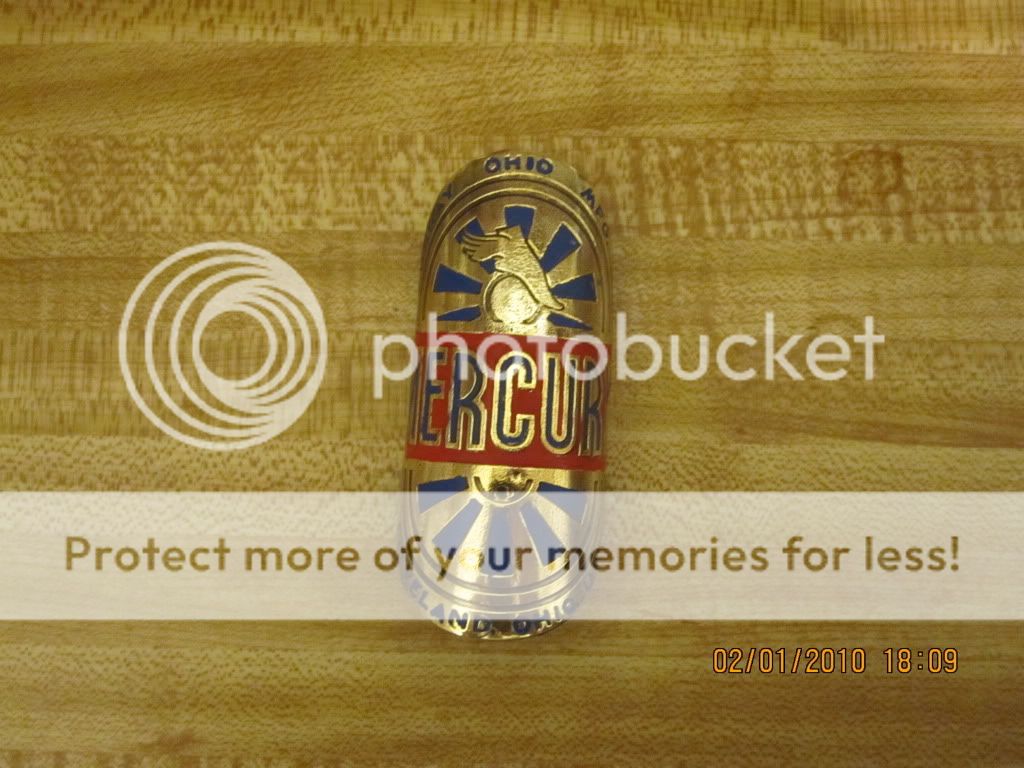

I knew I wanted a bike that would be a rider, period correctness would not be a consideration. First things first, had to clean up that headbadge:

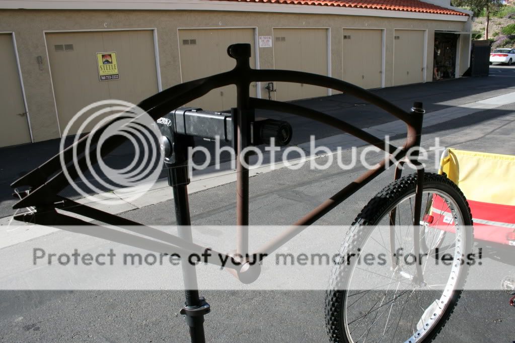

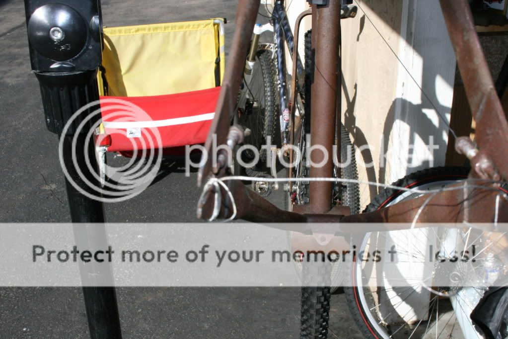

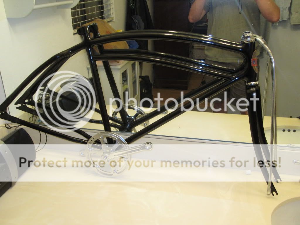

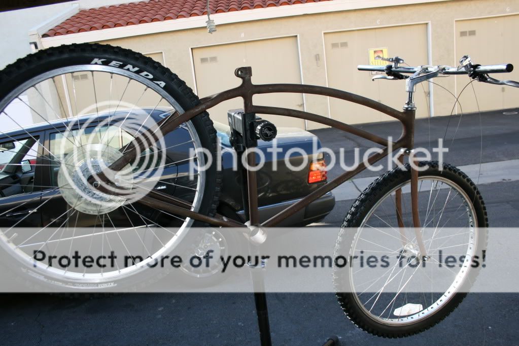

Many months of research began, I knew I wanted gears, I saw a bike called clunkenstein on clunkers.net. It had a modern internal geared hub with a roller brake and a suspension fork. At that point the path was chosen. Here it is during test fitting and cold setting the frame and alignment.

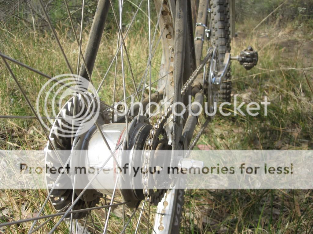

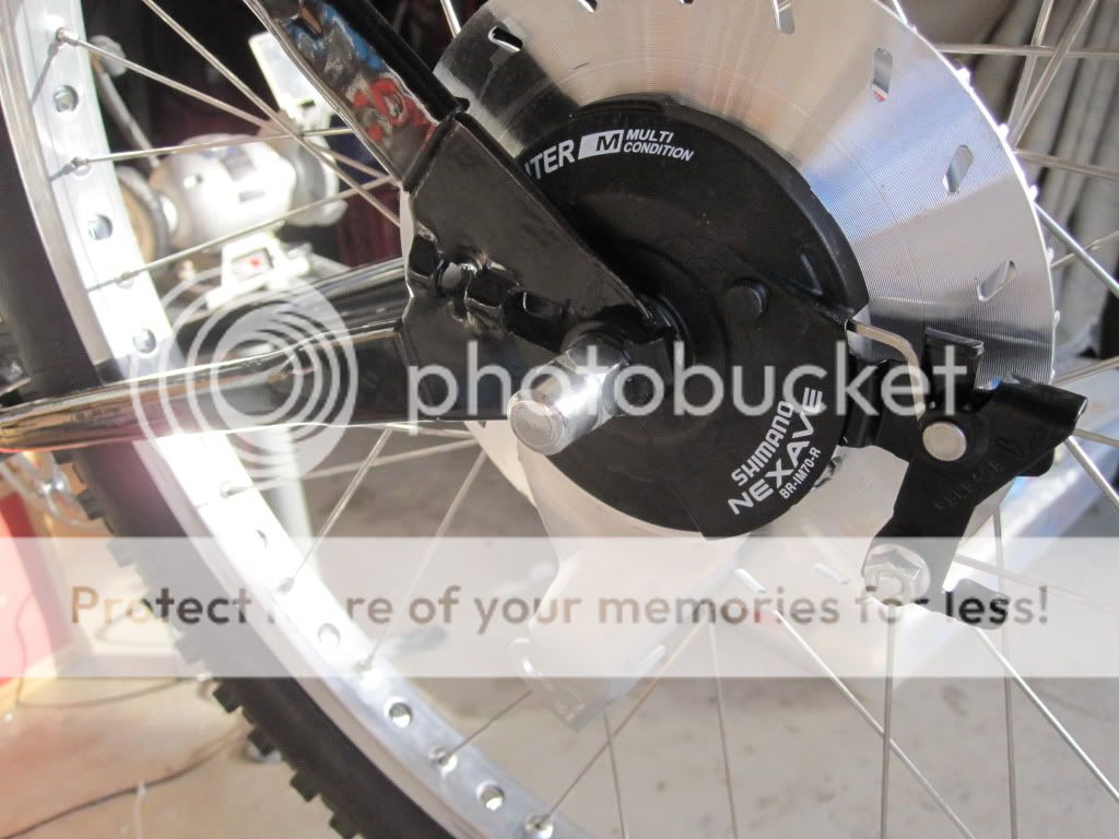

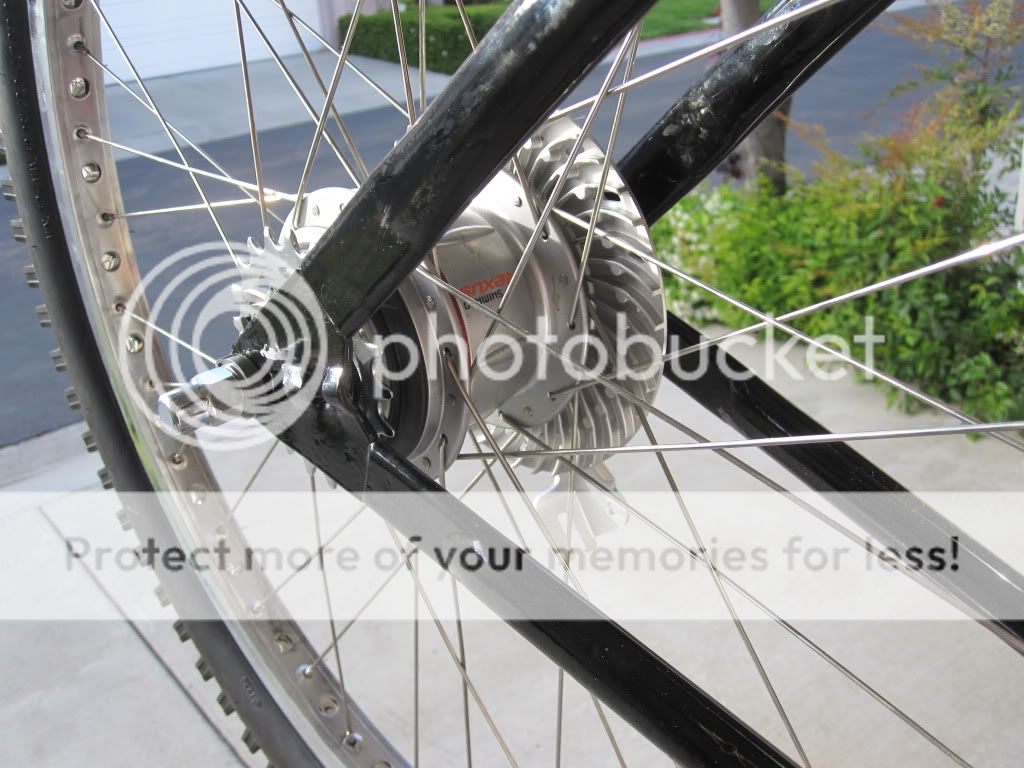

Nexus 8 speed hub with roller brake

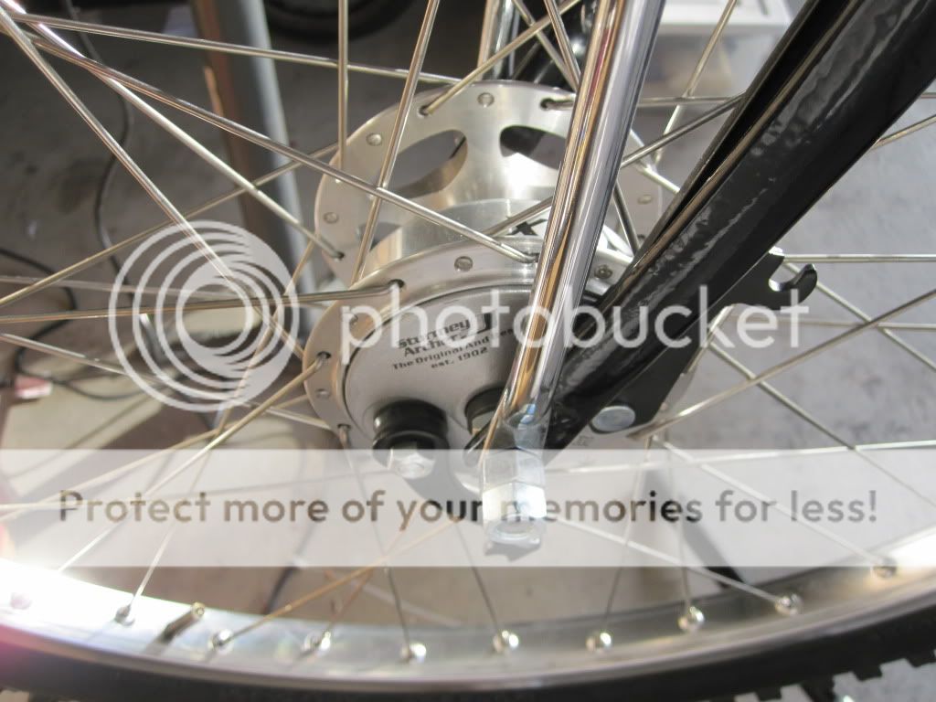

Sturmey drum brake up front

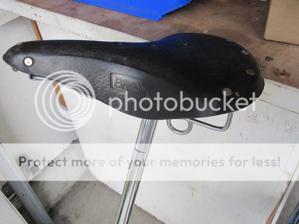

Brooks Saddle

There were plenty of challenges with fitting new parts on the old frame, the BB bmx adaptor had to be milled to fit along with the 13/16 aluminum rod seatpost, I went through 3 forks, 3 headsets, had to cut and mill the truss rods to fit but it all came together after 7 months.

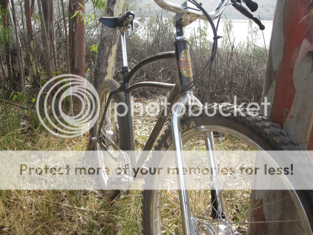

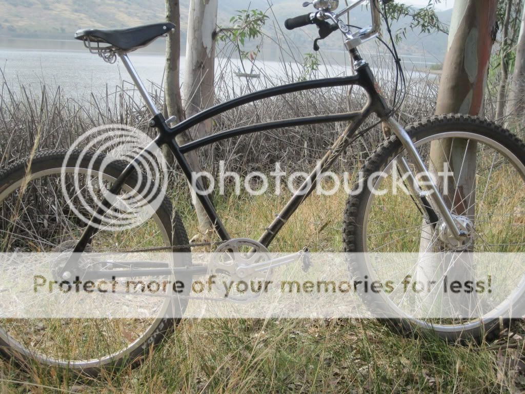

I ended up going with a stronger fork because the original had a bent steerer. I have since located a correct replacement and I will be going back to the forged fork and truss rods but here is the current configuration.
I have been using this bike as my daily commuter for 3 weeks. I must say it is the most comfortable bike I own. Nice upright position and great gearing with strong braking.

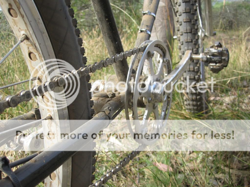

And every now and then I get her dirty.

Yep, it gets ridden every day, 7 miles to work on the street and then 9 miles of dirt through my local canyon on the way home. It weighs over 40 pounds but you wouldn't know it. The Nexus shifts very smoothly under pretty heavy load so the bike actually climbs very well and it is very steady and predictable and fast on the way down. The low bottom bracket means I get perfect leg extension so I can really put the power down and it makes the center of gravity low so it handles and turns great. The big tires are the key, plenty of cushioning and the Brooks b-17 is a great saddle.
