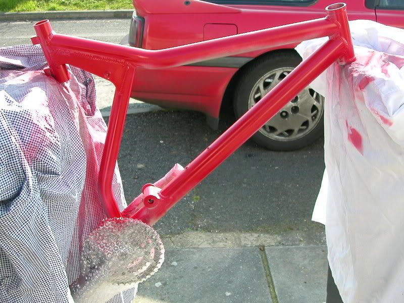

Figured I needed somewhere to stick this up.... Am in the progress of rebuilding my old Proflex 957. I took it to bits 2 years ago as the frame started going seriously nasty.

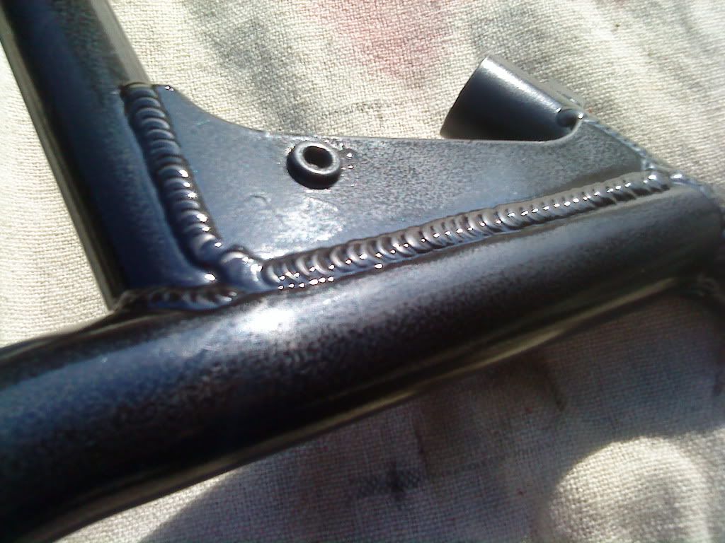

Started off by sanding off what lacquer was left.

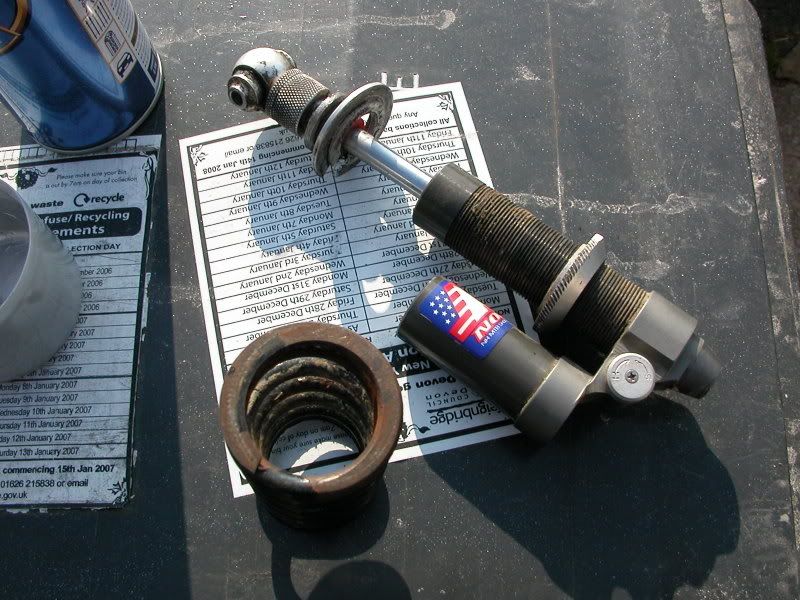

Rear shock taken off and spring removed to tart up

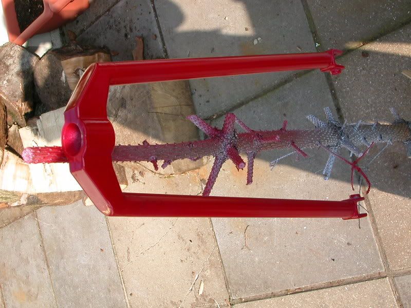

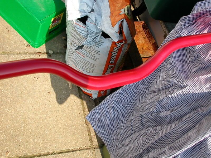

My first attempt at painting was definitely going for "impact"....

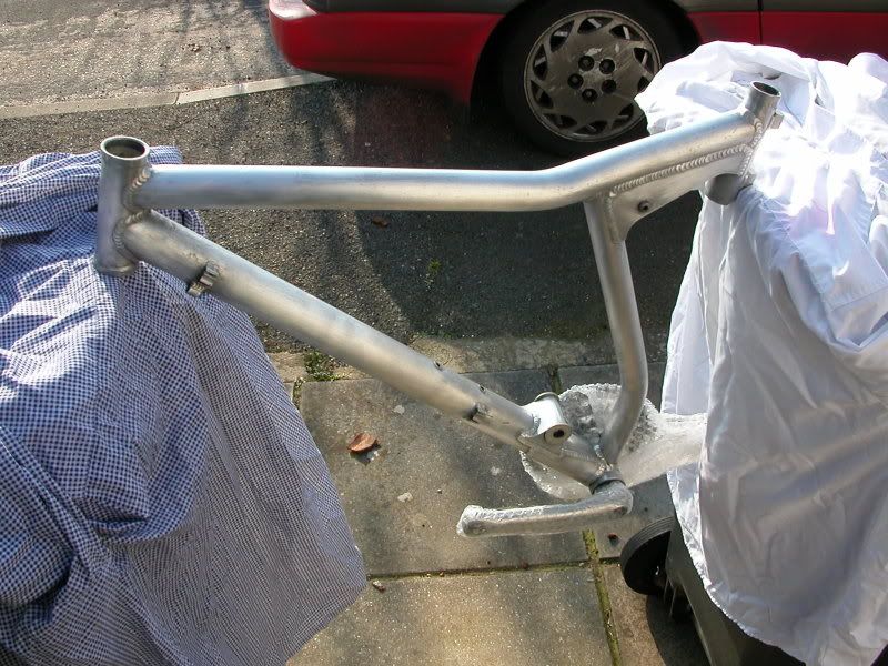

Now the parts lay around for 2 years getting scratched, and so this weekend with it being nice I decided to have another go.... Started off sanding all my crappy paint off again and this time ensuring I use grey primer :D

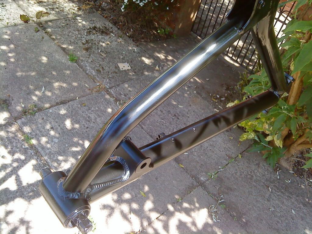

And now they have been given a couple of coats of gloss black, then dusted off with some VW black magic metallic paint. I will leave this overnight to harden off properly, and shall start lacquering tomorrow.
I have some replacement gearing and am aiming to re-use my Pace RC37 forks as the bike was awesome with them. Shall be retaining the XT V-brakes as well.
What I shall need though is a good value/quality 1 1/8" headset. Any ideas? May have found one now. :wink: I will be after some original proflex stickers if that is possible too.

Glorious weather today has allowed me to get two good layers of clearcoat onto the frame and parts. Starting to look good and leaving them to bake this evening and tomorrow in the SERIOUSLY nice weather we are having in Devon at the moment. :)
Tomorrow evening I am planning on starting the wet & dry process. Starting with 1500grit then 2000grit, and polishing up using the dual action machine polisher I use for my car detailing. 8)

Well, its reached that stage where any other newbie to painting would go "WTF have I done?" Nice scuffed looking surface following a thorough session with 2000 grit wet & dry.
Going to grab some dinner then doing some polishing. Was a bit gutted though as it looked like the swingarm had not taken enough lacquer on - Couple of rough areas. So I have given that another coat tonight and will have to polish it tomorrow. The frame, rear "fork" and the handlebar should come up good this evening! :cool:

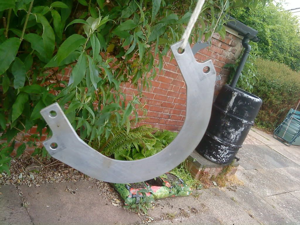

So, I took a look at the RC36 and once the cobwebs were blown away I realised how bad it was looking. Removed both crowns/braces and decided I would refurb those. Sanded down with 150 grit and now have a layer of grey primer on. Not sure whether to go black like the rest of the bike or perhaps try a little silver.....
Sanded down roughly
With one layer of primer

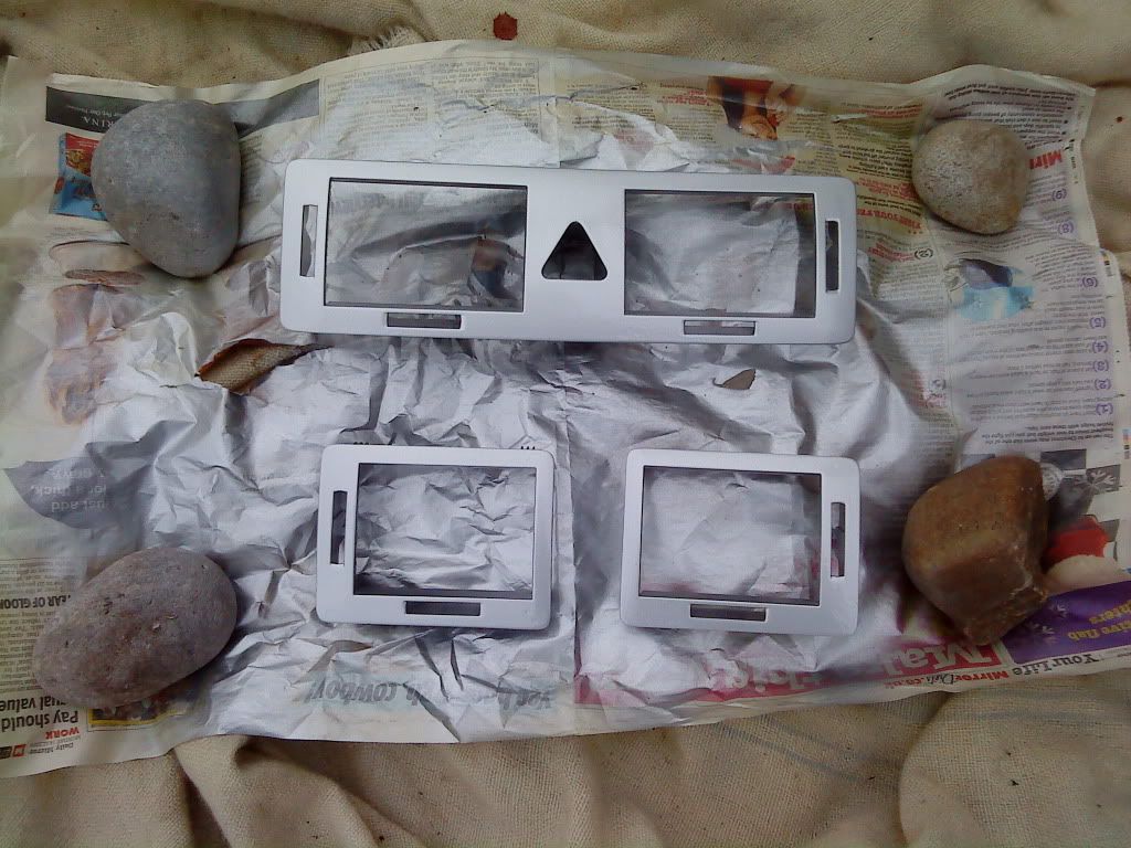

And if anyone is bothered :D have been spraying up / lacquering my dashboard vent surrounds from out the fabia. Previous attempt had gone quite wrong so ensuring I get it looking right this time.

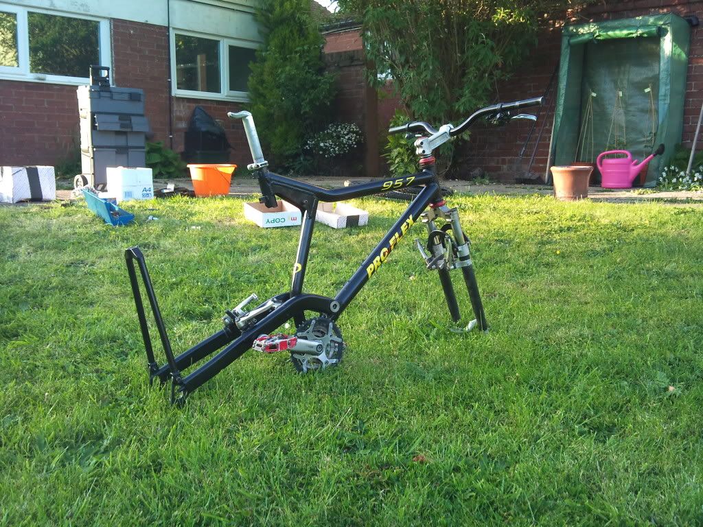

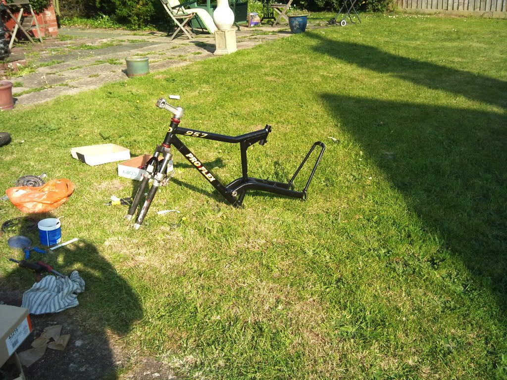

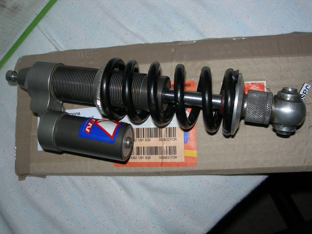

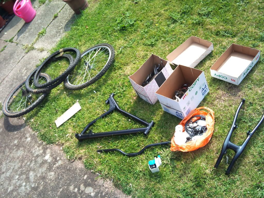

Well, have FINALLY decided to try and get this thing back together again. New proflex sticker kit courtesy of a member on here and tried to build it up as much as a I could. Noleen NR2 shock needs re-working/re-charging, suspect the PACE forks will too. Need a pair of rims and 8 speed cassette too as old ones dodgy (unless you can re-coat mavic SUP ceramic rims...?)
Started off with a pile of rubbish in boxes / loose.... Glad I had room to spread out a bit
Bike starting to come together slowly
And finished for the day. I am determined to be riding this by the middle of Summer!
The offending Noleen shocker
