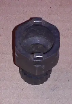

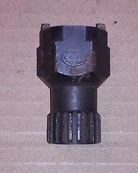

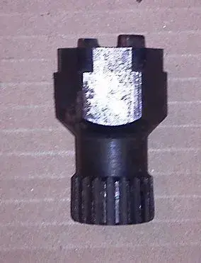

Hi Quizzer
I think this is a Cyclo version of the Regina tool and has both types of Regina remover :wink:
It is a swine to photograph properly :oops:
Make me an offer if you are interested :wink:

PostPosted: Thu Jun 28, 2012 7:33 pm
Joined: Fri Oct 14, 2011 8:41 pm
Posts: 9122
Location: Cumbria
http://i.ebayimg.com/00/s/NDAwWDM4NA==/ ... ~60_35.JPG
just out of curiosity will that remove the Regina ORO BX series of freewheels as above?
Shaun

"just out of curiosity will that remove the Regina ORO BX series of freewheels as above? "
Hi..Yes i think it would.
It has 20 splines and the Regina oro has 20 splines and the diameter seems to be the same. Not sure but i have not come across another Regina freewheel with a different diameter and requiring a different Regina removal tool apart from the two pronged type.
Regards..Quizzer
