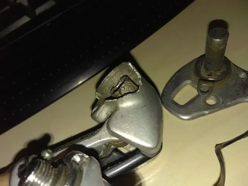

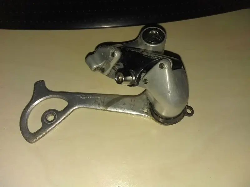

Thanks guys, with a lot of effort and tools I finally managed to pry it loose… but alas, the aluminum body is now cracked… It feels like a bit of a waste, but the amount of rust that came of out the body was insane; it was like someones literally drowned this bike. Replaced it with a modern derailleur so the bike now is usable again. Thanks again!
