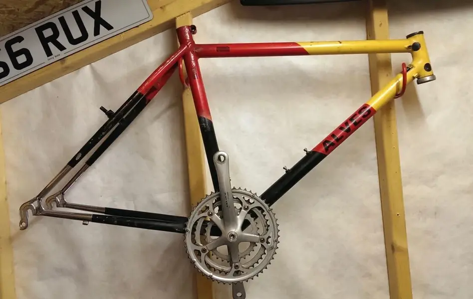

I used to use the older of my two Alves frames as my road/training bike many moons ago.
26 inch wheels with slicks, flat bars with bar ends and tri-bars, campag triple road chainset and a teeny cassette!
Was superb, didn't have to keep up with anyone to compare 26inch wheels with 700c, but it hoofed along just fine with a 53-11! 8)
edit: i just used my mtb spd pedals, worked perfectly and meant i could hop from bike to bike.
cranks look huge! :lol:
