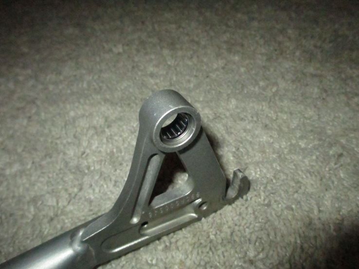

So far i have installed the needle bearings at the A-links. i've centred them as much as possible - using vernier clamps and a home made bearing insert tool (socket set and bolt/washers). took me 5 minutes :) the o rings sit perfectly.
Pics:
next is to get the nylon washers sorted and the bushings.

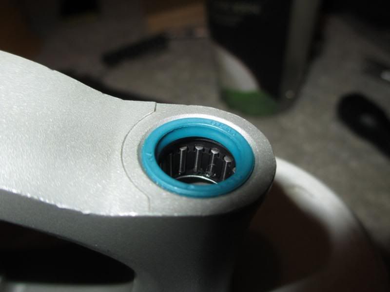

Also added bearings to the shock link:
For those interested, i used a simple socket head, bolt (used the one that holds the shock in the shock link) and a washer and nut to guide them in:
First problem:
nothing major, but the O rings i ordered have come up small - cross section not big enough (2mm) have ordered some with same ID (11mm) but with a 2.5mm cross section. this should do the trick :) one at the top of the pick wont fit properly.
UPDATE: Got the right O-Rings :)
Needle Bearing seals fitted to shock linkage - these needed a 3mm recess to fit flush. go too far, and you'll need to pull your bearings all the way through and start again! so gently and slowly does it! luckily, i got it spot on both times :) and they sit perfectly flush and right up against the needle roller face (with possibly just a smidge exposed to help create a nice seal when the washers sit over it): these were easy enough to install by hand (used a tiny bit of grease) and pushed them in using a socket with my fingers to apply the pressure evenly.
Top of seat stay bearings complete with seals installed. pics later :)
