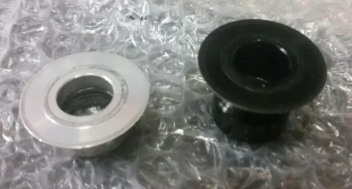

The answer is probably yes, but are you sure the end caps are correct? I could be very wrong but are the xc end caps supposed to work on the bulb hubs?

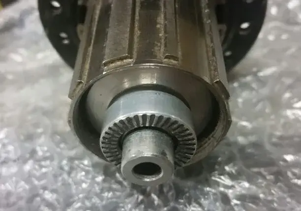

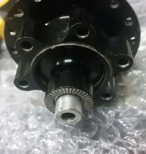

Here's a pic or two of my bulb rear for comparison.

You are correct ishaw they are different (and my bulb ends are the same as yours) and it meant I had to spread the frame ever so slightly but it had the same effect as soon as you put pressure on it tightens up with what sounds like rubbing on the non drive end cap.
If you had to splay the stays, it sounds like the end caps or bearings haven't gone in to the correct depth in the shell.
