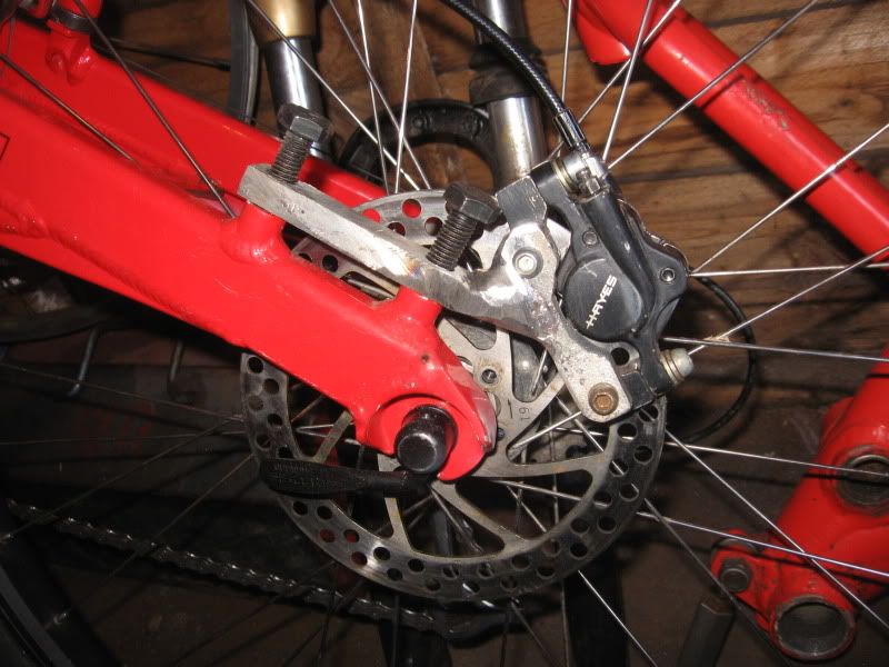

Thanks Doug, sorry for the delay in replying, been away. Got the backing plate sorted, made a template and got one made to fit, works spot on :) only thing i`m stuck on now is a rear brake mount to fit disc brakes to her, proving harder to find than the backing plate unfortunately :(
You mean one like this?
file.php
For this type of swing-arm with it fitted.
file.php

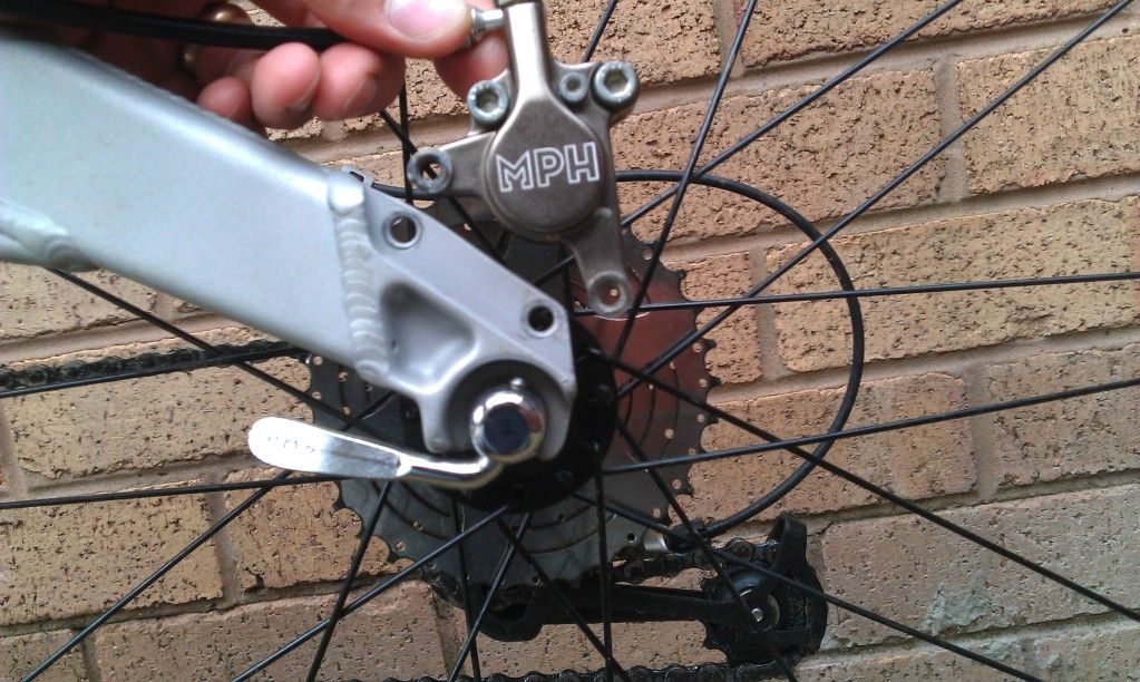

Big eck, one of my fellow MacRetroBikers made this one
I'm in the process of trying to make one but stalled at the moment as I don't want the caliper (a Shimano post mount) to be hanging off the back like on the Marin one.
The inserts needed for swing-arm mounting holes (instead of using big bolts that Marin adapter uses) are the same thread as rim/v-brake studs, just cut off the v-brake mount part so it is flush with mount on swing-arm and then mount the adapter with the v-brake fixing type bolts as there is an internal thread. Although on the studs I have that thread doesn't go all the way through so will have to run tap through them.
Mine`s different to that one i`m afraid, it looks like the IS fitting but the hole centres are either 38mm or 39mm. I think it`s the same swinging arm as the riftzone of the same year
