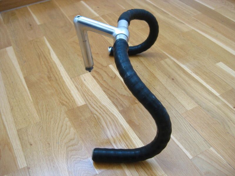

I'm trying to rectify this:
Rectify?
TBH, That's about as good as it gets. Anything else you get will be similar.
Yep.
3TTT Record stems have deeper angles than Cinelli, and Nitto do a 90 degree.
Usually they are between 72-75 degrees.
I managed to get hold of a Cinelli Oyster Stem that is far more relaxed, but now I have a 2 vintage 3TTT record stems knocking about, one being NOS!!!
I don't know the old 3TTT stem range, but could that be a track specific stem like the Cinelli Pista:
The standard road 1A was 73 degrees, the track one only about 65 degrees. That would give you an 8 degree forward slope. Looks about that.
