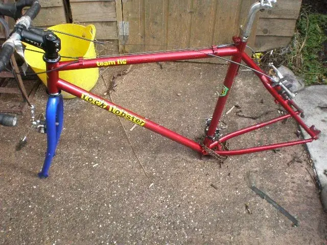

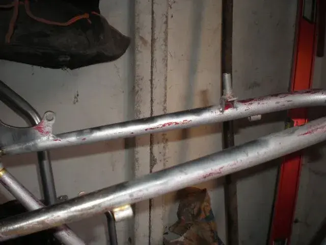

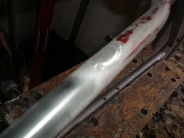

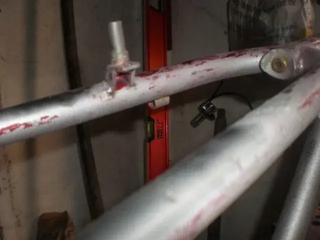

one or the other :roll: one thing i dislike on a frame or forks is v brake bosses and disc brake tabs together, one or the othe makes things so much neater on a build, it just looks all wrong when your running disc brakes on a bike and have the v bosses sticking out looking like they dont belong, so this brings me to my new build ( 2002 rock lobster 853 ) equiped with disc and v so ive decided the v bosses need to go to give the rear end a much cleaner look, and running more modern disc only rigid forks in place of the forks that were on the frame when it came into my hands first time round , a little dressing of the weld now and then ready to remove the other boss :D

clean :D nice job hope mine come out that clean when de bossed 8) how did you get the final finish :?: emery cloth :?:

Yes :D
WD Pro wrote:
These are the steps I took to remove the bosses ...
Dremel with cutting disk :
Dremel with sanding drum :
Note to other owners - get some grease / Waxoyl / spray oil behind the canti bosses ... :-(
That's as far as I would dare go with an electric tool :-)
Wide file :
80's and then 120's :
Other side :
Both done :
WD :D
Check page eight of my yo build for a bit more info :D
