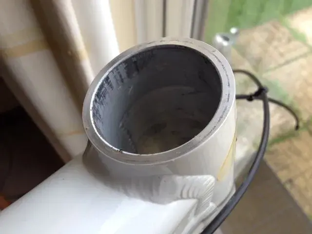

pics of the headtube top and bottom

Now I'm no expert on this, but I've gone through a similar head scratching scenario with a frame I have kicking around. Based on what you've said, and the details and photographs here ........
http://www.santacruzbicycles.com/en/highball-alloy
........ I think that the OEM headset is a Cane Creek two-parter - 10.ZS44 top, and 10.EC49 bottom:
http://www.canecreek.com/products/headsets/ten
Regards

44-50 looks like a ZeroStack-Traditional...see Page 9 of Cane Creek's OEM headset guide.
Also general, if a bit confusing, guidance with the Standard Headset Identification System (SHIS).
Should be able to find something out of the Cane Creek and Chris King Mix 'n' match approach.
