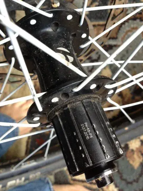

BUT...when I changed the rear wheel for another (albeit a 26"!) the creaking stopped! My thoughts are now that it could be the freehub on the rear wheel...it spins quite stiff but with no play, but does sound a bit grawnchy when listened to close up. How ever I have a big fear now that the freehub looks like an integral part of the hub!! Therefore not sure that I will be able to just change the freehub and it might be a whole new hub and wheel re-build!! :shock: The hub is a Bontrager rxl and the number on the freehub is FH-68-P5 (see pics)
Any ideas if I can just change the freehub?
Doug

I doubt very much the fh is integral.
I recently remved a bont. Fh using large allen key i will pst back on the size
Removal id different to shinano as the key fits in from the non cassette side.
The fh was on tight and i suspect i crackex the hub so had to buy a new hub fom usa as it was rare 28h hub .... annoying to say the least.
