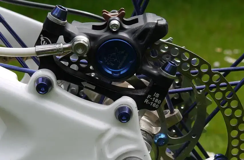

i am using Ti bolts got brake callipers and adapters as well as disc brake rotor, as indeed a lot of folks on weight weenies without issues. (I can recall one instance of a rotor bolt seizing but that is it). can't comment on v-brake usage.
Blue Ti bolts galore - see below. (the eagled eyed will spot the Al washers)
