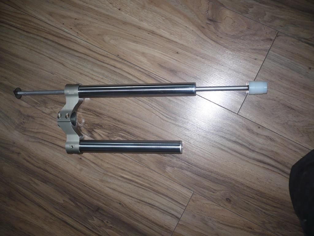

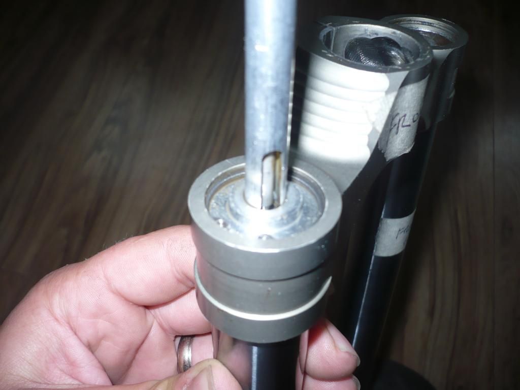

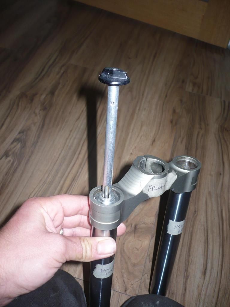

well ive been in the shed and had another go at the forks after reading the above link.
I managed to undo the adjuster at the top of the fork legs and pull out the damping rod so far.
It gets to a certain point and then stops.
There is a small opening at the bottom of the damping rod where if I pump the lower fork rod with the nylon bush oil will seep out, but I still don't know how I get into the main oil reservoir to change the oil.
Any help on this would be really appreciated as I have all the other components of the fork all cleaned up and ready to re grease and refit as soon as ive changed the oil.
Here is some pics of what stage im at to give an idea of what I mean.
Thanks in advance
Dale

You need to remove the circlip on top of that leg.
If you pull the adjustment knob out you probably need to use loc-tite or tin foil to hold it back in.
They are pretty easy to do. Tims sells all the o-rings etc. I think I just bought mine in packs from eBay! Replace the circlip things while your at it. The only hard (!) bit is you need a long torx(?) tool to remove the damper valve while holding the other end of the rod with mole grips or similar!
