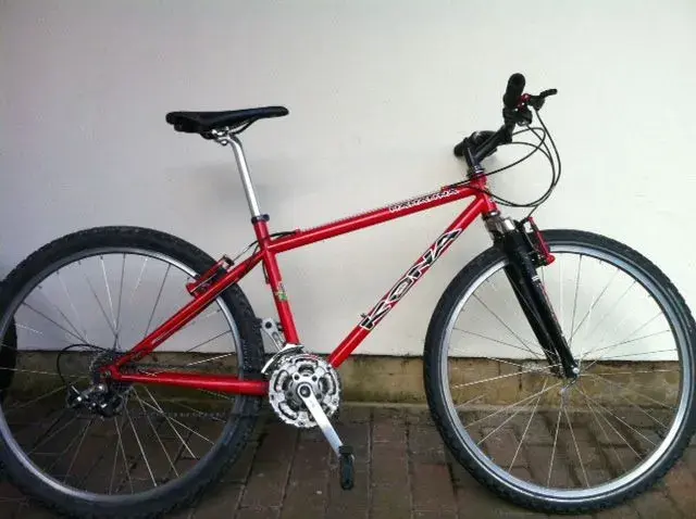

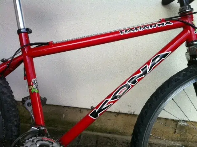

Bike is back from the service, with more problems than I'd hoped, but I'm planning on dealing with the fork first. I think it's actually a 1998 model. Seatpost and saddle are new, the last owner changed the handlebar for some reason, but I think the rest is original.

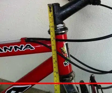

I've had a look on eBay to see what sort of offerings there are, and the other thing that seems important is the steerer length. Proving my ignorance again, what should this measurement be of? I did what seemed like the obvious one, coming out with 178mm.

The steerer measurement you're showing with your tape is approximately what it would be if you were using a threadless Aheadset style .... erm .... headset and modern stem. However, what you have there is an old school threaded headset/steerer combo with a quill stem which fits together in a different kind of way, so your existing steerer will stop near the top of the headtube.
I will leave it to one of the retro gurus around here to outline the forks options/parameters if you want to keep your existing headset and stem, as it's not really my strong point.

That makes sense about the steerer, unfortunately! There don't seem to be shorter ones on sale at the moment, but there is a 125mm one in existence which I think is probably what I would want.
