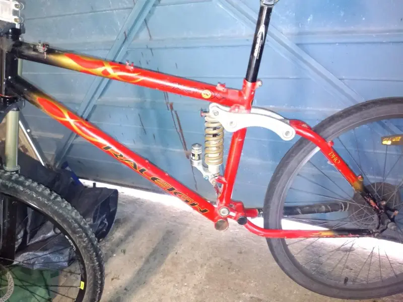

Hi guys,
Just doing a bit of reading up about my Raleigh DHO. Now she's a funny old beast. I bough it second hand form a guy who had apparently bought from Rob Jarman when he was sponsored by Raleigh. I got a black box Rockshox Pro Deluxe on there and the frame rode like a dream. I'm currently in the process of building it back up.
Now the bit that has me puzzled: The front triangle has 350 on it, and the back end has DHO. I assume that it's an RSP350 front triangle and DHO rear.
I'm just wondering if all are like this or if it's a team one off frame/prototype?
Anyone seen one like this before?
PS no need to comment on wheel etc, they're just stop gaps!!
Cheers,
Rich

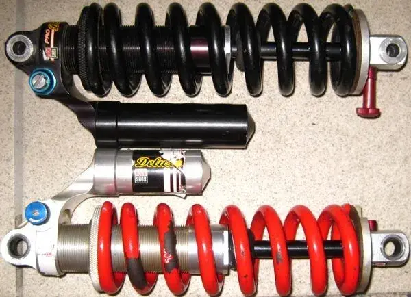

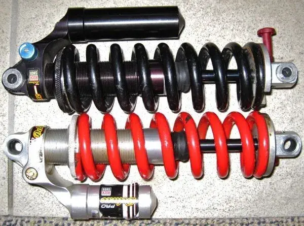

Great find, sadly thats not a black box pro deluxe, its just a standard RS pro deluxe from back in the day like 98 era they came standard on a few bikes like the Giant ATX One and others
I have 3 that have all gone pop as they are known for doing which sucks, I do have a super rare factory Rockshox Blackbox shock that cam off a Team riders Orange global 222 from the early 00's (see pic) as you can see the reservoir is longer and there is an extra adjuster (high speed compression, low speed compression and rebound) this is the shock that went on to become the vivid.

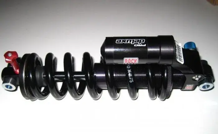

Depending on what size your shock is you can find them as I just got one custom made from new old stock, seen here

Hi thanks for that, yes no idea why i wrote black box it clearly isn't!! Pretty impressed that you managed to get a new one. The DHO shock is 196i2i with a 51mm stroke. The 3.5 to 1 leverage ratio is one of the reasons the shock goes pop, that piston is working pretty hard. I had this one TF Tuned years ago which made a big improvement. As for the frame it's a curious beast. Looking at old brochures the 350 had an aluminium front triangle, but this is defo steel (presumably 853 due to the thinness of the headtube). It also has a DHO size shock. strange...

TF would be good but I live to far away, I managed to get a brand new shock as I pictured, the guy would make you one up if you needed it, but your best to get a fox rc if you can get one in that size.
