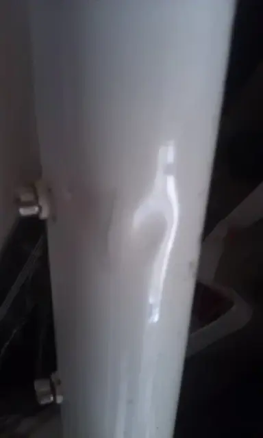

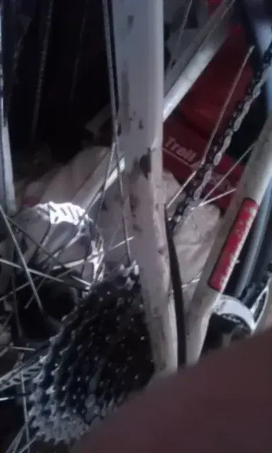

Had a accident in which I hit the rear triangle 2" above the dropout on right hand side. The steel tube is bent inwards by a couple mm and is about 4" long. There is another small dent (5 pence piece, 2mm depth) on chain stay about 1" from dropout. A couple other dents, 1 on seat tube and 1 on downtube. The frame is a charge duster, tange prestige steel. Is it worth anything and useable (repair the damage or going cost more than frame is worth)

ouch,doesnt look safe to me.. :shock: :shock: :shock:
PostPosted: Sun Jun 23, 2013 1:59 pm
Joined: Sun Aug 21, 2011 11:57 pm
Posts: 4187
Location: Antwerp, Belgium
Certainly not safe anymore. You'll need a framebuilder to look at that, and he might decide that the chainstay and seatstay need to be replaced. That would probably make it a write off indeed.
PostPosted: Sun Jun 23, 2013 2:08 pm
Joined: Sat Aug 08, 2009 10:12 am
Posts: 2036
Location: Brizzle
Oh, OK. EBay listing as spares or repairs?
PostPosted: Sun Jun 23, 2013 2:13 pm
Joined: Thu May 03, 2012 7:13 pm
Posts: 2637
Location: The Cock Inn, Tillett, Herts
I suspect it may cost more to fix than the frame is worth. Get a quote from a frame builder/repairer, but be prepared to weigh it in for scrap.
PostPosted: Sun Jun 23, 2013 2:16 pm
Posts: 4187
Depends. If you plan to sell the entire bike, I'd list it for spares or repairs indeed. However if it's just the frame you're selling, I wouldn't bother.
Personally, I'd get another frame and rebuild the bike around that.
PostPosted: Sun Jun 23, 2013 2:26 pm
Posts: 2036
Location: Brizzle
OK, thanks
PostPosted: Sun Jun 23, 2013 2:41 pm
Joined: Wed Apr 12, 2006 12:33 pm
Posts: 11875
Location: The Home Of Mountain Biking, And All Great Things.
Unless the geometry has been messed up I would be happy to ride it.
PostPosted: Sun Jun 23, 2013 9:32 pm
Joined: Fri May 01, 2009 7:11 pm
Posts: 8519
Location: Go ask Alice...
I remember someone on here, a "name", flogging a ropey old Indyflab in similar condition, claiming it was a common occurence and was perfectly OK.
Must be OK then...
PostPosted: Mon Jun 24, 2013 5:28 pm
MacRetro rider
MacRetro rider
Joined: Fri Feb 09, 2007 4:16 pm
Posts: 8853
I'm with highlandsflyer, if the frames dented but geometries fine I'd ride it. A steel frame will usually give some warning before failure although I'd probably use it for more sedate pursuits while assessing it.
