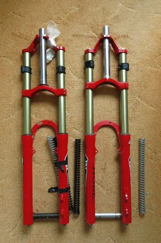

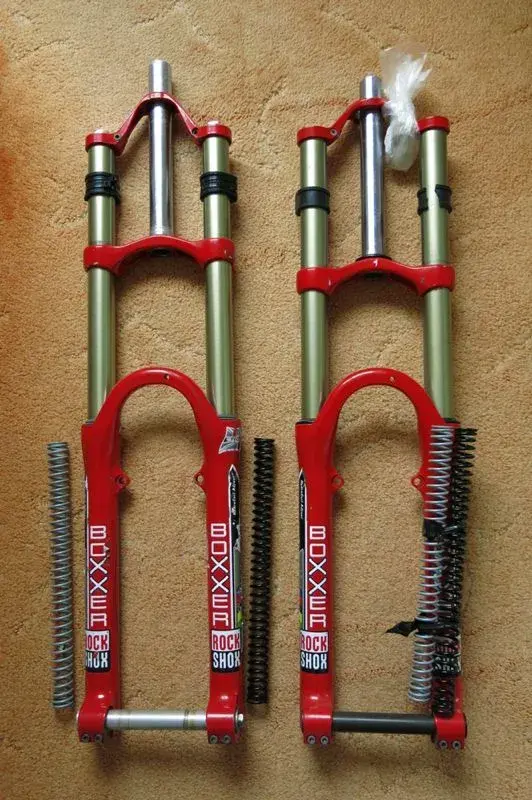

Just curious if anyone can help me out, I bought these 2 pairs of 151's ages ago for a build but never fitted them, they came with some extra springs and was wondering if anyone can help me out with what weight they are ?

As I remember it the spring colours have not changed....
I have reds and yellows in the house....
<140 lb (63 kg) Silver
140-160 lb (63-72 kg) Yellow
160-180 lb (72-81 kg) Red (Stock)
180-200 lb (81-90 kg) Blue
>200 (99 kg) Black

Thanks for the info, I swear I saw somewhere that they were slightly different for 98 and 99 boxxers, as standard springs for all these forks come with yellow in them which are mediums Im pretty sure.
