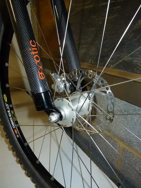

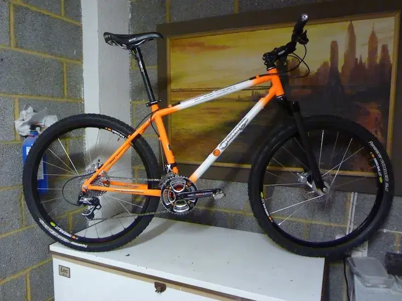

just rebuilt my 2007 clockwork, removed the 100mm travel reba world cup forks (460a-c) as they were dead, replaced them with an Exotic carbon fork (440a-c) feels fine and dandy and looks nice aswel. i'm also about 14 stone, so far from light!
