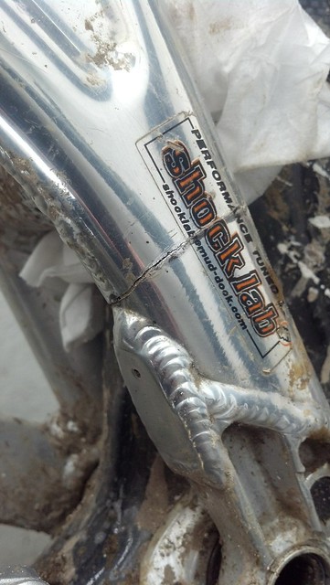

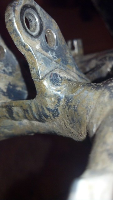

Just discovered a crack in the chainstay of my bike [Edit - now I find that actually part of the anchor point for the rear shock is coming off also! - is that normal? and how would that even happen? A bottomed out shock maybe..] - a lovely Scott Strike G-Zero Team Edition from 2003. I guess superlightweight doesn't mean super reliable does it?!
Anyone know of a good (and reasonably cheap) MBT specialist frame repair place? Also do you think it could be repaired for under £130 ish?
I have found these people who do an interesting looking carbon wrap repair which I am slightly doubtful about - http://www.jaf-bikes.co.uk/jaf-repairs
Interested to see what they quote but I'm not too hopeful on finding a reasonable >£100 price for any repair. Is that wrong? Please say it is!
Chainstay -
And the suspension pivot anchor -

i use a very specialist welding company for my alloy repairs for work (one worked on nuke subs the other builds his own racing bikes ) i can show them the damage to see if they can repair if you want

Yea that would be good - I just found a bigger and much more serious crack in one of the anchor points for the rear shock.
http://farm9.staticflickr.com/8520/8678 ... 158a_c.jpg

I would tend to distrust that swing arm in general, it could be repaired and then fail elsewhere.
Have you contacted Scott to see if there is any chance of a replacement?
Failing that, patience and Ebay may turn up a whole rear assembly.

you don't want to hear this but it looks like the swing arm has pretty much had it; I wouldn't bother with the carbon wrap - you would need quite a few gussets welded on to fix it, plus sam on other side to keep it looking symmetrical and preventative strengthening;
maybe easier to design and build up a new one but probably won't be cost effective - or hope a swingarm can be obtained from Scott or ebay.
